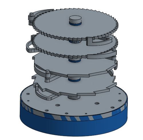

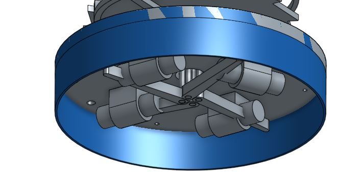

                                  Les Jones 1
                                    @lesjones1
                                    I don't know the design of this clock but I imagine the solenoid will be stepping a ratchet type wheel one step at a time. Some alternatives are a model servo motor. The position of these is controlled by a pulse betwee 1.5 and 2.5 mS (From memory) at a PRF of about 50 hz. You could just cange the pulse width for a short time to make it move out and back to step the ratchet one position. You could use a small geared motor with a cam on it with one notch cut out. A micro switch would engage against the cam so its contacts were open at the notch position. The contacts would be in series with the motor. A relay or transistor in parallel with these contacts could be pulsed for just longer than the time required for the motor to move enough for the micro switch to close. The motor would then continue for a full rotation and stop at the notch. A crank on the motor could be arranged to step the ratchet wheel one position. A variation on this is to have a number of notches (say 6 , 10, 12, 24) so the wheel would move one position for each pulse. An optical sensor could be used in place of the micro switch.
                                    Les.
                                    #337648
                                    James A
                                      @jamesalford67616
                                      Good morning.
                                      Thank you for the continued and additional suggestions.
                                      Les: I did consider motors, cams and micro-switches initially and they are still a possibility for some elements of the finished design.
                                      Neil and Ian: thank you for the information about solenoids and relays. I studied electromechanics at college for a few years when I was training to be a telephone exchange engineer, but it is scary just how little I can truly recall. Your posts have been fruitful refreshers.
                                      Dave: I agree with you in that it is likely to be easier to refine the control of the device mechanically than with programming and I shall focus on that approach.
                                      As mentioned, I do wish to complete my other main project before embarking on this at all, but below are some drawings of my ideas so far. It is quite small, the wheels being four inches in diameter: much more would exceed the capacity of my lathe. The base will house most of the solenoids, the Uno, circuitry and some batteries. The actuating arms pushing the wheels around will have a hinge and spring in them so that they can slide over the teeth when retracting for the next impulse. I am still trying to decide how best to display the time, but I am leaning towards a vertical, numbered ring on top of each wheel and a pointer; the time will be read vertically by reading off from the marker. I envisage a day of the week and a night time or day time display on the top. The whole thing, other than the base, will be placed within a clear tubular case.
                                      Still, plenty of time to settle on a design that interests me enough to actually spend the time building it. I have designed two other clocks, but neither really engaged me anywhere as much as this has.
                                      Regards,
                                      James.
                                      Edited By James Alford on 21/01/2018 09:55:09
                                      Edited By James Alford on 21/01/2018 09:55:50
