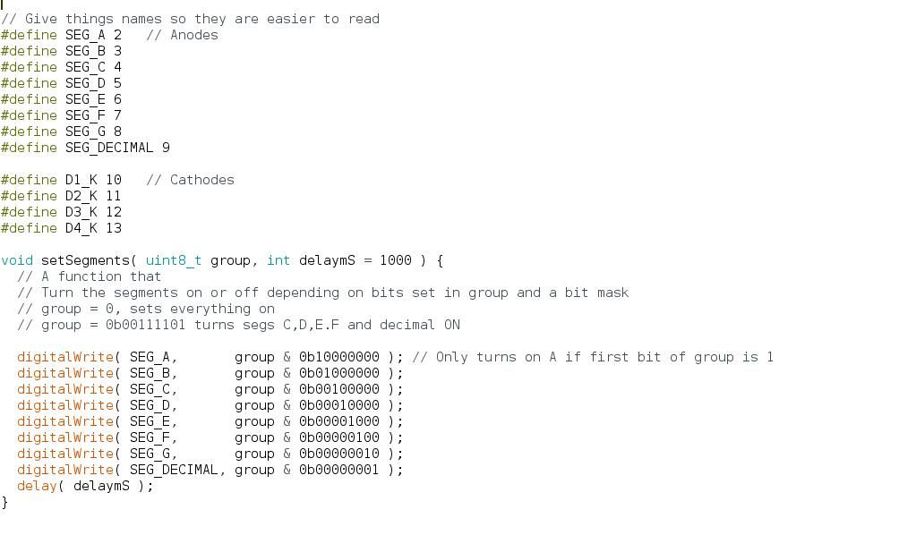

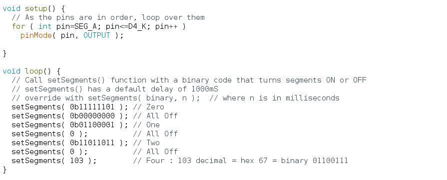

                Congratulations to Malc:
                • For getting his program to drive the LEDs correctly (a major milestone!)
                • For writing code that's easy to understand. (Rule 1 of programming: Don't leave the reader in the dust!)
                • For recognising 200 lines can probably be compressed and asking advice
                I've not tested my version on a real LED so the code is probably buggy, but as an example of a couple of reducing techniques I offer this.
                First trick is to use names rather than numbers in hope the code will be easy to understand in two weeks time, or if some other poor S.O.D. has to debug it.
                Second, use a loop. In this example a for loop in setup() sets all the output pins one after the other. The pin numbers happen to be in sequence making a loop easy to apply in this example, but variations of the the same technique can handle non-contiguous pin numbers (Slightly more advanced topic.)
                Third, put repeat operations into generalised functions. In this example, setSegments() turns all the LED segments on or off in any combination based on the coded number it's given, and then executes a delay() My example takes advantage of a 7 segment + dp display having 8 control states, which can all be contained in a single integer of type uint8_t (ie an unsigned 8 bit integer.) Also available if more bits are needed: uint16_t, uint32_t and uint64_t)
                The encoded command can be written in binary
                ABCDEFG.
                00000000 // All off
                11111111 // All on
                11111010 // All on apart from segment E and the decimal point
                So a bit set to zero, means 'turn the corresponding segment OFF' and the same bit set to 1 turns it on, (In the Arduino documentation, its explained LOW = 0 and HIGH = 1.) The bits are extracted, or decoded, from group by masking them with a logical and ( & ) , obeying this rule:
                0 & 0 = 0
                0 & 1 = 0
                1 & 0 = 0
                1 & 1 = 1
                So SEG_A & 0b1000000 = 1, ie HIGH while SEG_A & 0b01111111 = 0, ie LOW
                Fourth trick is to overload (technical term) the setSegment() function with a default delay. If 1000mS is wrong, the programmer can override it. So
                setSegment( 0xff, 10000 ); // turn all segments and DP ON and wait for 10 seconds
                Hope that makes some sense!

                  #510097
                  duncan webster 1
                    @duncanwebster1
                    from the time on this posting you can tell it might be insomniac ramblings:
                    A somewhat more understandable way of doing what SOD suggests would be to define a set of one dimensional arrays
                    //int Ch_n[] = {a, b, c, d, e, f, g, dp}
                    int Ch_0[] = {1, 1, 1, 1, 1, 1, 0, 0};
                    int CH_1[] = {0, 1, 1, 0, 0, 0, 0, 0};
                    and so on to
                    int CH_dp[] = {0, 0, 0, 0, 0, 0, 0, 1};
                    int Ch_clear[] = {0, 0, 0, 0, 0 , 0, 0, 0}
                    and then
                    void setSegments(int Ch_n)
                    digitalWrite(seg_A, Ch_n[0];
                    digitalWrite(seg_B, Ch_n[1];
                    and so on to
                    digitalWrite(seg_dp, Ch_n[7];
                    and then in loop() call
                    setSegments(Ch_0);
                    or whichever you want to send
                    don't forget you can also display A, b, C, d, E, F, H, J, L, S (same as 5), Y
                    No doubt SOD will put this right if I've erred.
                    Edited By duncan webster on 27/11/2020 03:51:40
                    Edited By duncan webster on 27/11/2020 03:52:33
                    Edited By duncan webster on 27/11/2020 03:55:12
                    Edited By duncan webster on 27/11/2020 03:55:46
                    Edited By duncan webster on 27/11/2020 03:56:13

                                      Anyway, in defence of my terse example above, I thought I should test it. Found a 7 segment display and breadboarded it with a Nano. Of course it didn't work! However the mistake was my 7-segment display happens to be a common anode type rather than the common cathode display used by Malc. Common cathode LEDS are earthed and lit up by putting positive volts on the segments. Common anode are the other way round, ie the Common Anode is made positive and the segments are pulled down to earth to light them. The displays are inverts of each other. Oh dear.
                                      Rather than needing a major re-write, my code is fixed by adding a single statement.
                                      void setSegments( uint8_t group, int delaymS = 1000 ) {
                                      // A function that
                                      // Turn the segments on or off depending on bits set in group and a bit mask
                                      // group = 0, sets everything on
                                      // group = 0b00111101 turns segs C,D,E.F and decimal ON
                                      group =~ group; // Inverts group for common Anode
                                      digitalWrite( SEG_A, group & 0b10000000 ); // Only turns on A if first bit of group is 1
                                      digitalWrite( SEG_B, group & 0b01000000 );
                                      digitalWrite( SEG_C, group & 0b00100000 );
                                      The tilde is the 'bitwise NOT operator'. It flips binary bits so 1010 becomes 0101 and vice versa. I claim brownie points for an example than does LEDs with either positive or negative logic.
                                      Apologies to Malc, we should be keeping his thread simple!
