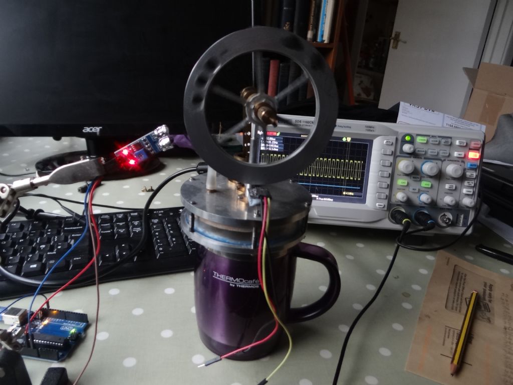

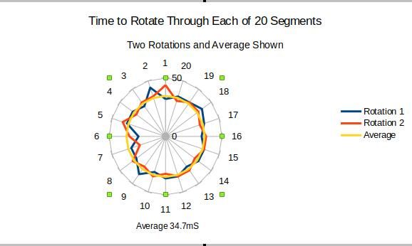

                        Going back to Tim's original question about lumpy output disturbing the average twist, and my proposition that the flywheel smooths things out, I now think we're both right.
                        Having got the engine to run (needed a clean and a few drops of fresh oil), I felt-tipped 18° timing marks on the engine's flywheel and wired up a infrared sensor module to detect them. The sensor was connected to an oscilloscope. (The Arduino in the picture is only used to power the IR Module, not to take measurements.)
                        The results from two rotations look like this:
                        You can see that the flywheel keeps the speed fairly close to average for most of the time but that there are two 'bumps' at about 9 and 12 o'clock. As the bumps are 90° apart, my guess is that they are due to the piston at peak power output and the displacer absorbing power when it reverses direction. Don't bet the farm on it though.
                        So the accuracy of the power output as measured by me in the article does depend on where I put the sensor. If it's position happened to correspond to the bumpy bits of the cycle, then the measurements I took will be slightly too high or slightly too low. On the other hand, if the position happened to align with the smooth part (a 75% chance), then the measurement should be close to Tim's 'average twist'.
                        I think I've learned some more!
