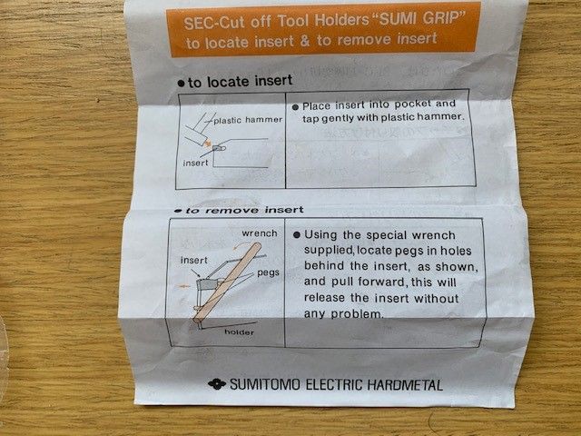

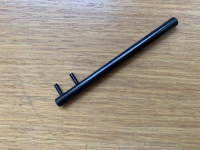

                        Emgee,
                        This is what the Sumitomo insert removal tool looks like:

                          Ketan, just checked the make of my parting blade and it's 19mm made by Glanze, there are no holes and the Sumitomo tool looks like a good choice to remove the inserts.
                          Emgee

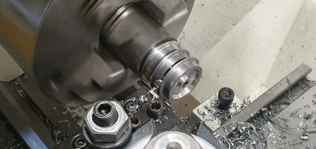

                                    Despite my concerns about the additional overhang when used with my son's size 100 tool post, I ordered a GTN2 parting blade and block from Arc yesterday and was surprised when it arrived this morning. The lathe isn't very powerful for its size (1hp and no backgear), so parting off at 3 times the speed that I used with HSS has made things much easier. I had a lot of vibration at first, but this went away once I increased the feed rate.
                                    I'm suitably impressed but probably getting over-confident now, as I plucked up the courage to let it keep feeding under power whilst taking a photo (16mm scale wheels from 1 1/4" bar).
