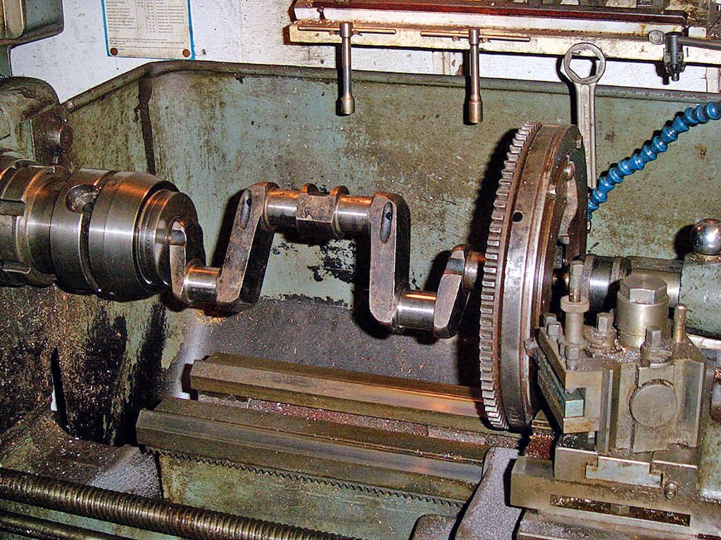

                                                    I lightened the flywheel on my Austin Seven Special many years ago, I used a spare crankshaft to set it up in the Harrison lathe and remove a few pounds of excess weight, it certainly helped with slicker gear changes and blipping the throttle when double de-clutching etc.

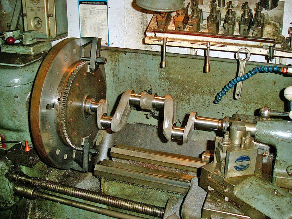

                                                    I also fitted a newly manufactured Phoenix Engineering crankshaft, this shows it set up in the lathe for hand lapping the taper between it and the flywheel.
                                                    I had already previously experienced a loose fly wheel prior to that, and did not want to repeat that again.

                                                      That really does look like a crank that would have a severe rigidity problem if any tuning was applied to that engine. I am not surprised that lotus 7s use all sorts of different engines.smiley
