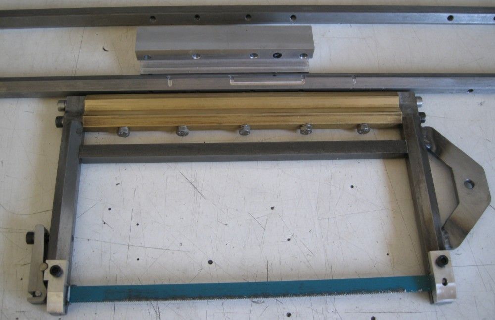

        Joseph Noci 1
          @josephnoci1
          At the risk of boring this forum with even more of the same of my photo's…
          I built my own version of a power hacksaw, so cannot say if the plans you have are good, but it seems there are quite a few builders out there who are happy with it.
          My version also uses Hex bar for the gantry and slide – I did beef up the size of the bar and the blade holder/slide has been strengthened so it does not flex to much when applying blade tension. Also made a hydraulic damper, etc…
          Not sure how to give a link to my posts on this as I cannot direct the link to my post exactly..but here goes –
          **LINK**
          If that does not work – a photo or three..
          Joe.

          #428769
          IRT
            @irt
            It looks good!
            Are you please with the accuracy of it?
            I am expecting to take far more than 2 weeks with my build.

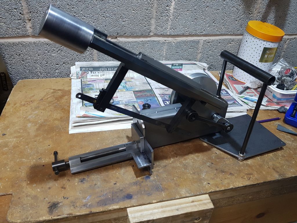

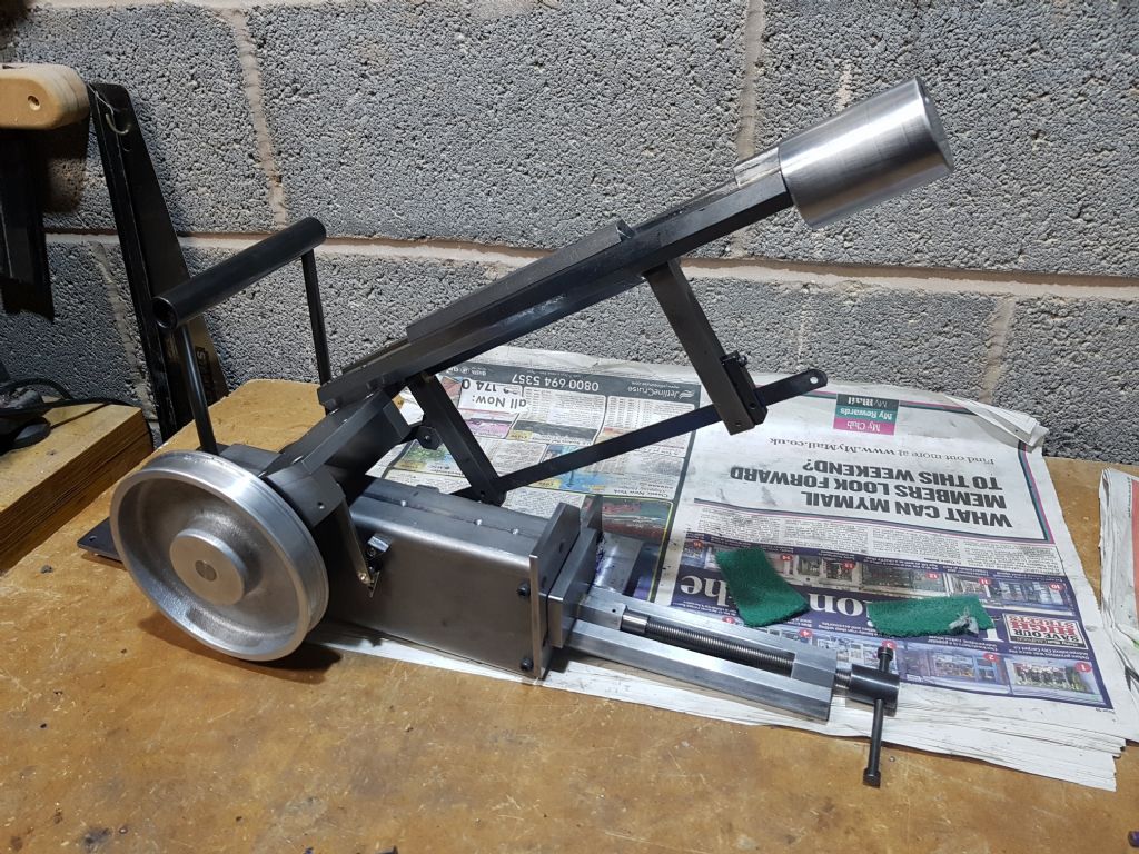

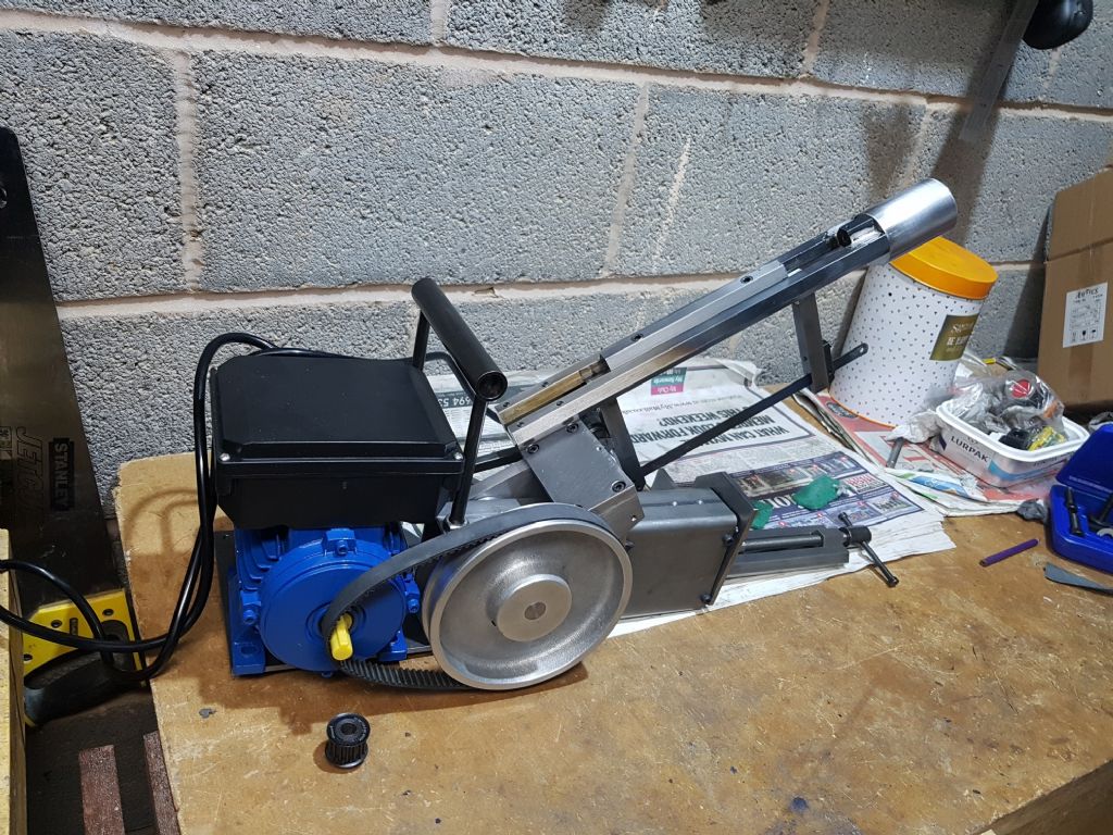

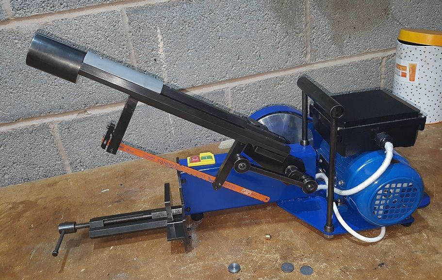

                    #474642
                    IRT
                      @irt
                      I did say more than 2 weeks didn't I?
                      After 7 months I have assembles the parts made so far.
                      It is starting to look a bit like a hacksaw now.
                      The motor and vice are not attached yet – just placed in position for the picture.
                      Edited By IRT on 24/05/2020 22:17:54

                        #474680
                        Joseph Noci 1
                          @josephnoci1
                          Looking Good IRT!
                          Do you have a VFD/3phase motor setup on the saw? If not, maybe the stroke/min may be a bit high with those pulleys? A (very) rough guess looks like about 8:1 ratio – If the motor is around 1400rpm, then 170 or so stroke/min is rather high. Even a 10:1 is still to high. Try for around 60s/min up to maybe 100s/min.
                          Joe

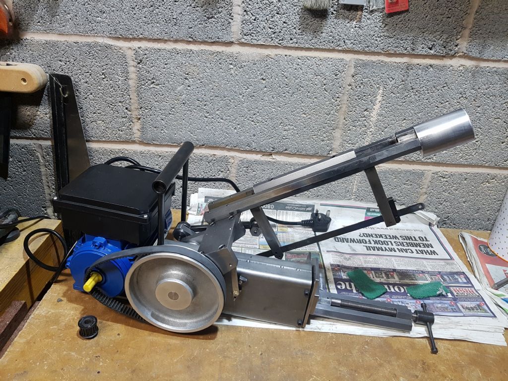

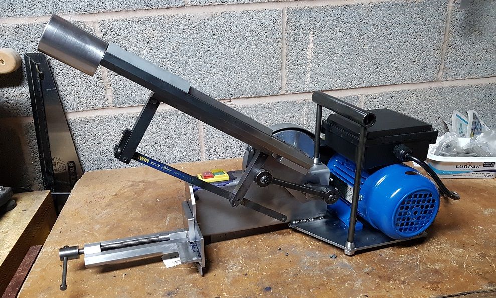

                            #482606

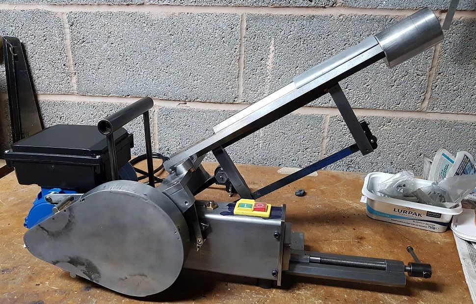

                            IRT
                              @irt
                              I finally finished the build today.
                              Now I just have to make it pretty.
                              It runs lovely and smoothly.
                              I will wait until the final assembly before making a cut with it at this will put a slot in the plate at the front.
                              #482630
                              not done it yet
                                @notdoneityet
                                Looks like a job well done. Neat and fairly compact. Very much worth waiting for. I’m sure it will serve you well (and avoid ‘tennis elbow’ in old age! Less than a year for a project like this is perfectly acceptable for me.
                                The only downside (IMO), from videos I have seen, is that they seem to run at a rather frenetic rate – 240 strokes per minute.
                                The ETW design operated at just 90 strokes per minute. It uses a geared reduction drive, so no belt.
                                The toothed drive pulley perhaps slows it a bit? What is the motor size you have used? It looks BIG!
                                #482644
                                Joseph Noci 1
                                  @josephnoci1
                                  Posted by IRT on 27/06/2020 23:19:19:
                                  That looks very nice! Very compact and certainly a lot lighter than mine! Please post a link to a video of it doing its thing..
                                  Well done.
                                  Joe
                                  edit : won't that rearward protruding part of the blade smack the motor? Maybe you just have not cut it short yet..
                                  Edited By Joseph Noci 1 on 28/06/2020 09:48:32

                                    #482671
                                    IRT
                                      @irt
                                      The motor is smaller than the original used. The plans describe using a 1/3hp motor, but state a smaller one would provide plenty of power.
                                      This one is 1/4hp, 1400rpm. with the gearing about 6.25:1 this does indeed have a theoretical speed of about 220rpm.
                                      Surprisingly, it does not appear scary fast – at least when only cutting fresh air.
                                      I have not worked out what cutting speed this equates to.
                                      Clearance is not an issue. It is a way off the motor. It does get close to the crank – but again nothing to worry about.
                                      9 months elapsed time so far. I did have a break of a couple of months when the garage was too cold.
                                      It is my first 'proper' project, involving milling, turning, silver soldering, casting, welding, etc. I have learnt a lot.
                                      I will put a video up once it is finished, but I need some better weather before I can paint it.

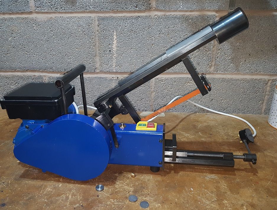

                                            IRT
                                              @irt
                                              So much for making it pretty.
                                              I know as soon as I pick up a paint brush or aerosol things are going to go downhill. This morning was no exception.
                                              I have runs, bubbles, and insufficient coverage in the space of a few inches.
                                              The damage has been limited as I have run out of paint.
                                              I suppose trying to spray outside in a breeze is asking for problems.
                                              So now I have to decide: do I rub it all down only to make the same mistakes and use up expensive paint, or do I accept that it is only a tool that is going to get bashed about so cut my losses and leave it?
                                              I have a small compressor – maybe I could get a cheap air gun and try that – or maybe try applying it with a brush (that always goes badly wrong).
                                              I will let it dry for a couple of days before I make up my mind.

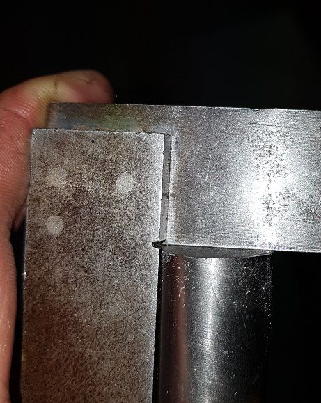

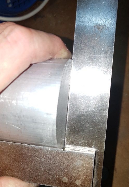

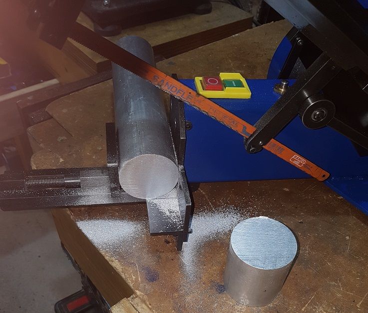

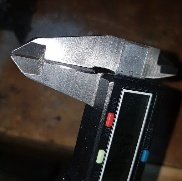

                                              #489512
                                              IRT
                                                @irt
                                                We finally had some decent weather last weekend so I could rub off the worst of the paint and try again. A bit better this time.
                                                The saw is finally finished:
                                                It cuts square and true:
                                                The display can't be seen in the last picture, but I posted it to show it cuts parallel. I think it was about 0.5mm with no special attempt to cut really thin.
                                                As for the spreed of cut – it took 2 minutes and 15 seconds to go through a 20 mm round bar on EN3. Probably quicker than I could do it be hand.
                                                I put a video up on YouTube to show it running:
                                                **LINK**
                                                It sounds much louder in the video than it really is.
                                                #489540
                                                IRT
                                                  @irt
                                                  I then tried some 2 1/4" aluminium.
                                                  This took 17 minutes to get through. I appreciate it is much slower than a bandsaw, but it is much quicker than me – I have been thinking about cutting a bit off for weeks and have got nowhere.
                                                  I need to look up the duty cycle of the motor. It reached 60 deg C and it is baking hot in the garage today.
                                                  The cut is not quite square, but again far better than I could do by hand.
