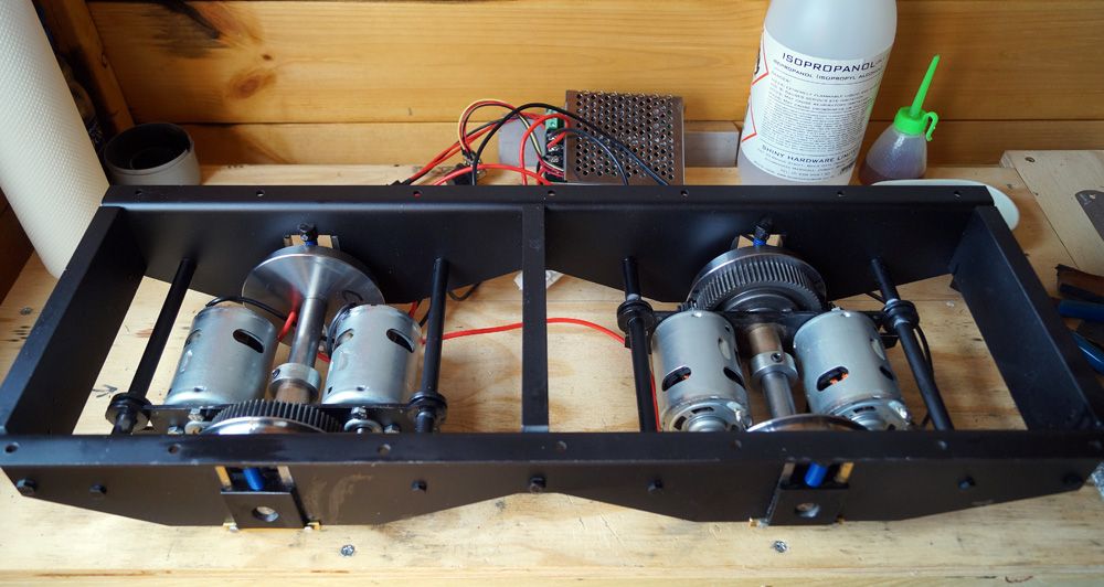

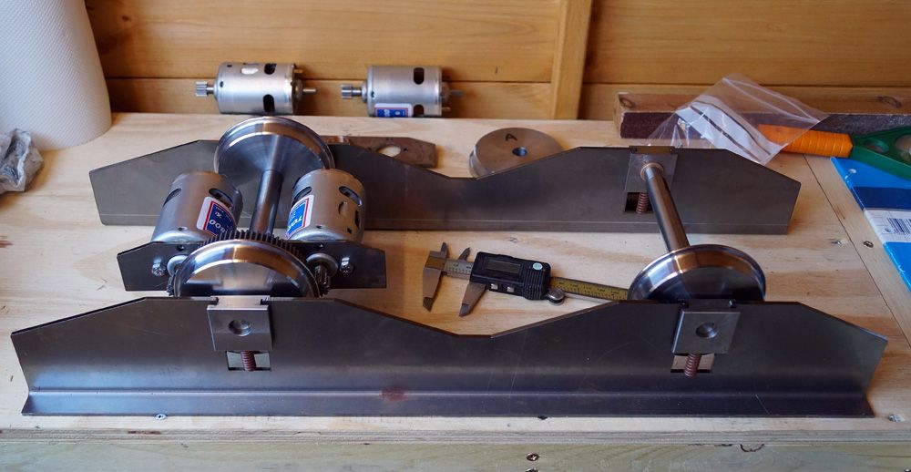

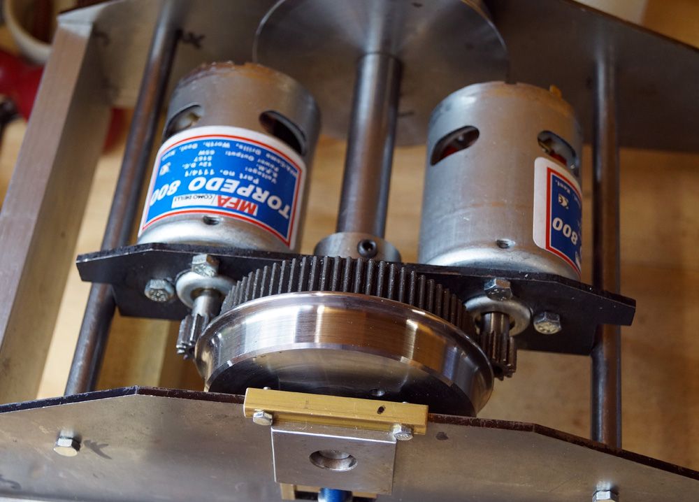

                  Good to see another modeller going electric, there are a number of ways to build an electric chassis from very simple to quite involved, I,ve never looked for any plans so dont know what (if any) are available. I,m sure though you could quite easily design your own and as a first attempt it need not be complicated. Thats how I started with the 0-4-0 shunter, I thought most of it up as I went along and fortunately it worked.
                  The one thing I would suggest before you make a start is to consider what type of running you want to achieve, is it just pulling yourself and a couple of passengers or carrying more people on a couple of carriages for instance. This dictates how much power you will need and the physical size of the motor/motors and their fit into the chassis. Some may disagree but dont underestimate the power you will need. With the 0-4-0 I was told that 150 watts was plenty for me and two passengers and it probably would have worked but my gut feeling told me that it would have been at the bottom end. The 4 motors I went with totalled 260 watts and the loco will pull 5 adults (4 comfortably) with no issues in starting off, you can always throttle back of course but to be shy on power after spending all the time building the loco would be disappointing.
                  Some pictures below on how I went about designing the chassis but as I mentioned there are lots of ways of doing it this was just mine.
                  If I can help any further Thomas just ask but I am no expert by any means.

                    Thanks for the encouragement, Ron. And for the pictures.
                    It's interesting to see that you mounted the axle boxes directly in the frames!
                    What kind of bearings do you use?
                    I would like to have the wheels on the outside of the frame, and coupling rods. Would probably go for roller chains from the motor(s) to the axles.
                    With having coupling rods, I would only need chain to one axle (either one or two motors).
                    One question: If I build a 0-6-0, do I have to think about the middle axle binding if tight rail radius??
                    Our track will have no less than 10m radius at the smallest.

                      The axles boxes directly mounted in the frames was just for simplicity and the axle box bearings are shouldered oilite,s.

                          My axles are for 5" of course but the main axle is 16mm stepped down to 12.5mm for the wheel and then down to 10mm for the axlebox bearing.
