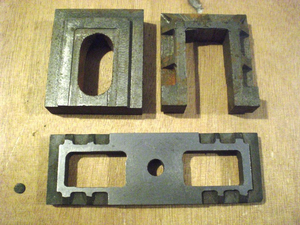

      Just spent a few happy hours marking out and drilling the frames for a "Henley" 0-4-0T in 3.5" gauge. I was very happy to have pilot drilled all of the various frame holes using the DRO on my nice Chinese mini mill. With that done I thought I'd mill out the space for the horns.
      It was all going well and I was feeling quite content until, with characteristic stupidity, I obviously added when I should have subtracted with the result that the rear, driven slot is a beautiful 1" by 1.375" as per the drawing but the leading one is 3mm too wide (I know – metric and imperial).
      Is there a way to fill the gap? The raw casting is only a slightly sloppy fit in the oversized gap so I could get away with JB Weld and a bit of luck plus a few ill spaced rivets.
      Or I could essentially scarf/tenon in a filler piece that would allow the rivets to 'trap' the insert between the frame in a reduced gap. Not impossible but presumably integrity is reduced???
      Or split the casting at the top to allow each side to be rivetted in and then employ a wider axle block to make up the space?? That would marginally shorten the wheelbase but everything else would fit in.
      Will the driving forces from the cylinder just mangle any bodging in short order or is there a fix for this?

          I'm assuming this is one piece hornblocks? Quite a lot of designs have separate horncheeks, Emma Victoria and Sweet Pea come to mind. You could just saw your horns in half and fit them to the overwide slots, or make some out of bar, which gives you the chance to keep the wheelbase the same. If you want drawings of Emma Vic horns send me your email via pm

            I would go along with Duncan's suggestion as being the simplest solution and avoid the wider axlebox idea like the plague. It will interfere with axle centres and possibly umpteen other measurements.

                If it's the slot in the steel frame that is oversize for the casting, which I would guess is probably bronze:
                First establish which side – front or rear of the axle – of the slot is the over-cut one. Or if both equally, which will make the next bit easier by making the error symmetrical about the axle centre.
                Then sweat a brass shim to the horn-cheek side(s) as appropriate. Since it is only a spacer to fill an unintentional gap between two static parts, and takes no tensile or shear lead, soft-solder would be fine.
                #661690
                Nicholas Farr
                  @nicholasfarr14254
                  I would just make a wider pair to fit your slot from a piece of bar from the material of your choice, they don't take that much work to make, and the photo below shows a pair for a five inch gauge loco, and a pair of L.B.S.C.'s Molly type blocks, that I made from good quality cast iron, but bronze shouldn't be much harder to use.
                  Regards Nick.

                      Many thanks for your advice guys. Always a privilege to draw on the learnings of better minds than mine.
                      It looks as though I will attempt to split the blocks as a first attempt and rivet them in as separate cheeks. That is likely to more of a test of skill than the one piece option. Await more questions!
                      Just to be clear I have effectively created a front slot skewed backwards by 3mm. The knock on effect of using a wider bearing with the hole 'centred' is to reduce the wheelbase by 1.5mm. I think the design will take it.
                      Or
                      Fit a wider bearing block but bias the axle hole forwards to where it ought to be. Would such an asymmetrical bearing cause any problems on a small 0-4-0? I think I recall someone on here once describing Henley as effectively a 4 wheeled Rob Roy. 'Proper' wheelbase is 5.75" so losing a 1/16th or so seems preferable to the asymmetric bearing idea but, as ever, I am guessing.
                      Thanks again guys. I didn't want to buy any more metal.

                        No – Do Not try to correct the mistake in a way that alters the wheelbase!
                        That is compounding the error and will lead you into all sorts of troubles.
                        Even a 1/16" is a serious error you'd need compensate for elsewhere: coupling and connecting-rod centres, piston-rod lengths, say. If the driving-axle is in the wrong place then you start putting the valve-gear in the wrong places.
                        However you correct the horn-plates, do keep the axle-centres to design.
                        A pair of asymmetric bearings is not quite Gold Medal winning but as long as the axles are where they should be, the locomotive should still work.
