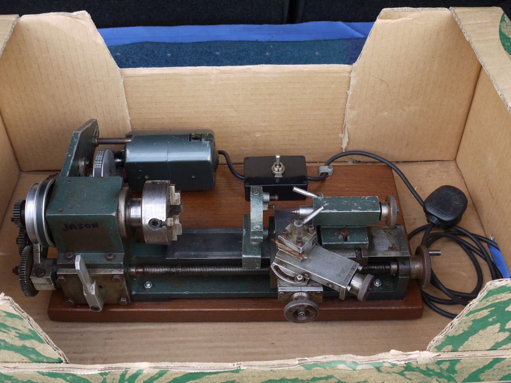

      Hi All, I have recently re started the restoration of a Jason (Pixie) lathe. To be honest it had never been fully built when I bought it many years ago.
      My current question is about a suitable 3 jaw chuck. A very competent model engineer has recently tried to adopt a 65mm dia off the shelf example for me. The thread is different on the Jason, 3/4 x 20 unified. Most small chucks seem to be either M12 or M14. So he had to cut a new thread in the back, and ended up pulling his hair out.
      We seem to have found that the scroll and jaw teeth are not machined to any great accuracy, and the chuck I have is of limited use. 7-12 thou run out. I dare to suggest its a chuck of Chinese origin, although available from a well known supplier.
      Can anyone suggest a suitable 3 jaw chuck that could be adopted. Max 65mm diameter. Or even have a Jason chuck lying around.

          Welcome, Henry
          I too have a Jason lathe … but only the original four-jaw chuck.
          One thing I have noticed is that [on mine, at least] the plain register diameter does not appear to be used … it relies solely on the thread !!
          … This is, of course, contrary to the usual design wisdom; and may be the source of your difficulty.

            Would it be a better option to machine up a backplate and then mount a chuck to teh machined in-situe backplate, something like the 60mm Zither one would do.
            Only downside may be the extra overhang of a backplate and keyed chuck rather than a pin type chuck with integral thread.

                  You can get teh Zither chucks from ARC, said to be good quality, but as you can see as they use a key they are a bit longer than the usual threaded body M14 and M12 offerings that just use two pins to tighten the chuck and there is the backplate thicknes sto add on.
                  A lot will depend on how your modified chuck was held when it was altered, if just gripped by the body then runout could result, I find the best way is to fit a stout bit of bar into the larger lathes chuck and take a skim cut off to true it up, then the small chuck can be tightend onto that and the fixing modified preferably with a screwcut thread rather than a tapped one

                      Posted by Henry Buckeldee on 30/05/2017 17:44:07:
                      … As it happens I have a set of the original drawings for the 4 jaw chuck and other parts of the lathe. The original backplate drawing shows a recess that locates over the shoulder of the nose. The same model engineer produced a nice 4 jaw chuck for me, that locates over the shoulder. He replicated the same feature on the 3 jaw chuck, but is still has the run out show above.
                      dont know Very interesting, Henry …
                      My 4 jaw has a recess, but it's too big to act as a register.
                      I will measure the diameters [tomorrow if possible], for comparison with your drawings.

                        I have just checked the diameters of the register; using a Mitutoyo digital calliper.
                        [which is near enough for demonstrating the point]
                        The spindle register diameter is 0.8120" +/- 0.0005"
                        The plain recess in the chuck backplate is 0.8345" +/- 0.0005"
                        As René Magritte might have put it …
                        "Ceci n'est pas enregistrement"
                        [but of course, my lathe may not be typical]

                          Hi Michael, From the LC Jay & Sons Ltd drawings the dimensions are as follows;
                          Back plate recess 0.8135" max 0.8125" min
                          Spindle shoulder 0.812" max 0.811" min
                          Henry
                          #300530
                            Thanks for that, Henry
                            Looks like my backplate has had a rebore. sad

                                If the spindle has a shoulder, you could try machining a chamfer on the outer edge of the recess in the backplate, and pull the chuck onto the shoulder. Hopefully, this will locate the chuck and improve run out.
                                Having said that, 3 Jaw chucks will give material a run out of 0.005" (or worse if poor, elderly or have been abused)

                                    The pcd of mounting screws is very small. Would I still get the Jason 3/4 thread in on a very small back plate.

                                              If you need to retain the full bore diameter through the lathe spindle, then obviously it would need to screw onto the nose … but otherwise a drawbar "un-split collet" arrangement [as per the illustrations] is preferred, for the sake of precision.
                                              Which reminds me: What taper does your [Pixie] lathe have ? … My Jason has a taper for special collets; but I think there may have been differences between the brands.

                                                Yes my Pixie is designed to take collets. I don't have an effective means to measure the taper. It seems to roughly match the drawings. 30 deg included angle. Entry dia 0.562". Small dia where it meets the counter bore 0.4995 to 0.5005".
