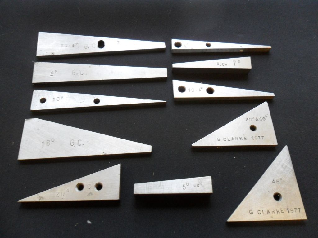

                                                Over the years I have made angle blocks for quick setting & repetion work on the mill ect as KWIL said.    I have never used a Wixey i will look into it ?
                                                Regards Nobby

                                                  Ah, yes, the gent that gave me his sine bar also provided some of those angle plates along with lots of other goodies.
                                                  So it seems I have the basics but as there is an offer on an M & W bevel protractor from Allendale, I might just make a purchase.

                                                    I quite agree that a set of angle plates are much quicker to use, but they can't do odd angles, unless you make one, that is. And they are not a lot of use when setting a tilting vice accurately to a specific angle.
