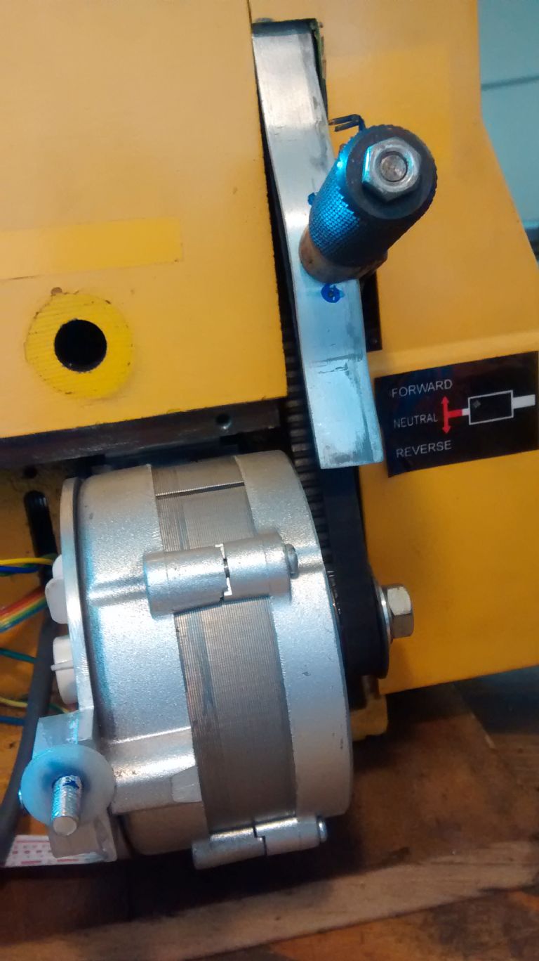

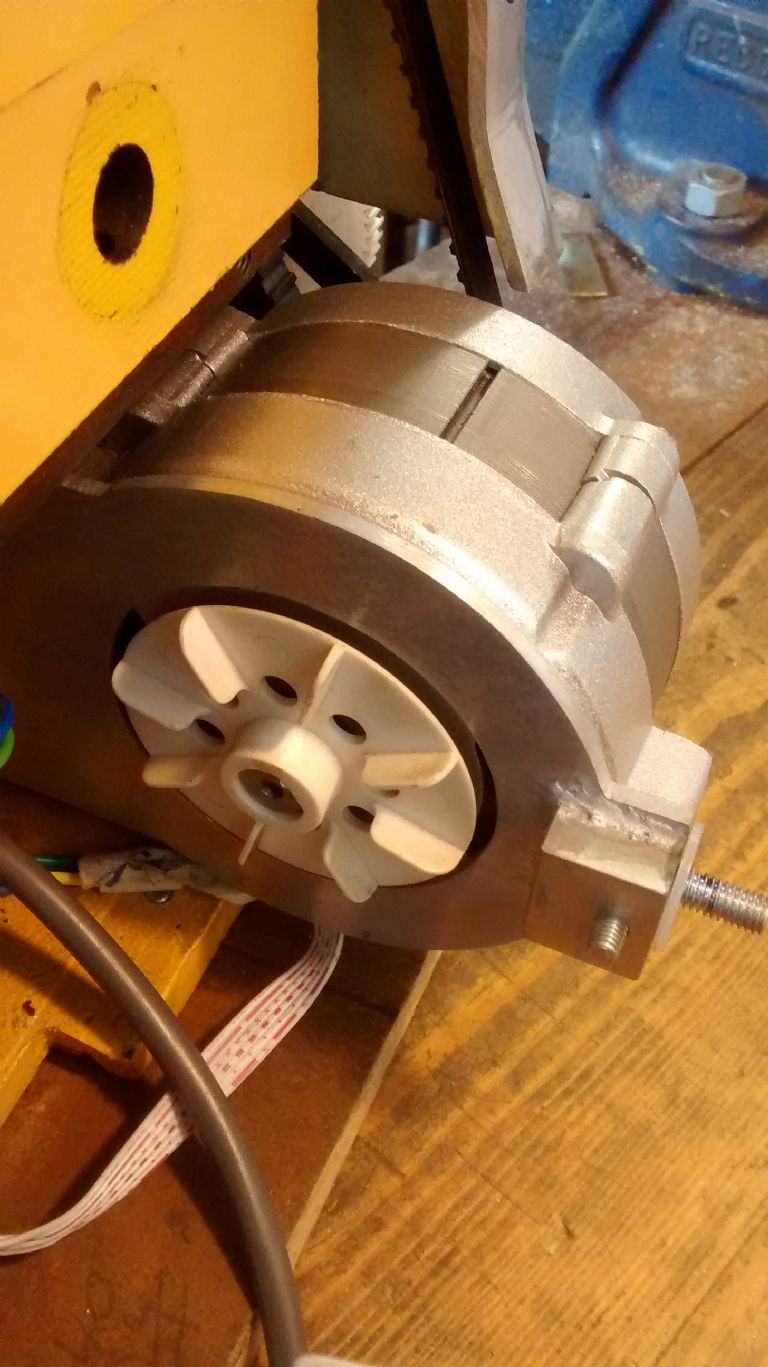

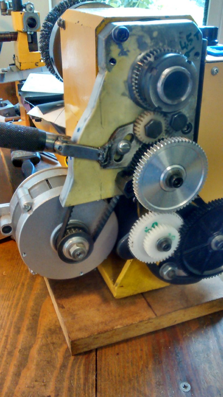

                                                    I fitted my mini-lathe with something similar to this and haven't looked back since. smiley
                                                    Edited By blowlamp on 30/08/2016 15:45:03
