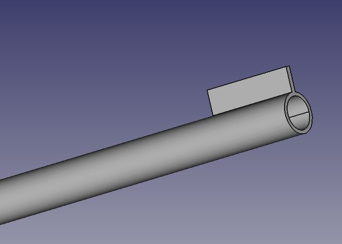

              Well, I didn't expect quite that number of replies. So again many thanks for all answers. All read and greatly appreciated. Perhaps in some areas my description was lacking somewhat as its always difficult when describing things on forums. To try and put some minds at rest, for those still wondering, I will try and provide a more exact explanation for completeness.
              I have a 2 inch diameter 5 meter long Aluminium tube approx 1/4 inch thick – think of Aluminium scaffolding pole
              I need to fasten a piece of aluminium bar to its surface, i.e two the surface of the 2 inch diameter on the 5 meter length. The aluminium bar measures 150mm Long x 40mm high x 8mm wide/thick
              I was referring to bolting through the 2 inch tube into the bar, the interface with the bar is onto the 8mm face of the aluminium bar, so as a few people have pointed out not much meat left in 8 mm thick Aluminium bar after either tapping through or making clearance holes and a nut to secure it via the 8mm face/thickness. Though there is some 40mm height of material. Hence the need perhaps to go to 10mm thickness, or reduce the bolt diameter.or both smaller bolt and 10mm material. Unfortunately, I am unable due to other restraints, to increase the bar thickness above 10mm.
              I hope that clears up any discrepancies. From the kind answers provided I think I will try and tap the aluminium bar with two M5 threads, one close to each end of the ends 135mm apart in the 150mm length to accept stainless bolts with about 18 – 20mm thread engagement in 10mm thick aluminium. All the aluminium is 6082-T6.
              I hope that will be job done. The bar provides an interface bracket for another aluminium tube 30mm diameter, which forms a horizontal joint in a horizontal Truss Beam. ( I know thats as clear as mud now!) Will give it a go and see what happens under some crude testing. Its not a critical truss beam, so no life threatening disaster should it fail.
              Many thanks, and again very much appreciate all the replies

                Posted by Absolute Beginner on 16/08/2018 00:13:56:
                Gary
                I suspect that description's not at all as I originally imagined your problem Gary! A picture is worth a thousand words in these situations if you have the technology.
                Do you mean the plate is attached like this?
                As shown this is a weak construction because the plate can act as a lever and multiply the force applied to the fixings. (Whether this is likely or not depends on the structure it is connected to and to any stresses than might occur during erection – building a structure can badly stress joints before it is complete.)
                Passing bolts through both sides of the tube helps considerably. (This is what I think you describe doing.)
                Two or more bolts in this arrangement much reduce the effect of leverage.  Note that, in this arrangement. leverage doesn't stress the threads. Rather, when sideways leverage is applied, the forces act more on the bolts and the tube, which might snap or deform.
                You said in the original question 'I need to try and create the strongest joint possible.' If it really needs to be strong, I think we need more information. I like to think in terms of 'what will fail first' and this can't be done without a more detailed description. The answers so far cover the strength of threads, which may be good enough if the load on the plate is in the right direction. If the load isn't perpendicular to the thread other failure modes are possible. The direction of the forces applied matters as much as their intensity. A 5 metre scaffold pole is one hell of a lever…

                  If you can machine a 1" radius cut into the long edge of the bar that mates with the 2" diam pole it will give the joint much more rigidity, if you can't do the radius even making a Vee channel will be a benefit.

                            Absolute Beginner
                              @absolutebeginner
                              Hi Dave,
                              What as super drawing. If only I could do that. I can only just about manage a few lines on Autocad.
                              Your drawing is spot on. Spot on. If you imagine a mirror image of the tube and plate approx 500mm apart and a piece of aluminium tube 30mm diameter connecting from plate to plate you have the whole picture. Its a truss like structure and the plates are at approx 500mm intervals along the length of the 5 meter tube and the aluminium tube links are both horizontal and at 45 degrees like you would see on an aerial mast. As essentially that is what I am trying to make.
