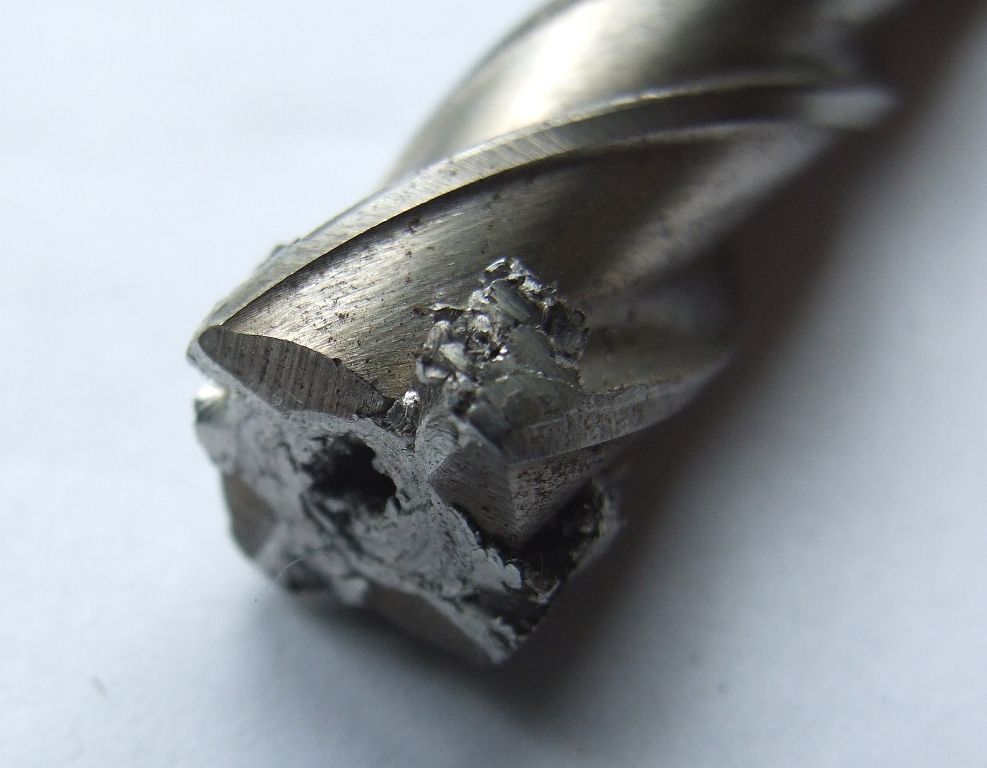

      I have been cutting some slots in aluminium using a 1/4" end mill running at 2800 rpm and hand fed with a depth of 30 thou. The aluminium is sticking to the end mill and closing up the flutes. How do I over come this

                  #598952
                  Anonymous
                    I know the feeling:
                    Can we assume that aluminium means an alloy? Pure aluminium is horrid to machine, bit like warm fudge. Summarising a few pointers:
                    * Use 2 or 3 flute cutters
                    * ideally use flood coolant or an occasional squirt of WD40
                    * If no coolant or WD40 can be used then a finish cut climb milling gives a much better finish
                    * Highly polished carbide cutters are available, specifically for aluminium
                    * Maximise depth of cut and minimise stepover, tends to give long thin swarf that is less likely to clog the flutes – Edit: for slotting one is stuck with full width cutting, flood coolant is the proper answer. Unless the swarf is continuously cleared not only will it tend to clog but will be recut which doesn't do the cutter any good
                    * On aluminium alloys I run fast, several thousand rpm and high feedrates so one gets thicker swarf rather than fine which is more likely to clog the flutes. For example slotting 22mm deep on 6082 with a 3-flute 6mm carbide cutter parameters were 2500rpm, feedrate 400mm/min and stepdown 5.5mm per pass. Of course I was using flood coolant, primarily to clear the swarf rather than provide cooling.

                              I dropped the speed down to 1000 rpm.and it worked fine,
