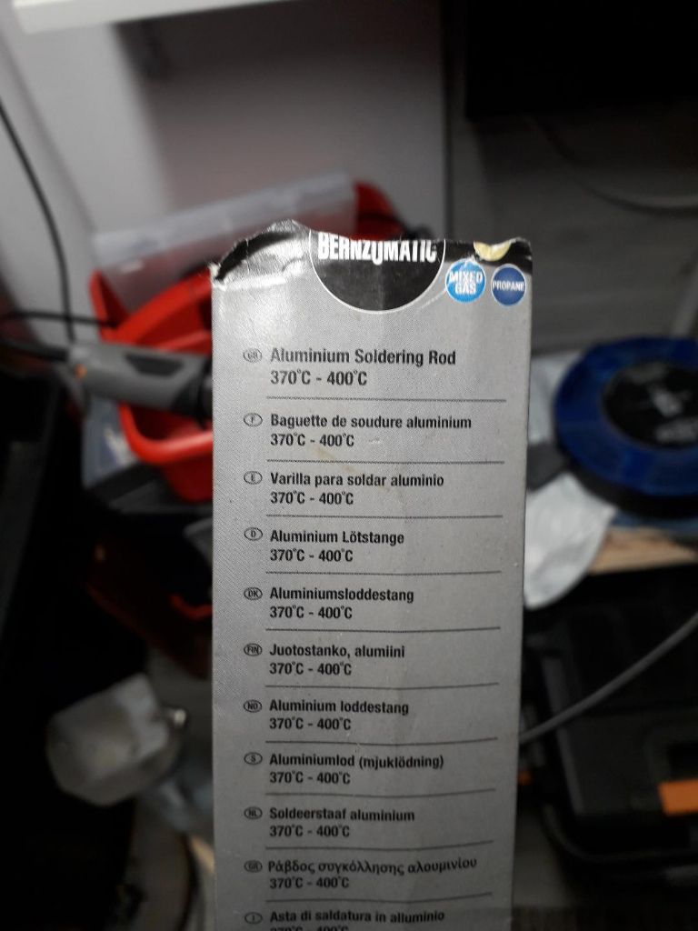

              #607810
              Anonymous
                I use Bernzomatic solder rods 370-400C which work brilliantly on alloy, use propane/butane mix usually, even done the hammer test when I broke up a joint, took a couple of hefty whacks with a lump hammer face 1
                Only problem is seems they might have stopped doing them, I can only find their higher temp welding ones sad, might be some about somewhere.

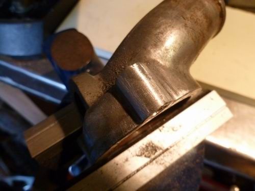

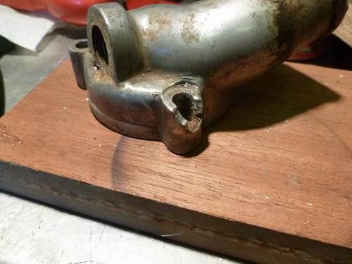

                  Ebenezer Good
                    @ebenezergood76202
                    What's the corrosion resistance like on these solders? I have a couple of outboards that need repairing, could be an alternative to the mig and a roll of aluminium wire??

                      #607837
                      Robin
                        @robin
                        Hi Bezzer, glorious repair, I want to play too laugh
                        I do a lot of tin/lead soldering so I went straight for the 300degC aluminium solder then I went for anything at 400degC that didn't come from China.
                        I am trying to make a rectangular frame from extruded aluminium channel cut at 45 degrees. Nobody else seems to have any problem using this stuff but I think maybe they have teething troubles.
