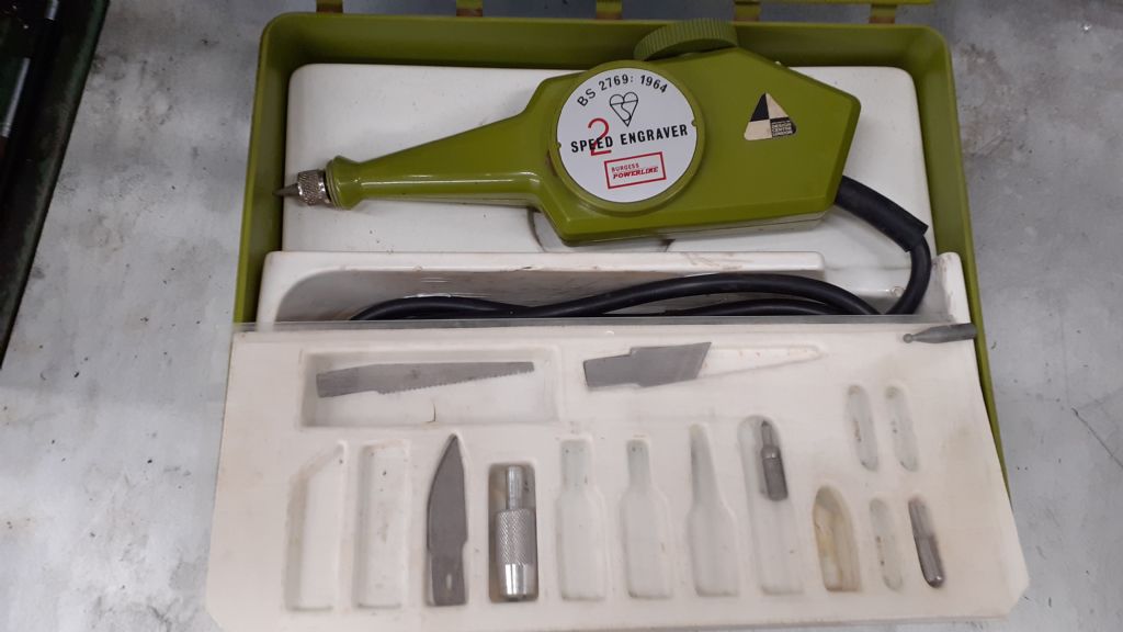

                    Sorry Ega, bit of brain fade on my part though I did used to have their little grinder. It was the green engraving tool that I meant action is axial like a tattoo gun
                    Ramon has one too, you can see what it doe sin the last few images of this post

                        Posted by JasonB on 13/02/2022 12:24:14:
                        Edited By JasonB on 13/02/2022 12:28:00
                        Ah ! … the trusty old Burgess yes
                        Presumably the modern versions, from the likes of Lidl & Aldi, would do the job too.
                        Edited By Michael Gilligan on 13/02/2022 14:43:35
                        #585311
                          yes I did mention a needle gun for big jobs.
                          I don't know why I thought mine was by Wolf, it is indeed a Burgessblush
