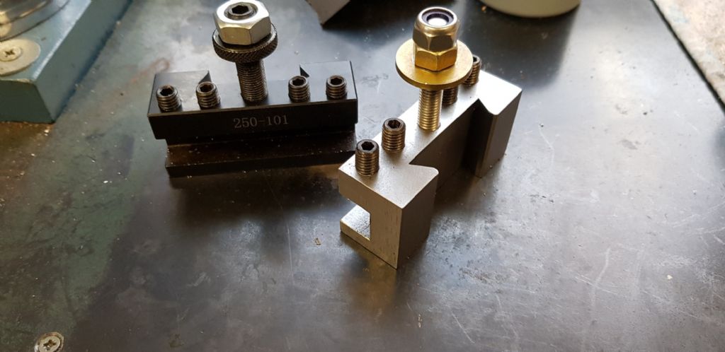

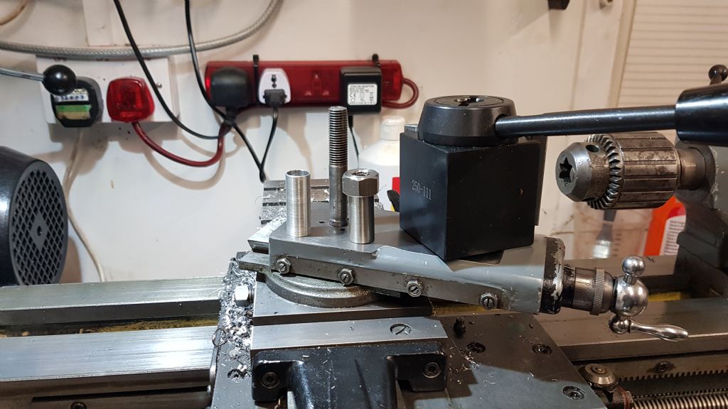

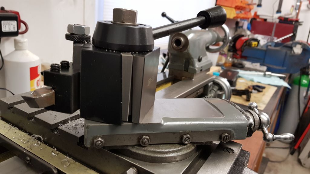

          I fitted one of the Chinese made 250-111 QCTP. It took a few alterations to get the tool height. The reason for the larger than 250-000 was because I already had a lot of HSS cutters that were 13mm square. Note I had to take 3mm from the top of the compound. Also had to take 4mm from bottom of the holders to get the centre height. Glad I did it & the 13mm cutters are very rigid.
          Some pictures.
          Steve.
