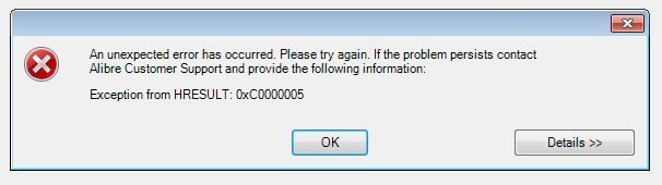

      I have used Alibre Design for many years, don't use it often so not an expert by any means. I have recently installed Linux Mint as I am weary of Windows 10 keep asking me to go online, login, use Skype and running updates when I am doing something else (despite updates being switched off) .
      I have been trying to make Alibre work using Oracle VirtualBox running Windows 7 as a guest. I can get the Alibre GUI to load but as soon as I try to start a 2D sketch I get a long winded error message.
      I wondered if anyone here had managed to get this combination of programs to work or could suggest where I should be tweaking things or perhaps state definitively that I am wasting my time!

                Hi David, thanks for getting back to me.
                Alibre is Design Expert v2018.2 build 19071
                The Windows 7 guest machine has all the updates and service packs, so it is as up to date as Windows 7 will ever get. Guest additions is working and I have tweaked a few settings (not the right ones apparently) Also downloaded the MS DirectX package and installed that so that should all be there.
                First error comes with start page:
                Second error comes when trying to start 2D sketch:

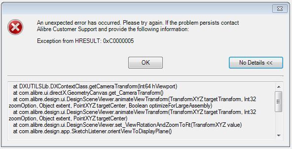

                  Any more information when you click the 'Details' button.

                    Details show thusly:

                      Which confirms the problem is DirectX related.

                            Thank you, yes helped a bit and together with another post I found – I removed Guest Additions and re-installed with experimental 3D support enabled and:-
                            Not quite as smooth to use as in it's native environment but it appears to work. Now to do some more testing with something a bit more complicated and see if it falls over!

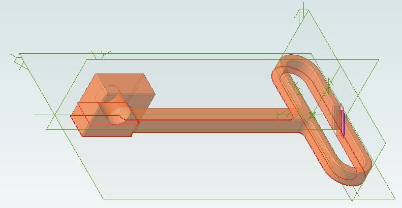

                                                    Well, following Clive's recommendation I gave VMware a try. The installation had me confused until I found a guide on the LinuxMint forum, but once up and running it was quite straightforward. I can report that Alibre runs without any glitches, at least none that I have found yet. The colour rendering that wouldn't work under VirtualBox functioned as normal. I loaded a couple of existing designs and they worked without difficulty.
                                                    I rendered this filament guide for my 3D printer in orange (that's what the real thing looks like in PETG) and it worked smoothly. I don't think the interface is quite as smooth as in it's native Windows but it is certainly useable. I shall call it a success and get on and use it. Worth a go if you normally use Linux and want to try Alibre.
