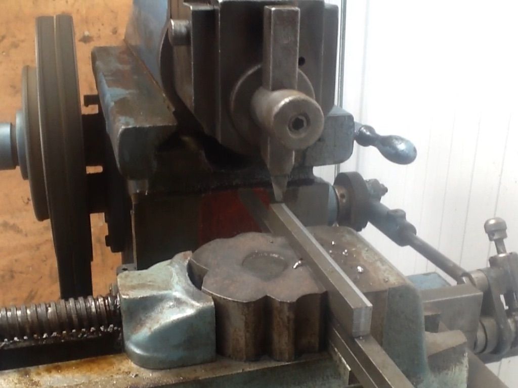

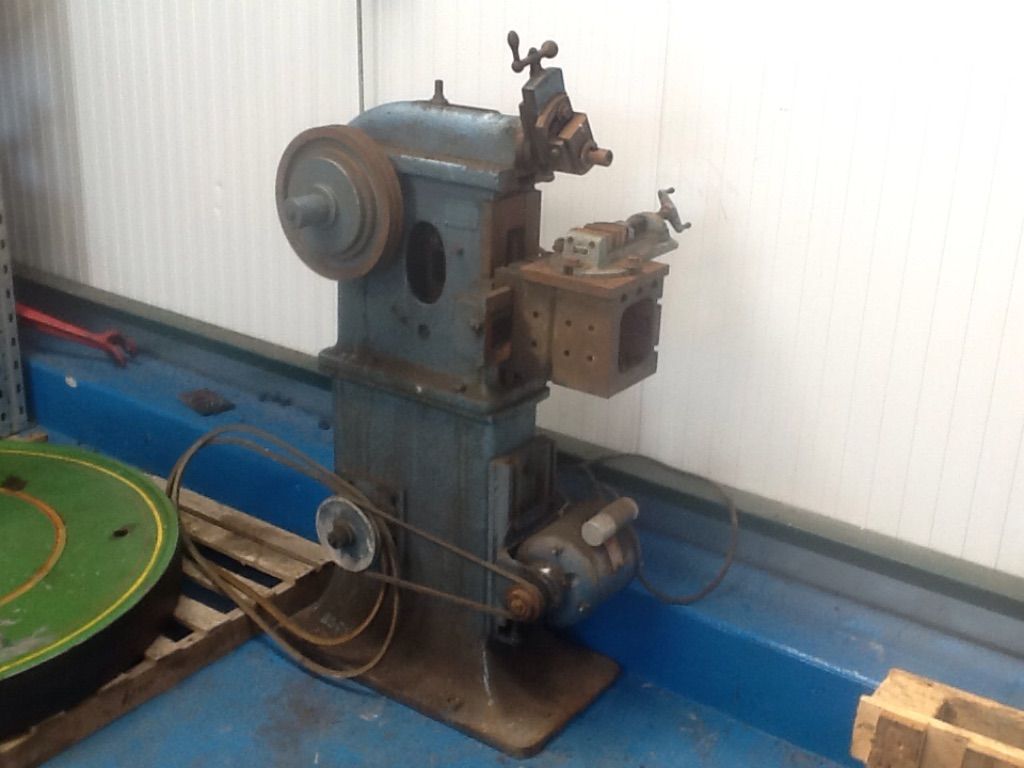

      ..A couple of months ago I was given this Alba shaper, it would have been rude to refuse it.
      The rather dodgy position of the motor and the unguarded drive belts will need altering. The cast iron chip tray that sits between the upper and lower main castings is missing, so a new steel one will be fabricated at some point. For now it has just had stuck parts freed off, some of the surface rust removed and a good oil up.
      image.jpgimage.jpg……………..It is located at my place of work, alongside the Burrell Showmans Engine who's flywheel can be seen in the background.
      After machining a couple of test pieces it was soon put to work machining a new key for the Burrells steering worm wheel. I had never used a shaper before, and found this machine to be a delight to use.
      It has a facility for auto rise and fall of the table, but the single ratchet mechanism has to be swaped over from the cross feed shaft. The factory illustration shows two ratchet mechanisms geared together drawn in, but I have not seen any with two ratchets fitted. So another future job will be to make another drive ratchet assembly and a pair of gears to mesh them together.image.jpg

                My Alba shaper had both horizontal and vertical feeds, I believe the vertical feed was an optional extra. The only thing this model lacked was the table support, which isn't a problem if depth of cut is reasonable.
                #355517
                Lathejack
                  @lathejack
                  Regarding the lack of a table support, I plan to build one in when I get round to fabricating a heavy steel chip tray. It would be handy to know the measurements of the original chip tray fitted to these early type Alba machines.

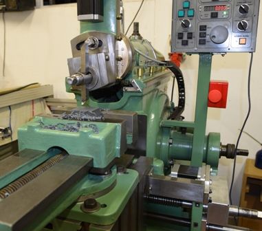

                                    Joseph Noci 1
                                      @josephnoci1
                                      The 1A's slightly bigger sister..
                                      From this:
                                      To This..
                                      Joe
