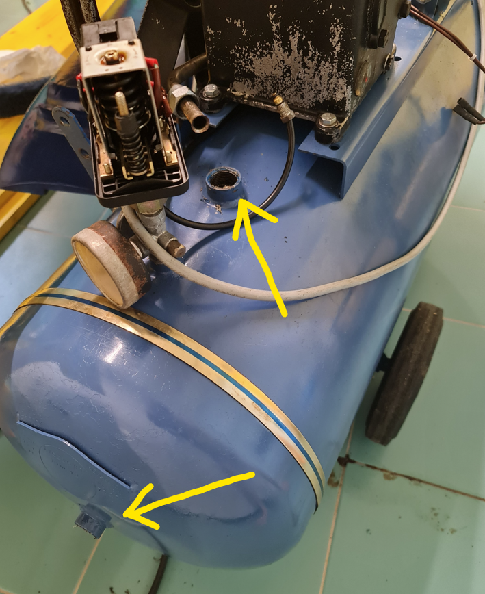

      Since I didn’t have enough parallel projects, I thought of starting another one. Last Sunday I visited a friend who has several compressors and he wanted to sell them. I never really needed one. Except a short sandblasting experience. But one model caught my attention. The compressor itself is fine, but the electric motor is almost dead. It is smoking and can’t rise the pressure above 2 bar. Also it has a dubious makeshift single phase conversion with a capacitor.
      But this is fine, I have a few motors that fits. Including the pulley that is matching the existing belt. It would be a nice repair project. So I bought it without thinking too much. But then I realized that I’m going to share the workshop with a 100-liter bomb. I started to read about the air compressors. An then to watch some videos with some scary explosions. And then I read some more. The main reason for catastrophic tank failure seems to be internal rust. Except some cases where they welded the tank 🙂
      Now the problem with a second hand tank is that you can’t be sure how often was drained the water. And you can’t check if it is rusty or not. Would you use such a tank? I’m thinking to resell it. I don’t think it is worth the risk. What do you think?

                  I opened the drain and a lot of water with oil came out. I had a look inside and it is very dirty. It doesn’t inspire too much confidence. I don’t think it make sense to try a hydraulic test. It seems that for the first time I will bring something to the junk yard, not the other way around.

                        On larry phelan 1 Said:
                        When you opened the drain, how did you manage to look inside the tank ??
                        My tank has at least 5 holes. Just put a flash light on one and watch trough the other. Also the USB endoscopic cameras are dirty cheap these days.

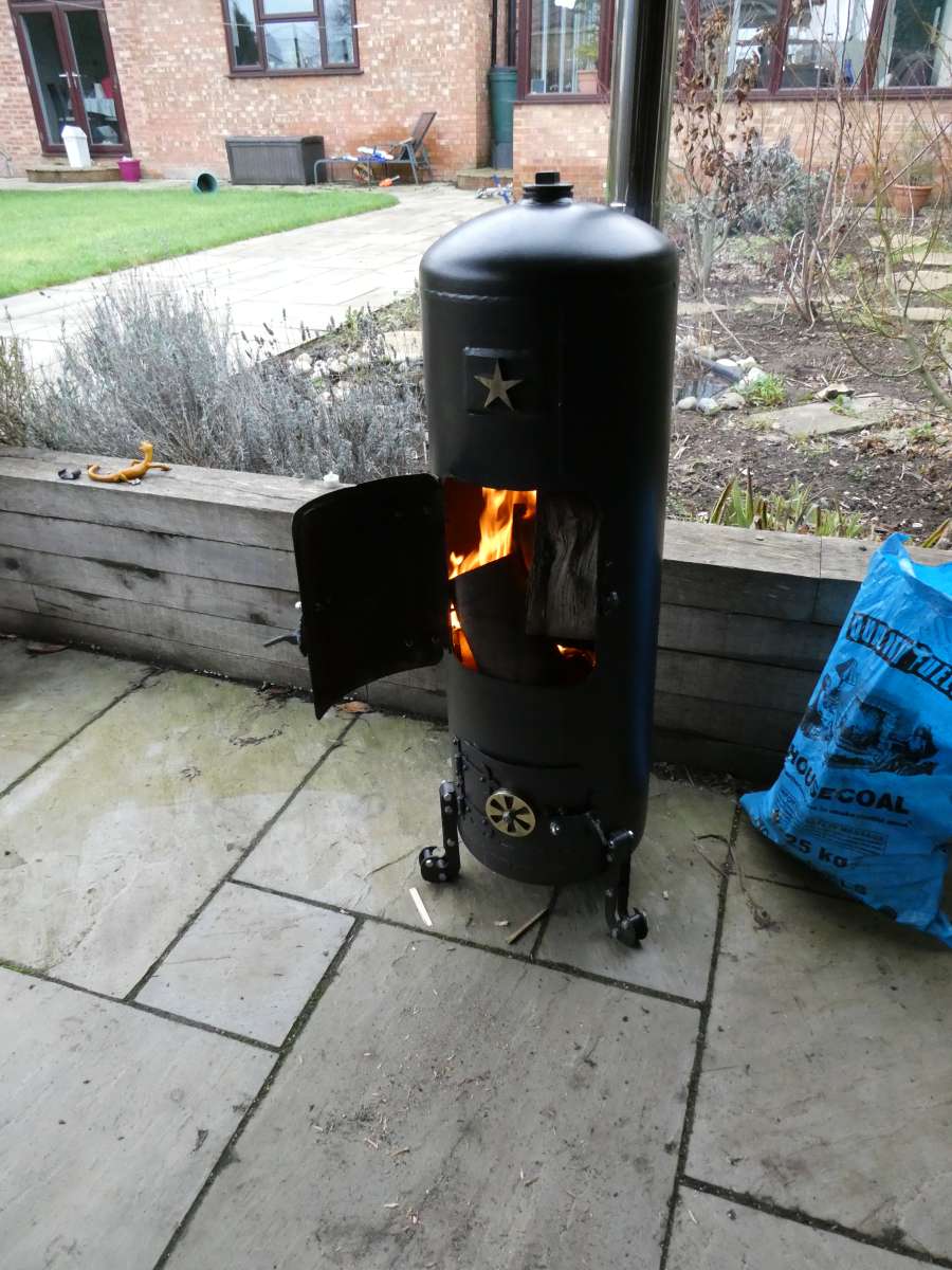

                            Chris Gunn
                              @chrisgunn36534
                              Sonic, you could always try this.
                              ChrisP1010066

                                  Sonic Escape
                                    @sonicescape38234
                                    ChrisP1010066
                                    No, I have a better idea. I could take it to a nearby forest, pour some water inside and then 0.5kg of calcium carbide. Run and ignite everything electrically from 100m away.

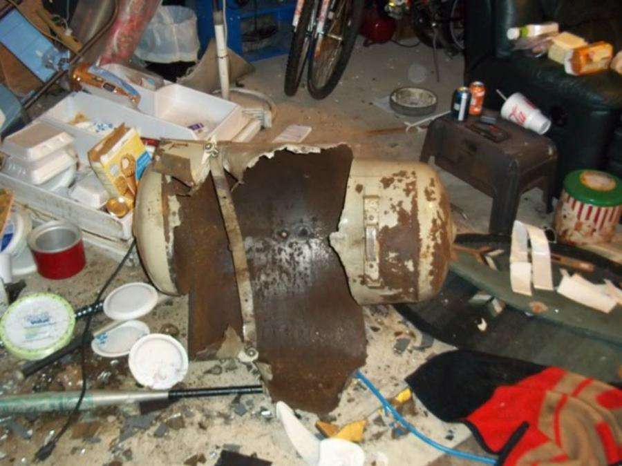

                                      Plenty of examples of air-compressor explosions on the web:
                                      Potberg Maintenance - Blog 20 Nov 2018 A3
                                      As can be seen from the example above, ancient reservoirs are far more likely to fail than new ones.
                                      A common cause is failing to keep the tank dry by blowing off every so often.   A puddle of water left in the bottom creates a rust line running around the tank at surface level.   After ‘n’ years rusting digs a notch into the steel, which flexes every time the tank is pressurised or discharged.   Instead of  distributing pressure uniformly over the whole tank, force concentrates on the notch, gradually levering it open, and encouraging more corrosion, until one day the steel tears open along the notch, concentrating enough force at the ends to rip open good steel.
                                      Dings in the tank are also potential stress-raisers.
                                      Difficult to predict how long a particular tank will last before failing catastrophically, because much depends on maintenance and how often the tank is used – metal fatigue.  In normal use, where the owner replaces the whole compressor as soon as anything major like the motor fails, they are safe.  Very unwise to repair tanks by any means.  The problem arises when Mr Fixer keeps an ancient tank in service for decades by constantly repairing it without checking what the insides are like!    Or by Mr Innocent only using a compressor once in a blue moon and leaving the tank with water inside, giving it plenty of time to corrode a notch.
                                      Safety-with-Air-Compressors-300x223
                                      How dangerous depends on how big the tank is, the pressure when it fails (usually high), being in a confined space, and whether or not the operator is hit by flying objects.   Although a fair amount of energy is released, the pressures are relatively low, so mostly survivable;  loud bang, probably not enough to rupture an ear-drum.   Although fatalities seem fairly rare, I wouldn’t risk using an old compressor.  I see old kit as being “clapped out” rather than “tried and tested” until proven otherwise!

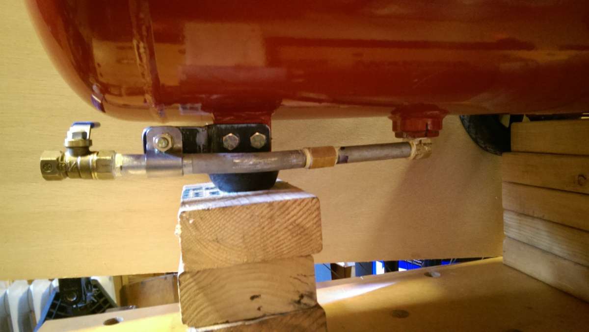

                                            MikeK
                                              @mikek40713
                                              For what it’s worth, I added extended drains to both of my compressors.  It gives the condensation somewhere to go instead of sitting in the tank causing rust, but also makes it easier to regularly drain it.
                                              Mike
                                              IMAG1827

                                              Robert Atkinson 2
                                                @robertatkinson2
                                                250 Bar/litre is the limit for air receiver certification. So for 7 Bar (105 psi) the maximum receiver size considered “safe” based on stored energy is 35 litres.
                                                That receiver looks pretty badly pitted inside. Personally I would not trust it in the workshop.
