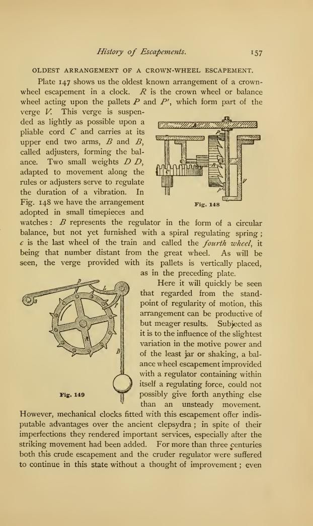

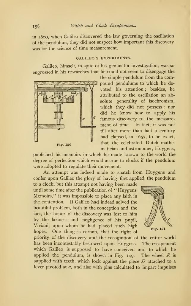

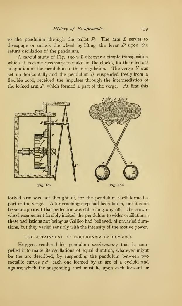

                    The book is "Watch and clock escapements (1904)"
