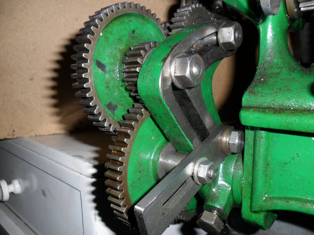

      Hi
      I wanted a slower feed on my drummond lathe so I added a 3rd stud and arm. I tryed work out the feed per rev. ? but with no luck .By hand its about 3&1/2 thou per rev.

          Give us the geartrain numbers and we’ll figure it out for ya nobby.
          eg
          spindle20
          1st 50/20= 20/2.5= 8teeth c/f
          2nd  60/30= 8/2= 4 teeth c/f
          3rd  60t leadscrew for final calc 60/4= 15x8tpi= 120tpi
          1000/120= about 8.5 thou
          a 100 tooth on the leadscrew would crank things right down
          been at ra pub again tonite so e&oe…*hic*

            Is that an extra wee one on the top? a 30/20?
            gives 180tpi= about 5.5 thou
            small problemo though, the leadscrew will go backy wards.

              Hi ady

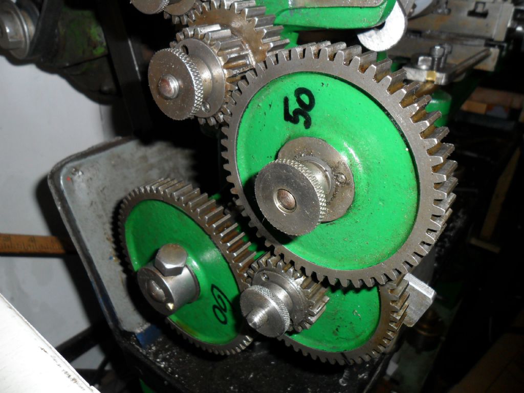

              Thanks mate . I have had a better look this morning On the spindle/ mandrel is a 20
              1st stud 30-20 2nd stud 50-20 3rd stud added 55-20 Leadscrew 60.
              The 8 t.p.i leadscrew rotates forward . Its a bit warmer in the workshop today.

                Do the Drummonds not have a tumbler reverse lever for the leadscrew? If so, that would get round the problem quite easily – what was forwards becomes reverse and vice versa.
                But you are right, the new set up will reverse rotation, so one will have to introduce an idler of any size somewhere in the train.

                  20×0.66= 13.3c/f
                  13.33/2.5= 5.33c/f
                  5.33/2.75= 1.94
                  60/1.94 = 30.93x8tpi= 247.5tpi
                  so a midgies thumb over 4 thou from the looks of it
                  Edited By ady on 17/02/2011 12:34:04

                    It has not got a tumbler gear like my super 7 mk 1 The slot were the belt tension arm is you can fit an idle gear. I willl have another go with the calculater and work out the t.p.i from that I can get the feed per Rev
                    Cheers Nobby

                      Avoid the calculator, and the teethcounting…
                      Set up a clock gauge and turn the chuck 10 revolutions.
                      Take the reading on the clock gauge/ 10 that will give you the Thou/rev
                      Eddie

                        Well 4 thou per rev is a pretty useful general purpose feed for a decent finish, so it looks as that bit of it is sorted.
                        Just the idler gear then. Anywhere in the train Nobby, any size: it doesn’t affect the ratio at all

                          Hi Nobby,
                          The jaws on the headstock (the second photo shows the bottom jaw at the top) are for mounting idlers and tumbler reverse.
                          The Drummond site has plans for one (you will have to register but it is well worth it; tons of info from like-minded people) There are also various plans for fine feed arrangements.
                          The tumbler reverse is worth its weight in gold so well worth making one if you can’t get an original.

                            Thank you all for input on this . I tried eddies idea 4 thou easy . I will get on website as A.B . mentioned . Back to scewcutting this lathe is great as it does not double up when you engage lever similar to the X lathe. Yesterday I cut 20 tpi with no problems. as you may have seen I fitted a 125 Micrometer dail on the leadscrew.
