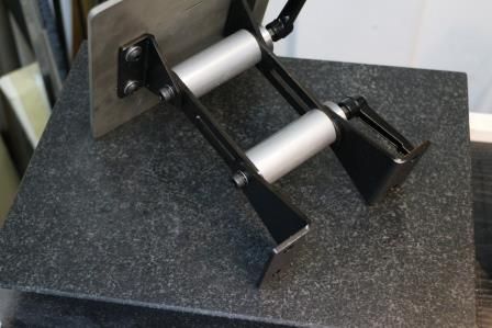

                Here is a picture of the assembled base.
                The table is supplied finished except for cutting out a gap to go around the wheel. The brackets and struts are ready made and drilled with pilot holes that need to be enlarged to clear the bolts. The kit includes 2 lengths of 1 inch ali to make the big spacers – these need to be faced to length and drilled 6mm through. One small problem, the drawings specify that one of the bolt holes in each bracket is slightly smaller than clearance, 5.8 or 5.8 mm, to lock the bolt from rotating. I found this impossible to achieve, so have added lock washers under the bolt heads so that they can be tightened with the handle alone.
                You also need to make the big "washers" that go between the adjustable handles and the struts/brackets – these are 5mm thick and have a radial groove ion one face to locate an O ring that provides a little bit of pressure to assist in smooth adjustment when the handles are slightly loosened. Two laser cut discs of MS are provided for these, but I thought it was easier just to turn and part each one from an MS bar. Once assembled the base is very rigid when locked, but easy to adjust when slightly loosened. Next job – the pantograph that carries the tool holder and clamps to the table. Watch this space…

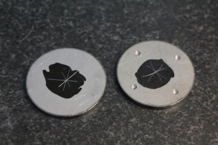

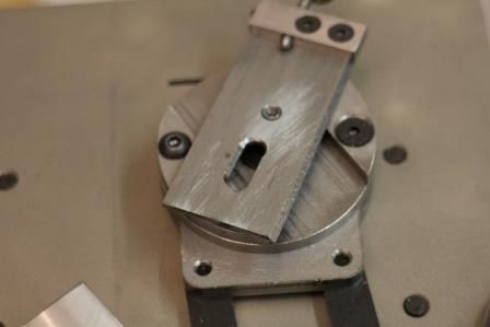

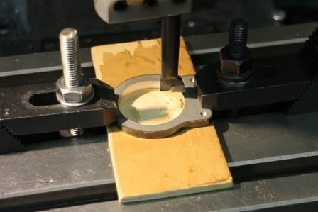

                  This is the clamp block that goes on the top edge of the table. Supplied as a laser cut disc of 8mm steel with hole positions spot drilled. Centre hole is drilled out 5 mm and tapped M6x1. The other two holes are for the shoulder screws that form pivots for two of the parallel links. There is a 4mm step which has to be milled off the surface, parallel to the line of the pivots. I clamped the drilled part down to the mill table and set the shoulder screws square to the table edge using a big combination square – a bit tricky. The only way I could make my VMB reach the part was to use the longest cutter I had, which isn't over sharp so the finish is not wonderful. Now a problem I found was that the table material, nominally 4mm thick, is actually 3.85 so a 4 mm step is too large for the clamp to work. So I had to turn a shade off the top surface to bring the actual step down to 3.75 mm. Best to measure the table first and cut the step to suit. To turn the top and the sides I bolted the item to a short length of steel with a 6 mm hole drilled through, a bit like this…
                  This actually shows the sandwich of the clamp washer that forms the other part of the clamp and the pantograph joiner. Two ~41 mm laser cut discs are supplied with the latter having the hole positions spotted. I marked the centre positions thus:
                  popped the centres and drilled 6 mm after locating the centres using a point in the drill chuck. Then I turned the outside surface to clean up, and drilled and tapped the 4 holes M4. Next photo shows the clamp fixed on the table edge.
                  I need to shorten the threaded portion of the clamp bolt so it's flush with the top of the block when tight. Next, the pantograph links…

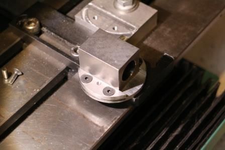

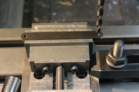

                      Having drilled and tapped the link joiner the next job was to drill and ream the holes in the links.
                      Held in my little vice clamped on the VMB table, lined up using a point in the spot provided. Drilled 8 holes 5.9 mm then reamed out to 6 mm and deburred.
                      Next, the work head swivel. This goes at the other end of the pantograph and allows the work head to be turned to the required cutting angle and clamped. The large hole in the centre as supplied is about 36.5 dia and needs to be bored out to 38. The spottings for the screw holes are accurate in the cut blank but nothing else can be relied on. So I cautiously filed the straight edge next to the spottings smooth to the outline (which is laser marked on the edge, with about 1 mm machining allowance), and set it against a straight edge clamped square to the table. Then aligned the mill spindle to one of the spotted holes by holding a point in the chuck and adjusting the point so it entered the spotting accurately as judged by eye and feel. Then I clamped everything down, so we have the spottings aligned square to the table and the spindle axis aligned with one of the spottings. Then I moved the table Y by 15 mm which places the axis exactly halfway between the spottings; and X by 27 mm which places it in line with the centre of the big hole. Locked the slides, fitted the boring head, it needed 4 cuts at about 100 rpm to take the hole diameter to 38.02 mm – not bad.
                      Then I could drill and tap for the link pivot bolts and make a trial assembly, as shown here.

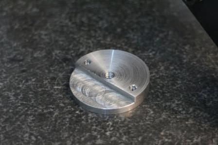

                                          A bit more progress. Have now progressed to the "ways" that bolt on top of the work head base. These are segments of circles, laser cut from plate, with hole positions spotted accurately but a general machining allowance round the edge of about half a millimetre. I started off confidently drilling the mounting holes but soon realised (should have thought before) that actually it is critical to machine all round the edge to get these accurate and there is no obvious datum other than the holes. After a lot of though in the small hours of this morning I've decided this is a job for my cnc mill, but will need a mounting fixture using the accurate (I hope!) drilled holes as a datum. That will be a job for Saturday when I can also take some photos to post. Watch this space!

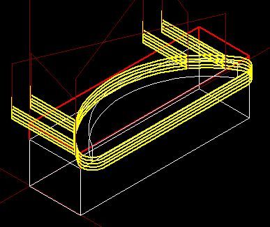

                                              OK, so now the ways are machined all round. I made a little fixture (or is it a jig?) to hold them on my Novamill – basically a small square of 16 mm ali squared up so I could locate a corner datum, with a couple of holes coordinate drilled/tapped M4 to clamp down the blanks, drilled to exactly the required spacing (20mm) and at known positions relative to the corner datum.
                                              Way milling
                                              Here the adjustable way is bolted down using csk screws to pull the blank into alignment, in the process of profiling round the blank. The block is clamped down with a single M8 flange nut and braced against the mill fence which is at right angles to the table. 6mm end mill, 1000 rpm, 50mm/minute feed. This was the second part being milled, you can see that the cutter went 0.1 mm into the fixture first time round (deliberately) to clear all the periphery. I generated the toolpath by working out the exact dimensions and using G-Simple which is a free CAM package, highly recommended. Here is s picture grabbed from the screen of the simulated toolpath:
                                              toolpath
                                              And this is what the end product looks like with the ways bolted down and the work holder in the slot as a trial assembly.
                                              Trial assy.
                                              I also asked Gary at Eccentric about this and he recommended a much simpler method which I would have used if I'd thought of it! Here is what he said (he is quite happy for me to copy it here).
                                              "I found the simplest way to machine that edge was to drill both holes in the way then use a pair of dowel pins or two small pieces of rod in the holes and grip it in the milling vice. It doesn’t matter too much about the diameter of the pins so long as they are straight, accurate and are the same diameter. Put the pins through the holes and have them sitting on the top of the vise jaws supporting the way between them, this will ensure that any cut taken will be parallel to the holes. Make sure the top of the vise jaws are parallel with the table before taking a cut of course."
                                              Simples!

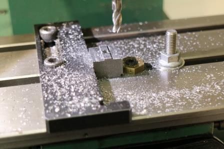

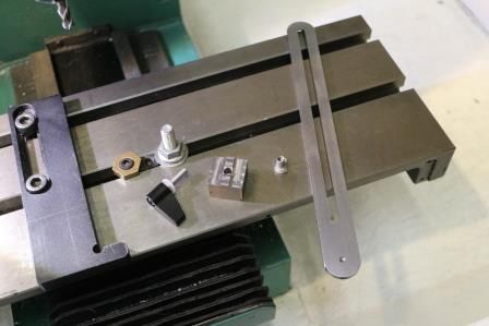

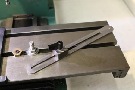

                                                    Some progress with the fence.

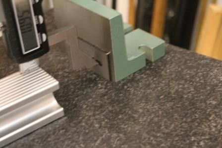

                                                    This shows the fence parts so far, the stop block, the fence itself (which is supplied cut out and slotted, just needs one hole drilling), the tee nut and the locking screw/lever.
                                                    The assembled fence. The drawings show the block with chamfers on the edges, but actually I think it looks better all square. (Well, that's my excuse!)

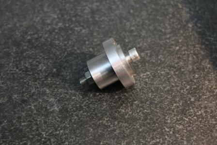

                                                    No pictures, but the tee not was a simple turning & milling job from a bit of 12mm bar (supplied).  I popped in my dividing head (with Ward controller) and machined the flats to fit the wider part of the slot, then turned and parted off the final piece on th lathe.
                                                    The block is supplied as a lump a bit over 16mm long sliced from a 20mm sq. bar. The ends need facing to thickness (15 mm) then there are tenons to be milled in the base to slide in the slot and 3 screw holes, one for the clamp screw, one for the adjuster, and one for a pad screw that applies some friction through a nylon pad to the adjuster. As shown the block has been faced, drilled centrally for the clamp screw, and had the tenons milled.

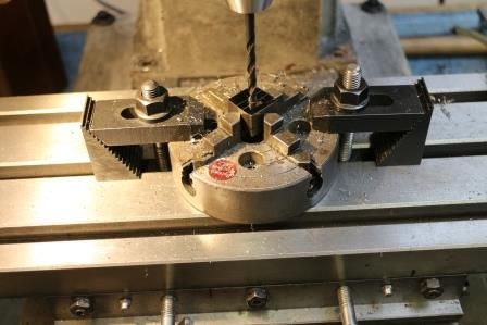

                                                    For little jobs like this where neither end is square it's often convenient to clamp it in a 4-jaw on the mill table. This is an old, hardly used but much abused Burnerd chuck I picked up for very little from a market stall. I finally got round to cleaning it up and making a key for it for this job. The advantage of a 4-J for this is that it acts as a vice which constrains the workpiece around two axes so the other axis has to be vertical. Here it's shown drilling the clamp screw hole but I used a similar setup to face the ends.
                                                    I made the tenon on one end using the Novamill. Clamped the block to the table, used G-simple to generate code for a "rectangular bulge", and set it off. Note the use of a Mitee-Bite clamp, I've never had one of these slip when doing a milling job. They came with the machine, an ex-school unit I scored on eBay, though I had to make my own drive system.
                                                    Next, need to drill the remaining holes in the block, and make the clamps that fit the fence to the table. Then the basic unit is done and I can get on to the toolholders!
                                                    Edited By John Haine on 24/11/2015 15:16:30
