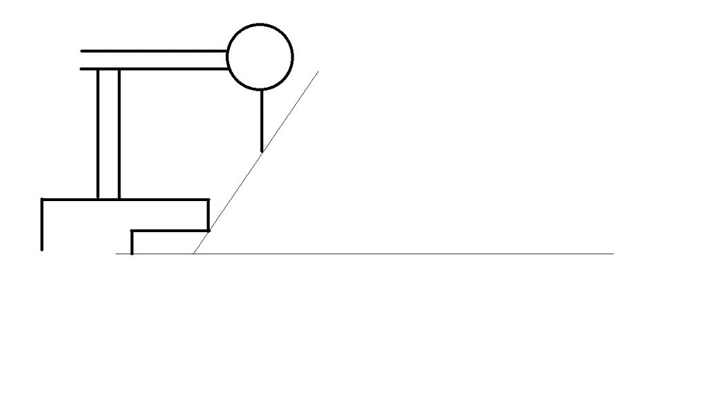

            I would think some variation on the sine bar approach would be the way to go…

              Actually, BikePete, that makes a lot of sense.
              I'd been thinking about how to measure horizontal and vertical accurately which was throwing me.
              The sine bar allows me (in theory) to set up the target angle and either measure the distance top and bottom or blue. Also, sine bars appear on our favourite auction site at not ridiculous prices.

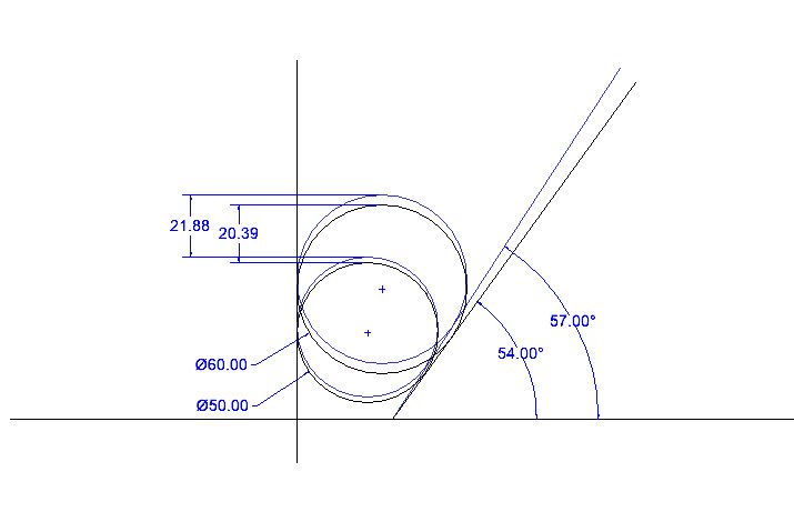

                                Is this not a job for a surface table, reference square and some different diameter dowels under the height gauge?
                                Mark
                                Regarding sine bars, a sine table might be more use but rollers should give some indication of the state of the prismatic face

                                    #263911
                                    Gary Wooding
                                      @garywooding25363
                                      As Marks suggested, how about something like this – the sizes have been exaggerated for clarity.
                                      #263912
                                        Extract from the .TXT file in the link that I posted yesterday:
                                        If I take two cylinders of diameters d1 (smaller) and d2 (larger) and lay them in contact with each other on a horizontal plate, a flat plate placed across them will form an angle, theta, with the horizontal given by:
                                        d1/d2 = (1-sin(theta/2))/(1+sin(theta/2))
                                        … – the cylinders provide their own spacing if you adhere to the formula above.
                                        That ^^^ has to come-in useful sometime !!

                                                    How about this, no harder to set up and easier maths:
                                                    Angle plate on surface plate, place prism up against angle, but instead of pushing it up hard against the angle, lay a flat shim along its length with the edge bevelled underneath so the top surface goes hard into the corner.
                                                    If you put a cylinder of radius R into the vee so formed and measure the height to its top surface as H, the angle A is:
                                                    A = 2 arctan ( R / (H-R))
