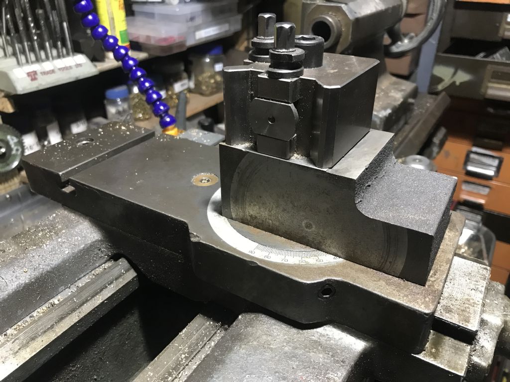

            There seem to be a few owners of MD65's on here so I'm sure you'll get some help. If you add a photo of the offending part(s) it would be good.
            I’m just wondering if it's the cross slide which is faulty or the top slide (which is what tool post bolts to). I may have my terminology mixed up as I no expert.
            If it is the top slide, you could just remove it and mount the tool post on the cross slide.
            I've done that with my lathe, I just have a spacer under the tool post. I only ever use the top slide for cutting tapers and threads larger then about 1.5mm pitch.

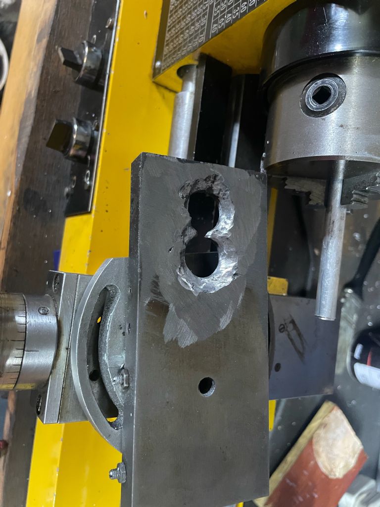

              See, I said I was a complete novice, of course you are correct it’s the top slide which is broken! I had heard of just removing it but then I couldn’t see how the tool post would mount as it uses 2 m8 bolts to attach to the top slide and of course there aren’t any mounting points on the cross slide. BTW i am located just outside Scunthorpe in North Lincolnshire…. The height of the tool post also relies on the top slide so without it the tools would be very low and there isn’t enough adjustment to raise them. I had thought of drilling and tapping the other end of the top slide and just reversing it which I can’t see why it wouldn’t work…

                      Hi Chris,
                      I made a packing block out of a lump of cast iron.
                      His attaches to the cross slide the same way as the top slide did, and is drilled & tapped to allow me to bolt my tool post to it.
                      Toolpost
                      I'm surprised at the improvement in rigidity with the top slide gone. It was only meant to be a temporary set up, but it’s become fairly permanent.

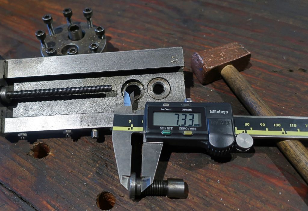

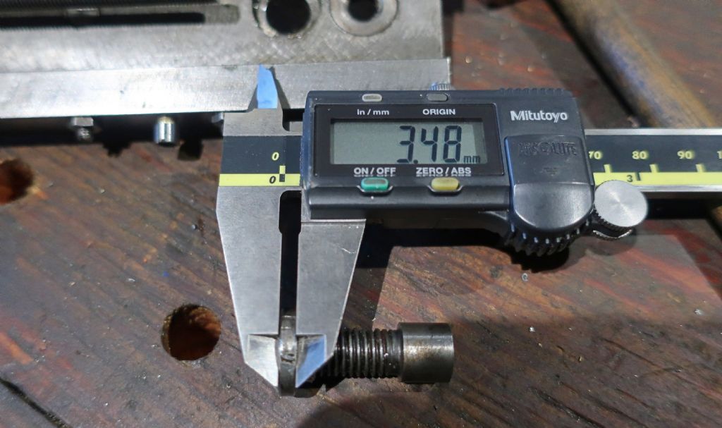

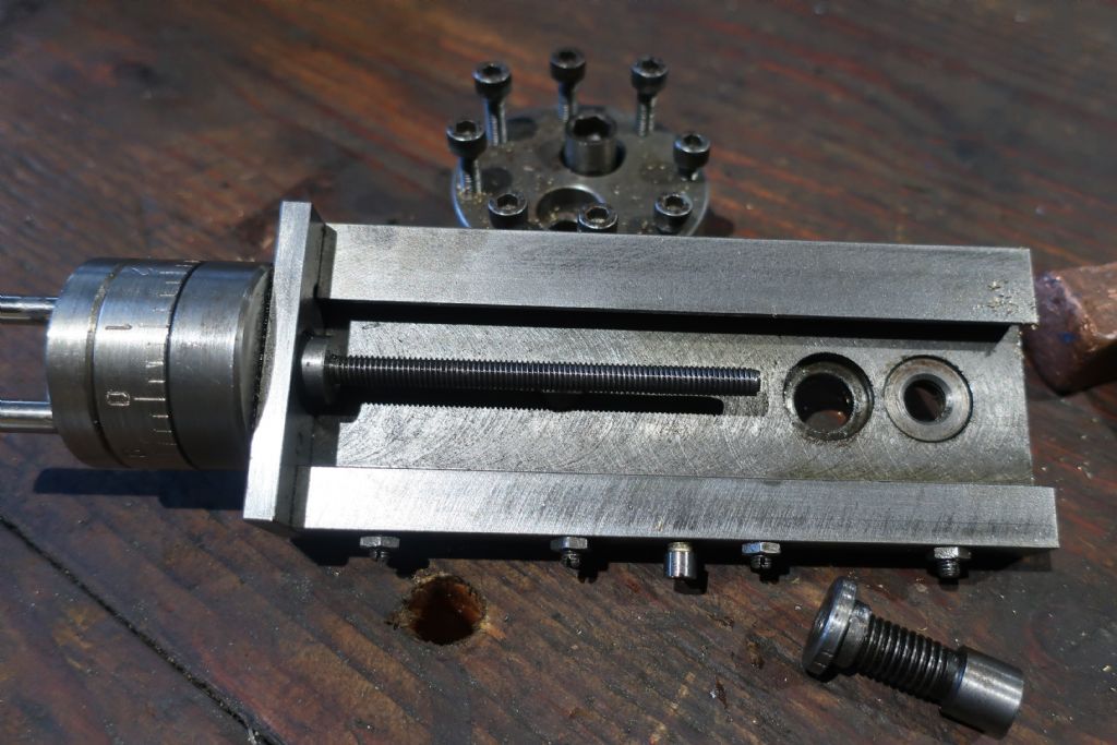

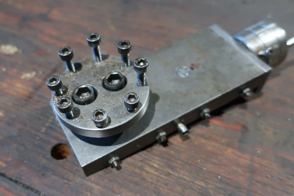

                        For the record, here are photos of an ugly repair that had been carried out by a previous owner of mine – the bolts securing the tool holder are M10, which suggests to me that it probably wasn't his first attempt..
                        FWIW having slept on it, I stand by the Helicoil suggestion..
                        Topslide
                        Topslide below
                        Flange depth
                        whole bush depth

                            I suspect this is beyond saving – when I got it the captive nuts had been welded in but the weld had lifted so the tools could not be mounted securely. Tried re-welding but it's not the easiest material to weld and although it looked OK obviously had not penetrated the material as just lifted again. I do have a similar thickness plate of steel from my hydraulic press which I am thinking I could modify to make a fixed mount for the tool post.

                              OOH!  Just posted and seen your photo!  Now that HAS been butchered, hasn't it?  I think you'll find that the topslide is cast iron – so difficult to weld.  You might get away with a brazed repair, but it won't be pretty.  If I was you, I'd look around for a replacement in better condition.

                                  That's a mess, a replacement could be hard to find as well
                                  Gasless mig can sort cast iron but you need to get going asap or you'll lose interest
                                  Dump that top slide to one side and make a toolpost for the cross slide which will do 90% of your work anyway
                                  This is an early version I did for myself

                                      I would cover the hole with a 4mm steel plate held down with four off m6 counter sunk screws into the good iron avoiding previously welded surface as it may be too hard, not too near the dovetails. Then drill two holes in the plate m10 clearance, welding two m10 nuts underneath the plate.
                                      You need sufficiently flat surfaces for this to work properly or you end up over tightening so check the plate for warps before continuing.
                                      My experience with cast iron and welding – you lay some weld on cast and hear a tinkling sound – thats the weld breaking.
                                      You use cheap 90% nickel rods with iron (FE) in them , they weld OK but the weld is too hard for HSS tools. Use expensive 99% nickel rods and everything is good to go.

                                                OOooer.. ..well, a faint ray of hope occurs to me – one of the peculiarities of the Hobbymat is that the topslide and crosslide dovetails share the same dimensions, so a cross slide 'body' will fit on the topslide 'base' – in fact, the topslide body is just a sawn-off cross slide body with different holes drilled in the top of it, and reversed (even the gib-screw holes line up correctly).. ..if you set one on top of the other so that the gib-holes line up you will see what I mean…
                                                Tony Griffiths seems to have some cross-slides, but will charge you…
                                                Lathes.co.uk. Hobbymat Prazimat Topslide Casting…
                                                Heritage Lathes will charge you a bit less for this one from his Ebay shop.. (I've dealt with him, seems a reasonable human being for an Ebay vendor)
                                                Heritage Lathes Ebay Imperial cross slide
                                                ..hope the link works.. ..I don't think you need to worry about the Imperial feedscrew, but I guess you might want to check the slide dimensions with him just to be sure..
                                                You'll still have to do some drilling and milling, but I see you have an offer of help..
