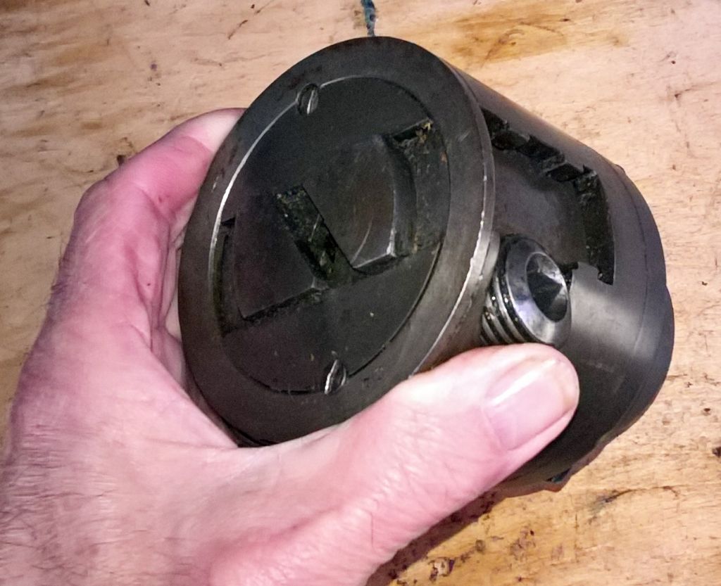

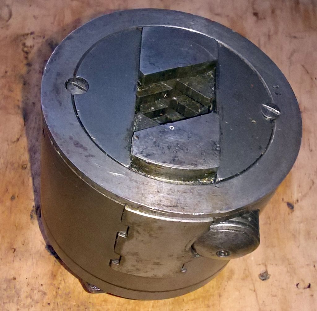

      This unusual 3" chuck was originally supplied with my German Pittler lathe from 1895, the catalogue lists it as a two die chuck.
      The makers mark is a crown but not sure who the maker was if anyone knows? the only other marking on it is 1" so it's imperial as is the other 3 jaw chuck supplied as standard but made by Cushman USA
      Edited By vic newey on 25/11/2022 11:15:03

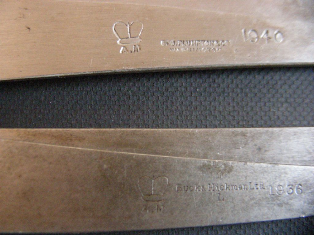

          I have seen that mark before and have a faint feeling that it is a government mark.

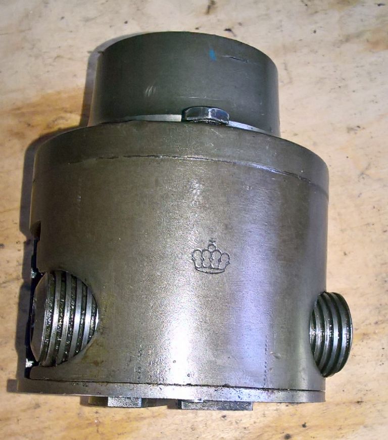

            Hello Vic,
            I recall Crown supplied chucks to Myford for their early ML 1-3 lathes, the nose thread changed in size and pitch for the ML4, one of which my father bought in 1945
            It may not of course be the same maker but the coincidence in activity is striking

              Martin Johnson 1
                @martinjohnson1
                I had a smaller version with my first lathe. An excellent chuck as I recall. Only snag is that on very small drills (and they will grip down to zero) the jaw will deflect the dril; just needs care tightening on small stuff.
                Definitely a keeper.
                Martin

                    I have a Pratt 2 JAW chuck which is similar but the back end is thinned down. "No8 Empire chuck"
                    In the first link Addy posted a Drummond catalogue print which has a bell chuck – sort of 4 jaw in its day. I have one of those too.

                      I had a thread regarding a smaller version which was laying about at the museum, unfortunately even after buying a suitable Morse taper to chuck adaptor, it didn't run very well and it has been consigned to the bits box. Also Crown brand.

                        I have a smaller version with a BSA three rifle logo stamped on.
                        Frank
                        #622644
                        Tom Sheppard
                          @tomsheppard60052
                          That'll be the Bantam size.

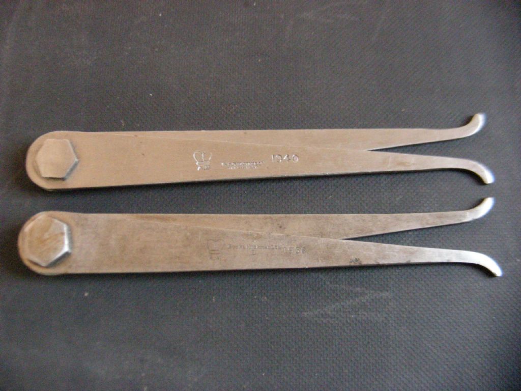

                          ega
                            @ega
                            Posted by ega on 25/11/2022 11:29:10:
                            Clearly, I was wrong!
                            FWIW, here are two examples of the items faulty recollection of which misled me:
                            Does anyone still use these?

                            roy entwistle
                              @royentwistle24699
                              Ega Yes, I do. Also outside ones and Odd Legs
