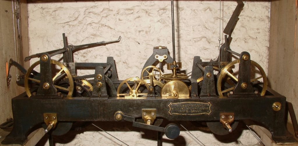

      I have access to (OK I have wound it twice a week for 20+ years) a flat bed tower clock in the local church. It occurred to me recently that creating a model of it it might make a good build project (once I get the current list out of the way in a year or so!).
      It is a three train flat bed clock made in 1889 by Smiths of Derby, and still maintained by them.
      The movement is fairly simple, pinwheel escapement, count wheel chime and strike. Each train has a limited number of wheels. All the pinions are lantern, and the bearings are brass bushes, some in iron castings individually mounted on the top and bottom of the bed so depthing should be fairly easy. The bed is one piece cast iron – but I would probably fabricate it from steel.

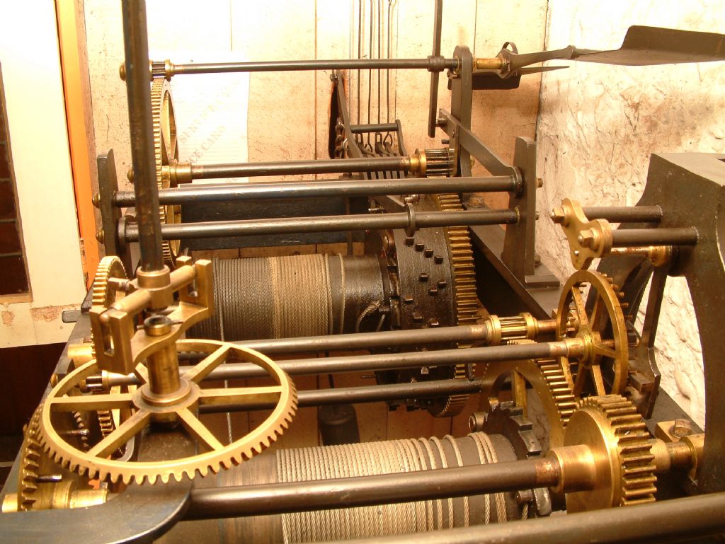

      The real thing is about six feet wide. It beats 3150/hour, and trips the chime train four times for each revolution of the output shaft (closest to the camera on the image above) . Thinking it through I t seems to me that if I made a 1/4 scale version it would beat twice as fast, and if I tripped the chime train twice per rev I would get a clock that looked OK, and kept to time. The motion work behind the dial ( about 20ft above the clock) is driven by a pair of bevel gears.
      By halving the ratio of these gears I should be able to get the hands to turn at the right speed.
      I can't see anything too difficult (apart from having to learn how to cut wheels!!) except possibly the pair of bevel gears that send the output up to the dial and those on the motion work, and the latter could probably use a standard commercial set as they will be non scale and hidden behind the dial.
      The chime barrel will be fairly fiddly to get right, but in principle should be doable.
      Before I set to measuring the real thing, counting teeth and planning a bit harder, I thought I would ask on here to see if anyone has done something similar – or if anyone can think of any major gotcha's I might run into.

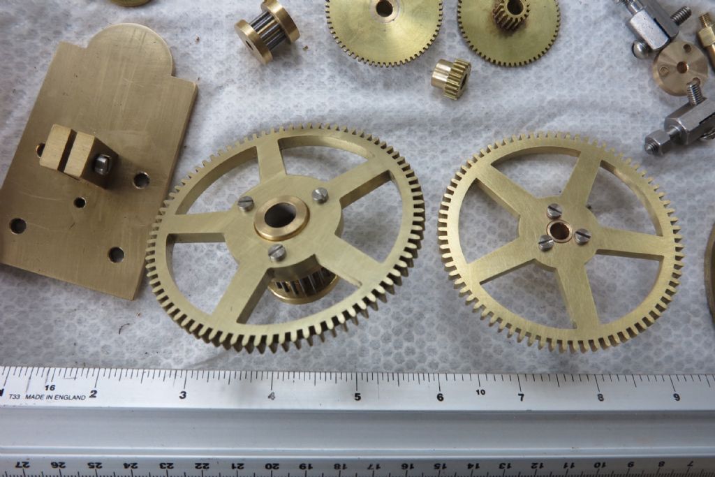

                                                  Peter Cook 6
                                                    @petercook6
                                                    Posted by John Haine on 02/11/2021 07:24:04:
                                                    Though a departure from scale, had you considered a compound pendulum, ie one with mass above the pivot as well as below so it will still beat at the same rate?
                                                    Thanks John for the thought. It had crossed my mind. The pendulum hangs down behind the frame, so an arm at the top extending upwards past the suspension would be a possibility. But I am struggling to find a source of the math for such a pendulum. My applied math is so far out of date I don't think I could work it out from first principles.
                                                    Receipt of a copy of Ivan Law's book on gears (about which I knew very little), hard thinking and some spread sheeting over the last couple of days has produced a possible arrangement. Slightly longer pendulum with finer gears than scale on the great and second wheels and a few more pins in the escape wheel produce a set of figures that beat almost twice as fast, but still revolve the output shaft once per hour while the gear diameters remain fairly close to scale.
                                                    Now whether I could actually make a set of M. 0.4 ten pin lantern pinions, whether the required 0.6mm diameter (I think) piano wire/pivot wire would be strong enough for the pins and whether the resulting lantern would have room for an arbor are entirely other questions!!
                                                    Thanks again for the encouragement – although it does feel a little like I have stepped through Alice's looking glass and am being sucked further and further into another reality!!
