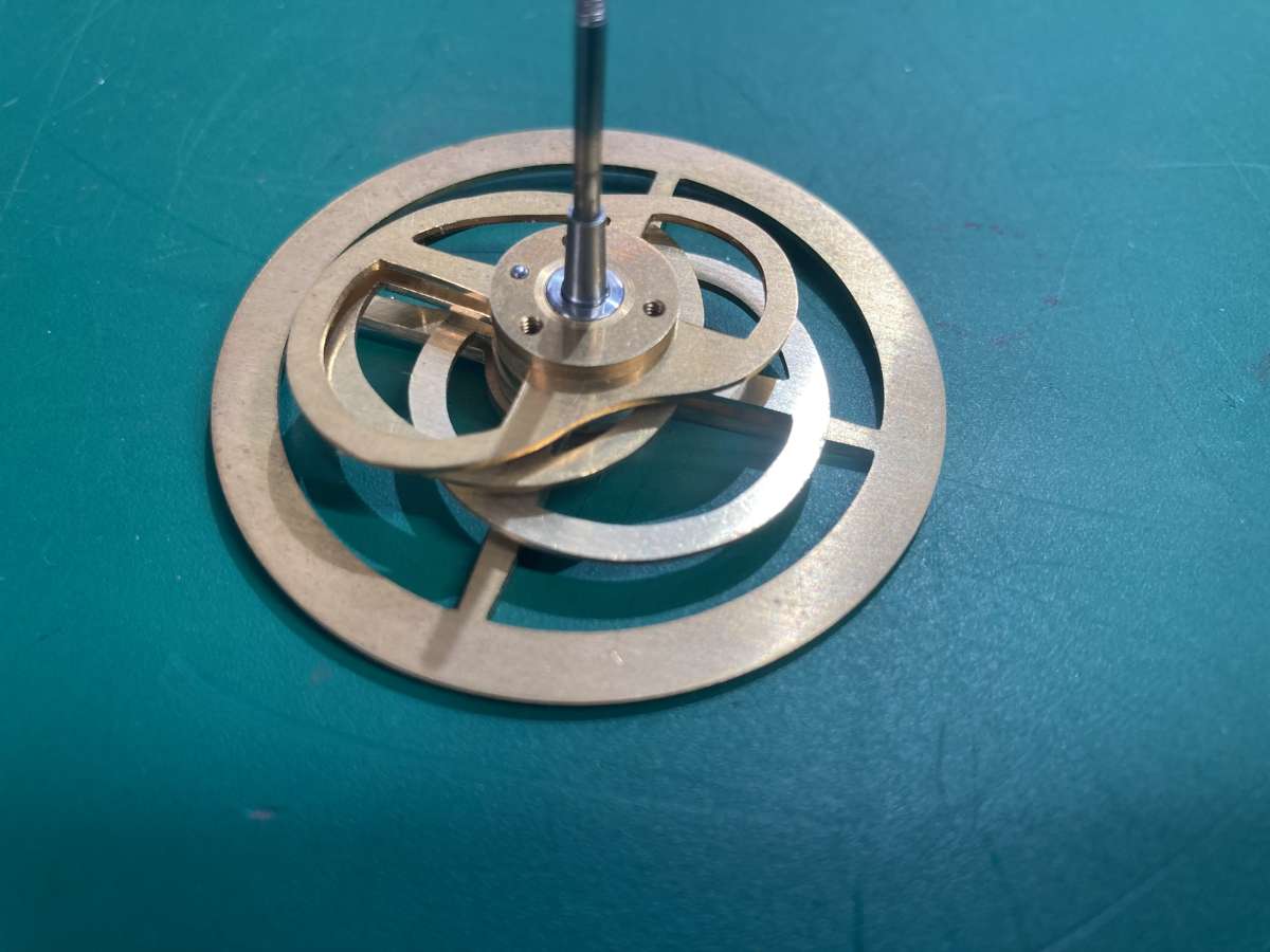

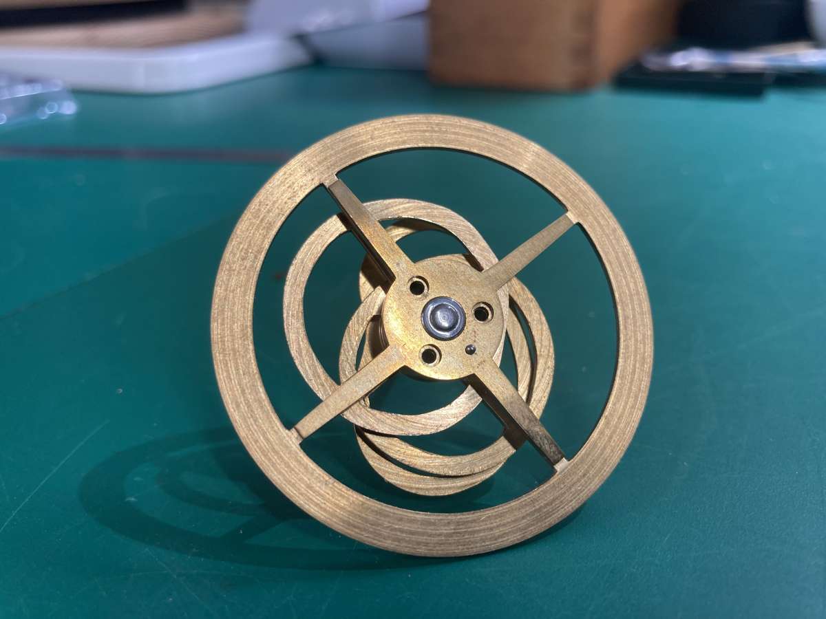

      I’ve just finished a “cam stack” for a clock I’m making.
      IMG_1203
      Here it is from the back. In order, an equation of time cam, sunrise, sunset and the annual calendar dial.
      IMG_1204
      The whole thing probably took me longer to plot than to make, especially to synchronize the three as the cam followers are all at dfferent radial points.
      I’ve fettled and calibrated the EoT and sunrise. I’ve not made the follower for sunset yet.

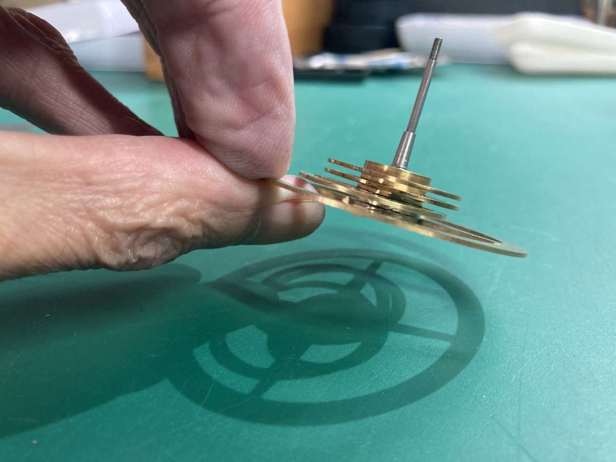

      Here’s a side view complete with fingers for scale.
      IMG_1210
      Trouble is, I will never be able to move now as the cams are specific to the Isle of Thanet.
      Cheers
      Steve

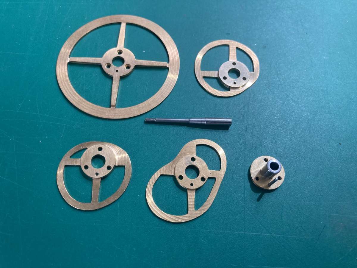

            Component parts for the cam stack. I still have to make the 3 screws.

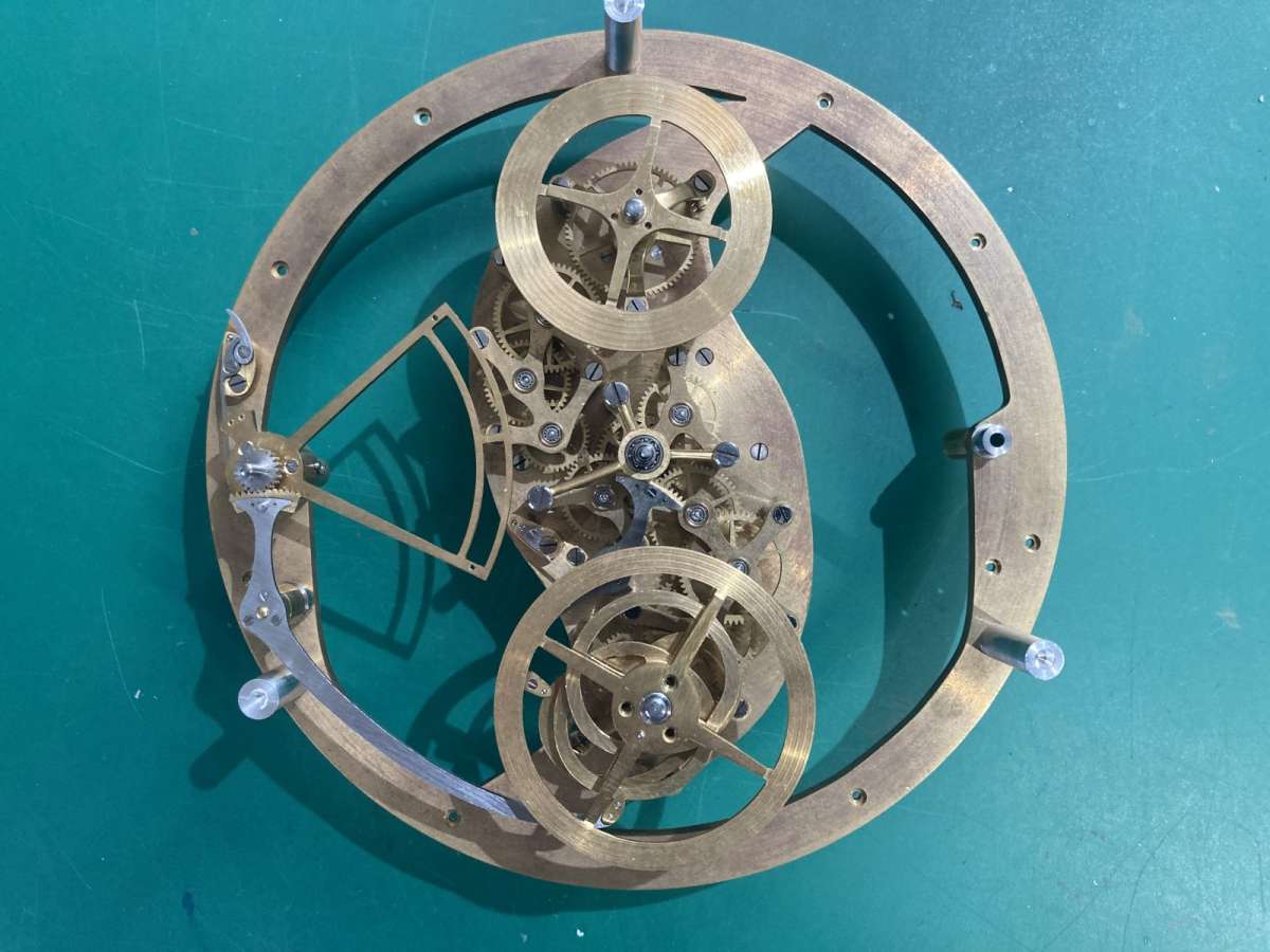

            And here it is in place on the clock. Apologies, this is a really lousy photo but gives the general idea.
            001
            The sunset mechanism for the right hand side has not been fitted yet. I have still to make a few small components.
