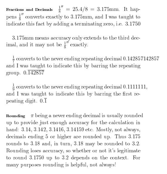

                  Michael surely deserves a gold-star for asking this years most difficult to answer simple question.   He asked:
                  Has Bosch really changed the tool shank diameter from 3.175mm [1/8”] to 3.2mm, or are they just incapable of expressing numbers to 3 decimal places ???
                  Although the question can be interpreted in a simplistic way,  I suggest Michael’s cracker has hidden depths!    They include:
                  • Fractions versus decimals
                  • The accuracy of decimal notation and how to represent it
                  • The correct way to round decimal numbers, and when not to!
                  • The difference between decimal numbers as used in day-to-day maths, and specialist applications like engineering, manufacturing, and science.
                  • Metric versus Imperial and the evil resulting from converting between them
                  Stuff we take for granted today, but took millennia of painfully slow hard work to understand.
                  Fractions and decimals take us to the concept of the number line; what are numbers, how accurate are they, and what operations can be performed on them?  (Add, subtract, divide, multiply and many others).   Just dipping into the subject as applied to Michael’s example reveals there’s a lot to it.  This is what I remember being taught aged 11 or so:
                  dsandfs
                  After we leave school these rules fade because most ordinary sums are “good enough” without applying them.  Doesn’t mean they don’t matter though!   In Michael’s example Bosch misjudged their audience; I blame their Sales Department!
                  I won’t go any deeper.   The subject is endless, not many Model Engineers are interested in maths, and my skills are superficial.

                          Pedant alert:
                          SOD states pi is rounded up to 3.14. That’s actually rounded down. His text should more accurately have said ‘pi is rounded to…..’
                          On many engineering detail drawings there would be a statement linking tolerance to the number of decimal points. In this case 3.2 would be +- 0.05. Bit much to expect Joe Public to understand this, if you ask for a 1/8″ drill in my local hardware shop they offer you 3mm as it’s “the same”

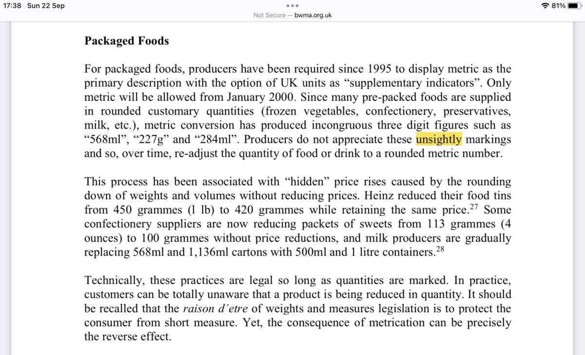

                              … let me just chuck this document in, for broader reference and possible amusement:
                              http://bwma.org.uk/wp-content/uploads/2019/04/A-Fair-Measure.pdf
                              It was published a while back
                              Read it, or don’t, according to your preference.
                              Here’s a sample:
                              IMG_0123

                                        On duncan webster 1 Said:
                                        Pedant alert:
                                        Hopper is right!
                                        On many engineering detail drawings there would be a statement linking tolerance to the number of decimal points. In this case 3.2 would be +- 0.05. Bit much to expect Joe Public to understand this,…
                                        Yes, but who is Joe Public?   I’d expect a Dremel user to have some technical nous.  Maybe not though – quite a lot of excellent work is done by practical men who don’t understand how their tools work.  Most car drivers don’t know or care how the engine works, and those that do often have limited understanding  – more to IC engines than Suck, Squeeze, Bang, and Blow.   I’ve grasped adiabatic expansion, but entropy is beyond me.
                                        Might have to forgive Bosch because they sell to artisans and engineers, and many of their customers must mix both skills to some degree or other!

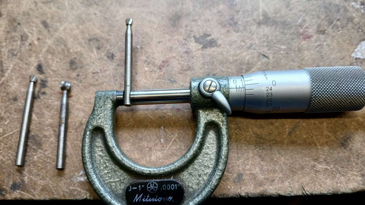

                                                The Dremel branded carbide burrs all seem unplated and are close to 1/8″ all falling between 0.124″ and 0.125″, none oversize.
                                                20240923_102751
                                                    Many thanks for continuing to take my question seriously, Jason
                                                    … I do appreciate it.
