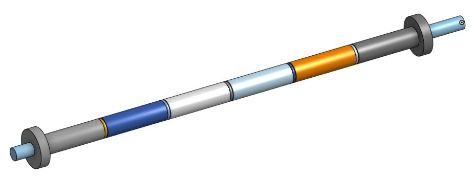

                      Finally got round to giving this a little more thought! Thanks all for the suggestions and input. I want to make something I can easily use repeatedly, and I was also trying to work out how to easily machine the whole length in one operation, so putting together your comments I came up with this:
                      Lots of o-rings, not so much to grip the part but so that the piece doesn't flex under cutting load – I did another long piece the other day at 16mm external diameter with a ~3mm hole down the middle and it has a huge bow in the centre of the piece where the cut was unsupported.
                      The internal shaft will be threaded at both ends so a nut can bear on the two end pieces – I've drawn these as a single part but I would think in reality a washer would be fine.

                          Posted by Calum Galleitch on 26/05/2022 09:46:47:
                          If you place a Dremel grinder in the tool post, you can grind the rod to final diameter. Due to the lower cutting forces, the rod will bend less. For Delrin, you need to run the Dremel at low RPM to prevent melting the Delrin.
                          More O-rings will support the rod better, especially if the inner diameter isn't close to the mandrel diameter.
                          In stead of drilling to final size, you could ream the rod (from 2 sides). That will give a pretty tight fit on a 12 mm mandrel. My standard length 12 mm reamer could ream about 120 mm deep.

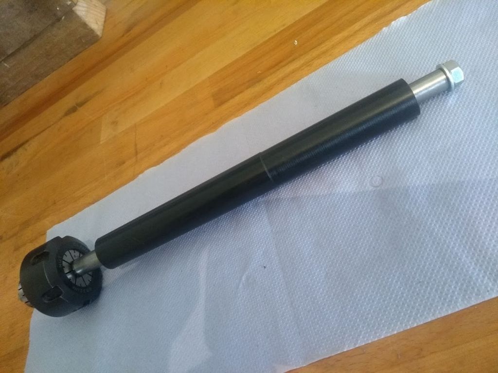

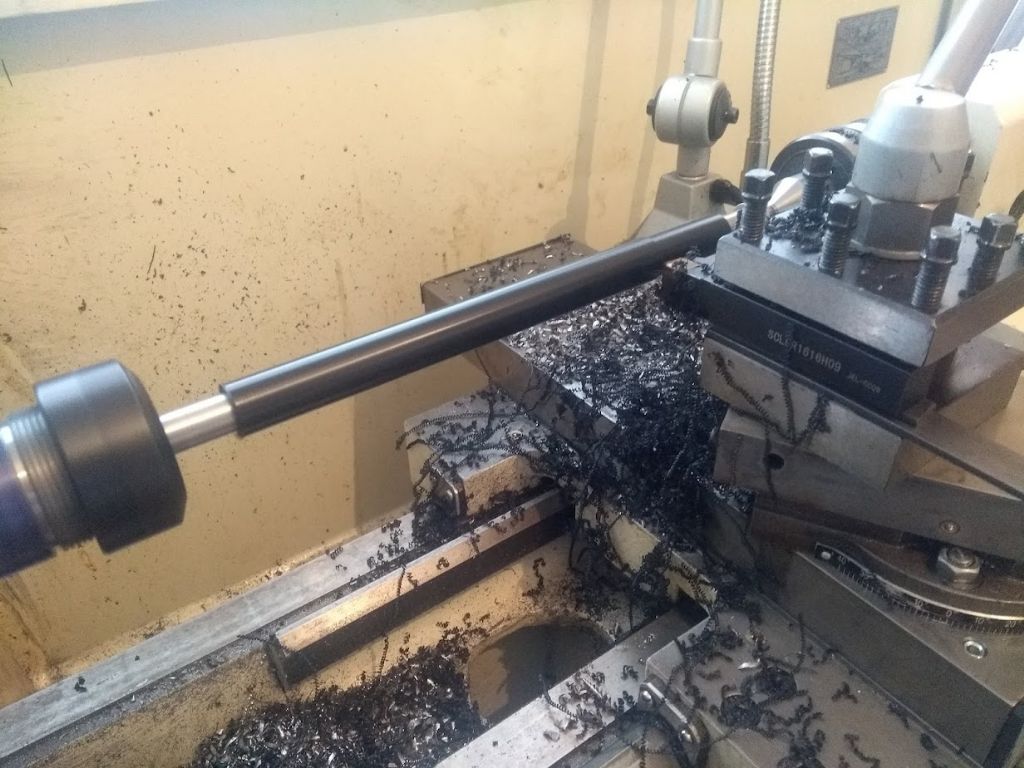

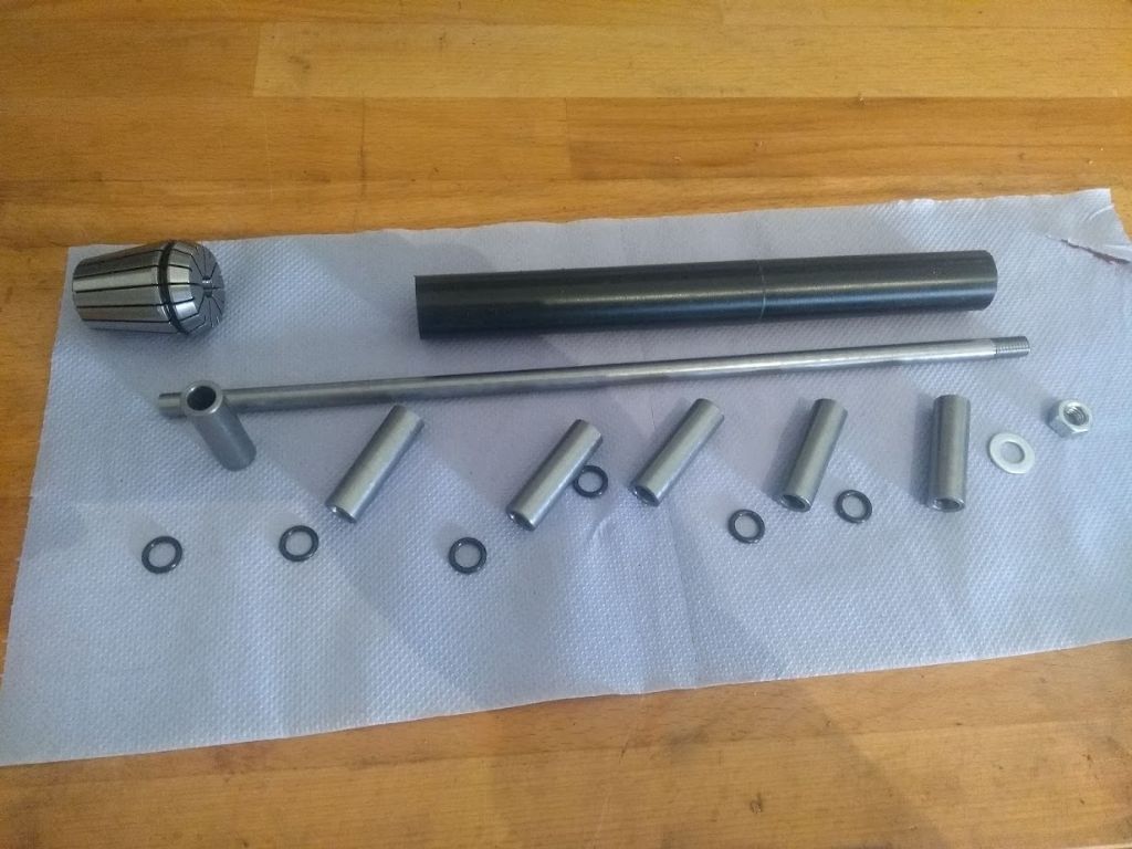

                            Had some time today after putting together the Comically Oversized Vice (I'll update another thread with the gory details) so went ahead and had a go at putting this together.
                            Playing around with the 8mm shaft, I'd originally imagined I could hold it in the three jaw but it was pretty obvious the runout made it a non-starter…if only I had a collet holder of some kind – wait!
                            In the end I did the whole thing in the collet holder and it worked so well I am sorely tempted to consider making a backplated collet chuck to hold longer stock. Here's the finished parts:
                            The black piece of Delrin is the tube I want to machine down, already with the 12mm hole down it. The shaft is 8mm and the tubes, drilled out in the collet holder, are a nice sliding fit. An O-ring protects the face of the collet and the nut at the other end compresses the six pieces:
                            The holding force on the part is excellent; once installed, I couldn't begin to move the part, and the assembly was more than stiff enough; there's no measurable bulge due to deflection in the final part. Here it is being machined:
                            I mostly took 1mm depth of cut with fastest carriage feed; I'm not sure exactly what it is as my geartrain is set for screwcutting, not feeding, but it was Quite Fast. My last couple of cuts were slower with a 0.5mm DOC which produced a good finish (for Delrin!)
                            This whole setup worked so well I might consider replicating it for other workholding jobs – inevitably, woodwind instrument making involves holding an awful lot of things with holes up the middle…
                            Thanks to all for your helpful suggestions; getting to this point would have taken a lot longer without your advice!

                              It looks like the insert you are using isn't polished. Polished inserts for turning aluminium, work very well for Delrin and other plastics.
                              Also the insert seems to be a CCMT type (5° clearance angle). The thin Delrin chips can get easy between de part and the insert and will push the part away from the insert making the part thicker. I prefer a DCMT type insert for turning Delrin.
                              If you glue a piece of HPL, steel or aluminium under your turning tool, you never have to shim the tool to get it on centre height.
                              Do the same at the side of the tool and it is always positioned right below the bolts.
                              Nevertheless, I am glad you have a working setup!
