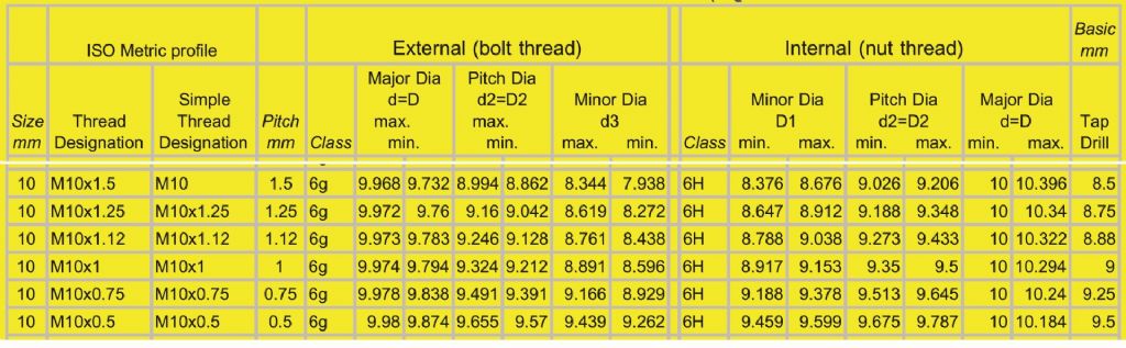

      I have had to make a number of new parts for motor bikes, bicycles, and other items, which require me to turn down a diameter to die cut a thread. Not knowing any better I usually start with the overall size of the thread, and continue reducing the diameter until the die will start to cut, very hit and miss, and time consuming. Being a relative novice I have bought a number of books that hopefully will keep me from making too many mistakes. I have read most of the books at least twice hoping to find the definitive formula that will tell me what the exact diameter should be for any given thread.
      Tubal Cain in his Model Engineers Handbook on page 4.11 touches briefly on the subject by stating 'a few thou under' Stan Bray in his otherwise excellent book, 'Basic lathework', ignores the problem completely and goes strait into screw cutting via the lead screw. So, is it all guess work, or is there a formula? or do I now assume that the same 'few thou under' is OK for a 3/8 Whit thread and a 6 BA.

                      Paul Lousick
                        @paullousick59116
                        I use a table from Maryland Metrics that has the maximum and minimum size of the threads. (extract shown below)
                        Paul.
                        Downloaded from **LINK**
