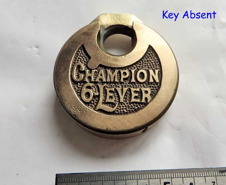

        Hi All,
        I have 3 high quality push key padlocks minus their keys
        There is a way to pick these and make a replacement "key" using 6 18g "Finish Nails" (US name?). I have been given some 16g but they are too large. I only need about 2" of them as they come stuck together for the nail gun. I don't really want to buy 1000 of these and throw the rest away.
        Wondering if anyone here could perhaps send me about 2" of them if they have any. I am, of course, happy to pay postage etc?
        Cheers, Martin

          Hello Martin,
          I think silver steel should do just as well. Machine it as soft and harden when you have it to the right diameter
          Regards
          Brian

              Hi Martin,
              There is a video on picking this lock and key manufacturing. Here
              If you want to get rid on one of the three locks please let me know wink
              Regards
              Paul

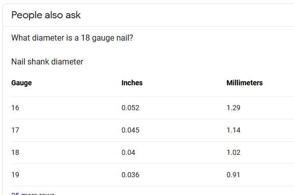

                Hi, I got the idea from the German chap who made a better video (don't know how to link it!) and he SAID 18g but the ones he used are J30 CNKHA with a large J on the pack. I guess he got the gauge wrong?
                Cheers Martin

                  The pins that these guns use are not usually round more rectangular with the corners taken off so may not go by the standard wire gauge measurements.
                  The 18g pins that my maestri gun takes are 1.25 x 1.0 and Tee head which looks like what he is using. PM Me your Address

                    Paul Lousick, just found this online re nail diameters?
                    Is SWG different?
                    Cheers, Martin
                      Cheers Martin
                      Ah, but did he say which gauge he's using? I've lost count of how many gauge systems are in common use, let alone the uncommon ones.

                        Paul Lousick
                          @paullousick59116
                          Hi Martin,
                          As far as I know, the wire gauge used in UK and Austraila is SWG. (As listed in this page from Wikipedia)
                          British Standard Wire Gauge is a set of wire sizes given by BS 3737:1964 (now withdrawn), and is generally abbreviated to SWG. It is also known as: Imperial Wire Gauge or British Standard Gauge. Use of SWG sizes has fallen greatly in popularity, but is still used as a measure of thickness in guitar strings and some electrical wire. Cross sectional area in square millimetres is now the more usual size measurement for wires used in electrical installation cables. The current British Standard for metallic materials such as wire and sheet is BS 6722:1986, which is a solely metric standard.
                          Read more at **LINK**
                          Not sure, but like lots of things, different standards are used in USA.
                          Paul.
                          #501537
                            If he's a yank then there is AWG.
                            But as I said the nails are in sticks more like thick staples
