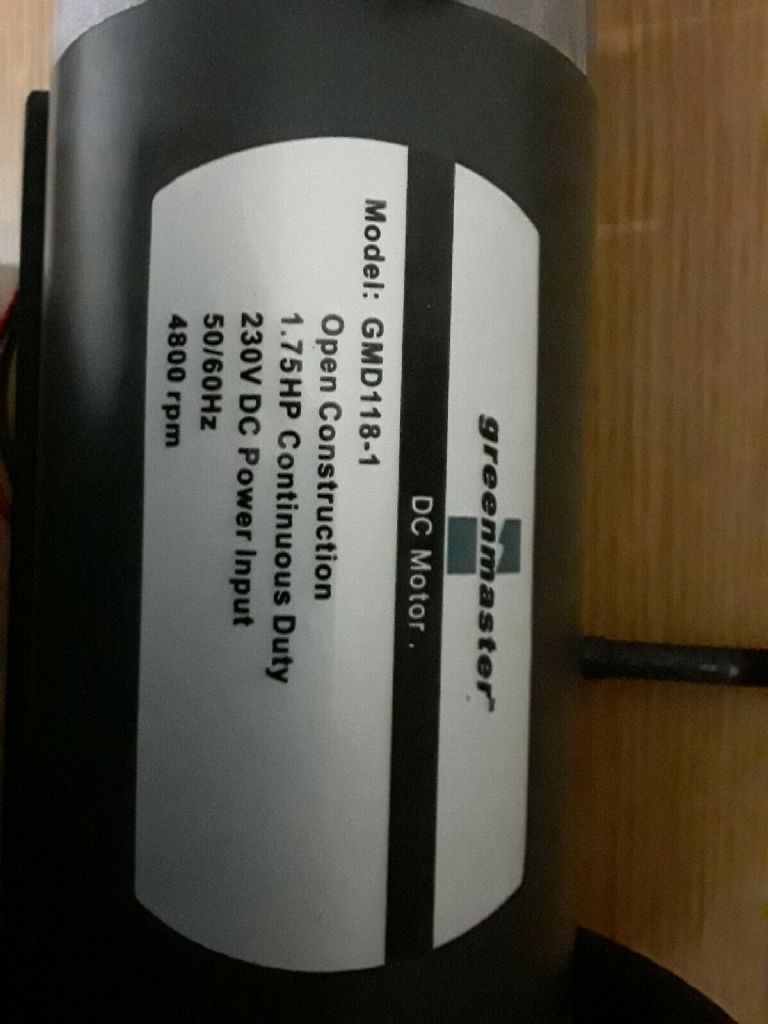

      I have just connected the motor to a drill battery the motor runs but clunks as it goes round.
      Oh dear, that's pretty conclusive: the cause isn't the controller or the wiring. I'm as sure as I can be without seeing it that the Treadmill motor is faulty.
      If the case against the motor wasn't already strong enough, the photo of the controller wiring looks good.
      I think Andrew's been unlucky: he's done everything right only to be stabbed in the back by a dud motor. Presumably it's second-hand and there isn't a supplier who will replace it free of charge? If so, how annoying, but try another one.

          The plate confirms that it a Permanent magnet DC motor.
          The fact that it knocks when run off a separate source, suggests to me that there is at least one armature winding that is either short or open circuit. A short circuit will be what keeps blowing fuses.
          Luckily, it does not seem to have damaged the control board irreparably.
          Either way. the motor is your problem, and is for practical and economic purposes, scrap.
          Solution,
          Buy and fit a motor that is correctly rated to match the control board.
          Howard

            I have removed the fan a for some reason knocking has stopped but it judders when running.

                Posted by Andrew Cressey on 15/01/2022 19:09:42:
                Fan (possibly slightly loose) was acting as a sound board. The motor is knackered. Any further effort is a waste of your time.

                  Hi Peter the person i bought it from suggested the bearings sounds damaged?

                      Thanks everyone for all your help i have just purchased a new motor i hope this is more suitable for my application.

                        Posted by Andrew Cressey on 16/01/2022 08:26:00:
                        Knackered bearings would explain rough running, but not the fuse blowing. There's an electrical problem.
                        Unfortunately a shorted armature winding explains rough running and the fuse blowing. I'm 99% sure your motor is a dud and needs to be replaced.
                        Nothing wrong with Treadmill Motors as a type, but bear in mind a second-hand motor may have been removed from a worn-out Treadmill. Although many treadmills are bought and rarely used, others are thrashed to death. Overheating is a likely cause of shorted windings: the motor was worked too hard for too long.
                          Damaged bearings are highly unlikely to cause the controller fuse to blow unless the motor is so stiff to turn by hand that it is overloading, and I think you would have noticed.

                            That looks like a tidy new motor. I'm intrigued that it's a DC motor rated at 50/60 Hz though…
                            How many connections does it have, and does it have a field winding?

                              Posted by John Haine on 16/01/2022 13:54:13:
                              Perhaps it is a universal motor, but being sold as a DC motor? Greenmaster doesn't appear to be a brand or manufacturer with any data sheets.

                                  Yup, seems it must be a permanent magnet field dc brush motor.
