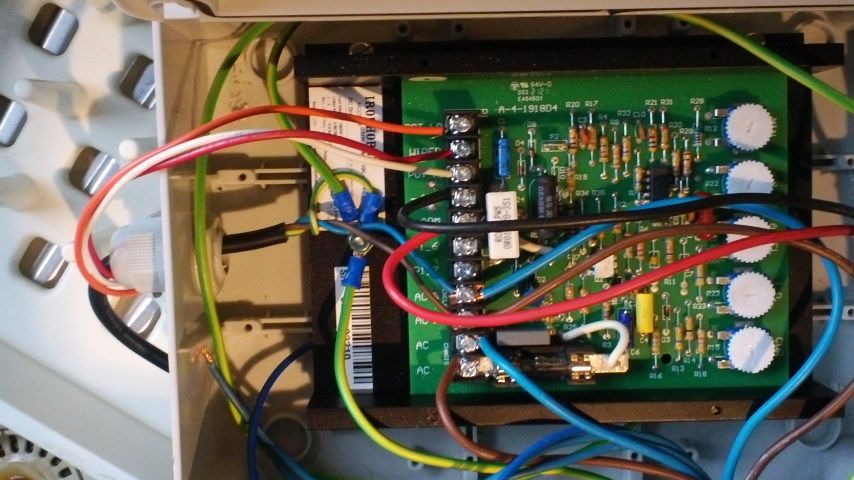

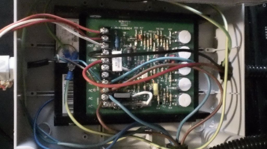

                    Hmmm, I've looked at the spec for the controller and it should be OK with 240Vac in and a 180Vdc motor.
                    I wonder if the Current Limit Pot is set too low? Might be chopping out the motor causing it to sound horrible, though I don't see why that would blow fuses.
                    Other thing I'm not sure about is the field and armature connections. Does the motor have field connections? If not, the field terminals should be left disconnected.
                    Jumper wrong? Maybe the unit is set for US volts, and 240Vac has to be selected.
                    Can you post some photos of the wiring and motor Andrew?

                      Thank you all but unfortunately sillyoldduffer i am not familiar with electronics or there meanings to have an understanding of what you mean,my apologies for my ignorance.Stuart here is a picture of the motor casing.

                          The spec sheet for the driver is fine for the motor, as SOD said.
                          clear photos of all the wires would help.
                          What fuse have you fitted?

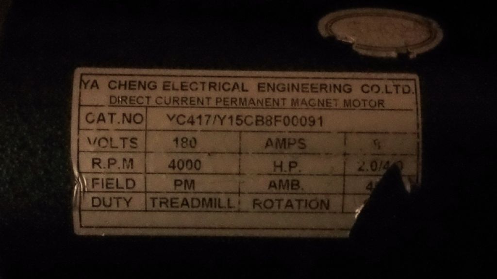

                                Was the motor new or used. If the latter(or even the former), you may have a bad motor. If one or more armature windings have shorted, you would get the symptoms you have seen.
                                If you have a meter, try measuring the resistance (with the motor disconnected) between the input wires as you turn the motor slowly. You will see some variation, but if the resistance goes very low at one or more positions, you could have a bad motor.
                                Did the motor company test the motor, or just look at the label?

                                      Of the GSD5 variants, only the GSD5-240-10N4-V looks to have a Jumper, so probably not that. I can't see any indication in the manual that 120/240vac isn't automatic.
                                      I fear Peter Cook is right, and the Treadmill motor is damaged with a shorted Armature winding. It explains the lumpy running and the fuse blowing and the controller working OK on another motor.
                                      The Manual says:
                                      Fusing
                                      The GSD5 has an internal fuse in AC line 1 (P1-11), and this fuse is sized to open in the event of a shorted armature or if an armature line is shorted to earth ground.
                                      Sorry, but my money is on the motor being faulty. Running rough and blowing fuses is highly suggestive of a shorted armature. Can be tested as Peter described by measuring the resistance of the motor whilst turning the axle. A £10 multimeter as sold by most car factors or Amazon will do the job.
                                      However, can you post photographs of the wiring? Connections to the motor, controller terminals, etc. Be good to find from a photo that it's not a faulty motor.
                                      The motor is 2HP. That isn't a fixed upper limit, it's how much power the motor can deliver without overheating. As it's OK to overload electric motors in short bursts, the 4HP is probably the maximum burst output. It's allowed for a few seconds provided the motor is allowed plenty of time to cool off after. When an electric motor is overloaded for too long the windings get hot enough to damage their insulation, and the motor shorts out. Once magic smoke emerges the windings are scrap. Usually cheaper to replace a small motor than have it rewound.

                                              My experience with a Clarke CL300 mini lathe is as follows. The motor is a permanent magnet type, rated at 180volts DC. This is supplied by a control board which is fed from the mains (230vac) and outputs a pulse width modulated, 180 volt DC signal to the motor, which is how the motor speed is controlled.
                                              There have been numerous posts regarding this type of circuit since I joined this forum over 10 years ago and a lot of the problems seem to be because of the lack of basic electrical knowledge by the OP. Having recently had a motor fail on my own equipment, I am inclined to agree with the conclusions above, that the motor is at fault. Before replacing it, the OP should consider whether that model is up to the job. Checking the control board output would also help, but I don't know if the OP has either the skill or the equipment to do this.

                                                It's certain that if the motor can deliver up to 2 HP, or even 4 HP for short periods, it will take a lot more current than the original mini lathe controller is rated at, so not surprising the fuse is blowing!!
                                                If you can access a 12V DC supply (e.g. a car battery), the motor would run happily on that albeit at much reduced speed if it is working properly. That would show up any problems such as shorted windings etc. But it might also short the battery so putting a fuse in series would be advisable.
                                                If this is not something you have the confidence or knowledge to do, then don't fiddle!! Why buy a 2HP motor for a mini-lathe if you can't anticipate the speed controller might have problems?
