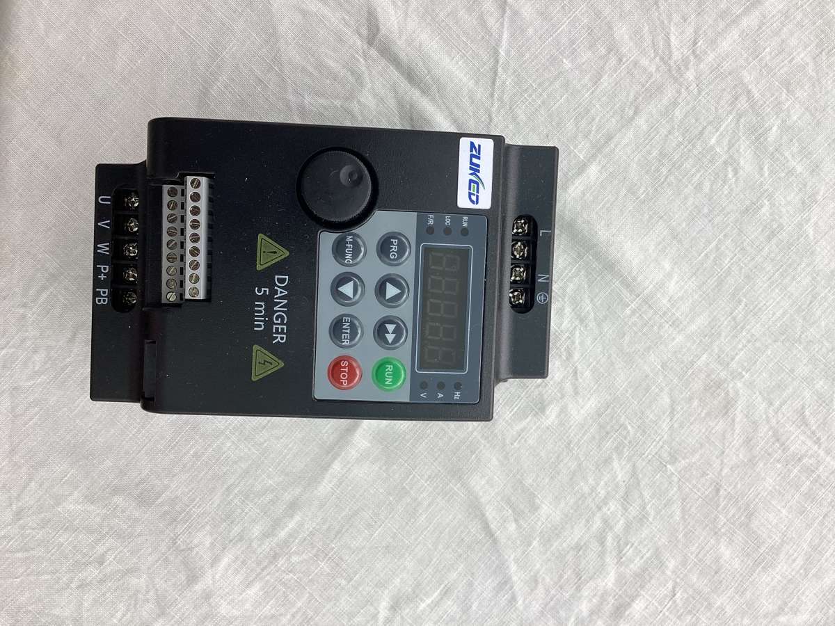

      I recently purchased an inverter as shown. Has anyone already programmed a similar item. If so would they like to share their experience ? A copy of their program would be much appreciated. I am a complete novice on such matters.
      JohnIMG_0070
      #753702
        May be a CW100 Manual here.
        Comment: this is a super-cheap VFD, £28 from AliExpress, and although the product might be OK, very low prices often mean  “too cheap”.  Have to try it to find out.   Buying one second-hand without a manual is a serious gamble!
        Even if brand-new, I distrust products with 5-star reviews that say:  The shipment came much earlier than the delivery date – 10 days. The merchant is very kind, good, responsive, and always ready to help with advice, information, guidance. I recommend this merchant, this institution. I have not tried the frequency inverter at work, I will give feedback further. I would give 10 stars. Thanks.   My bold note review praises the merchant, even though the product hasn’t been tested at all.  Oh dear!
        Another worry: the device is labelled “DANGER 5 min“.   I guess this refers to the duty cycle, that is the VFD is only rated for 5 minutes at full power, after which it has to be left to cool down before starting again.    Even though 5 minutes is ‘good enough’ for lots of hobby machining, the limitation is too risky for me.   Really bad if the electronics fail, and frustrating if the VFD keeps shutting down mid-job to cool off.
        As to programming, this may not be a problem.   Although VFDs come with hundreds of programmable settings, recently made VFDs almost always come with factory settings that will do the job without the user having to change any of them.    Wire up as per instructions and try it.   It should control from the keypad and knob.   May be necessary to change a couple of parameters to switch to a remote speed control pot, or maybe to limit max speed.   Only if unlucky might it be necessary to dig deeper.
        #753706
        bernard towers
          @bernardtowers37738
          I think the 5mins refers to capacitor danger.

          Robert Atkinson 2
            @robertatkinson2
            I’d second SoD’s comments.
            The terminals clearly are not protected so the unit MUST be put in a suitable enclosure.
            EMC and electrical safety compliance is anyones guess.
            Did the supplier provide a manual?
            Robert.

                  The OP did not ask for a manual. Neither has he responded to my question as to if one was suppled with the VFD.
                  Using a manual for a “similar” unit can be problematic. Even similar units in the same range may have different parameters. Evn different firmware versions can change parameters. As SoD says try the defaults first.
                  It shoud be noted that VFDs are not consumer appliances. They are complex components that are intended to be designed into systems by competent engineers. Not picking on the OP, but if the buyer can’t read the manual and at least ask about a particular parameter they should not be using the device.
                  If it is not supplied with a usable manual in the language of the country it is sold in it’s not fit for purpose.

                    Try contacting the supplier for a manual / set up sheet.
                    Try searching for a manual based on product code.
                    This is the link sort of thing you are looking for. Although it is associated with the ZUKED brand, I would be very cautious in assuming the parameter set up is as per this information. It would be a minor miracle if it was. Look through the product specifications to find. Couldn’t find a way to download though. It may help with initial connections after which you are in trial and error land. Remember these things output dangerous voltages and currents.
                    ZUKED VFD 0-999HZ vector inverter VFD 1.5 2.2 3.7 5.5kw 220V 380V output inverter variable frequency drive braking resistor – AliExpress 13
                    Even the Chinese realise there would be little point in making a VFD with a 5 minute duty. The 5 minutes warning almost certainly relates to the time to allow capacitor discharge before you stick your fingers into the electronics.
                    In any case, you will need to mount it in a suitable project box if you intend to use in the operationally. If you want buy inverters from some bloke called Ali, ask the vendor to provide manual first, sometimes there is a rendition of the parameters sheet in the specification section associated with the product.

                                  In which case leave all you are not familiar with as default settings and just check review the obviously useful ones such as:
                                  • Parameter settings are as you wish for keypad and VR control or for analogue via the multifunction inputs
                                  • acceleration / deceleration times ie  just the 1st acceleration time (unless you are invoking rotary switch multi speed control)
                                  • braking type (as coasting or decelerating) assuming you are not using dc braking and a resistor
                                  • maximum and minimum frequency settings (some come set at 400Hz for CNC spindles!)
                                  Others you might find include
                                  • start direction
                                  • max motor current or rated power / rated current
                                  probably some obvious ones I have forgotten,  sure others will add to list

                                    Back yet once again folk, all working straight out from the box. As I have previously said the enclose instructions are in good English no spelling errors. The booklet/instructions are as Dave Sillyoldduffer published CW100 Manual. I would like to have forward and reverse facility available, as much as I try I am unable to understand all the terminology used, could be the age thing. I’ve spent a considerable amount of time reading XSY- AT1 VFD on youtube and others. So, if anyone can point me in the right direction it will be much appreciated, or better still, a hard copy of what they have done. John

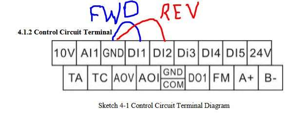

                                            My brains are frazelled by belly ache at the moment so this may not work.  Worth a try though because it’s simple.
                                            By default the CW100 comes with terminal DI1 set to ‘RUN FORWARD’ and DI2 set to ‘RUN REVERSE’.
                                            frev
                                            With the unit turned on (usual precautions), try connecting terminal DI1 to GND, my blue link above.  Fingers crossed, the motor should run forward.
                                            And similarly, connecting DI2 to GND, my red link, should run the motor in reverse.
                                            If it works these terminals are the starting point for designing a practical control circuit.

                                              Simple, possibly Ok, or simply disastrous, without clarifying at what stage in the set up the OP is at.
                                              The MFIs will only operate in the way you describe if the control input function parameter has been correctly set for terminal input and likewise the switching parameters are set for latching (and not 3 wire or multi frequency or whatever weird and wonderful control options may be available).
                                              You are making heroic assumptions that the CW100 is the correct manual for the unit and the OP has implemented (or attempted to implement) a pendant terminal control using latching switches.
                                              We would do well to await more information from the OP.

                                                Elf and Safety gone mad Martin!  Nothing heroic in what I’ve suggested; it’s not wild guesswork.
                                                1. John confirmed the manual that came with his VFD is identical to the CW100.  We know what we’re dealing with here.  Stay awake at the back!
                                                2. Nothing disasterous will happen if the control pins are grounded as a test.  The possibilities are listed on page 17 of the manual and it also defines all the defaults.
                                                Up to John what he decides to do with our suggestions.  I suggest mine promises progress whilst Martin’s doesn’t.  Given what we know I think Martin is excessively over cautious.

                                                  SO YOU already appear KNOW, by some mysterious means, that the parameters P0 02 and P0 03 have been set correctly by the OP for terminal control? I can assure you that merely connecting D1 or D2 to ground will have no effect on anything unless that change has been implemented and suitable terminal switching in place. Without that, your approach will result in precisely zero progress!
                                                  In the event that P0 02 03 have been configured, it is true that the D1 and D2 are set for latch control in forward and reverse, BUT how do you KNOW  that the OP wishes to use a remote terminal – remind us how exactly? Is latched switching what he wants? maybe he is trying to implement 3 wire control or something completely different.
                                                  Maybe the OP (and we don’t KNOW how the OP is operating or wishes to operate this device or what he is using it for) is attempting to run purely off the unit keypad and cant find the reverse at that point. If that is the case the M FUNC may need to be configured correctly in Parameter P7 01 (assuming the manual is the correct one).
                                                  It is, Dave,  simply to do with fully understanding all of the OP requirements to come to a useful solution rather than wild guesswork, or the firing off of random suggestions of dubious time wasting value.
