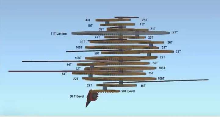

      Hi,
      I would like to have a go at making Zeamons orrery – http://zeamon.com/wordpress/?page_id=468
      The only plan he offers is a pdf file which can be downloaded from the link above. There is a 3D rendering of the item which can be manipulated to show different views and the individual components can be viewed in isolation.
      Unfortunately this isn’t of any help in actually making the orrery. Is there any way of extracting the information from the pdf file to produce orthographic views of the thing as a whole and the individual components? It wouldn’t necessarily need to contain the dimensions as I can scale these from the ODs of the gears. The problem with the 3D model is that it’s not clear that you are looking at a component absolutely square on after manipulating it.

        Alan,
        Have you viewed the series of videos which start at the bottom of the page to which your link refers?  I haven’t, just the first one.  Life’s too short!  The screenshot below, taken from that first video, should give you all the information that you require to make the gears without any need to estimate anything.  The narrator states that he used a MOD 1 gear cutter to produce the gears, and simple maths or the use of a gear calculator will give the exact dimensions of the gears.  Depthing is covered elsewhere in the video series, and the length of the support arms for individual planets and the star can be either approximated from the photo, or chosen by you.
        Orrery
        The rest is up to you.
        Edit:  That’s a lot of gear teeth to cut.  It should build up your handle-twiddling muscles, though!

          Hi John,

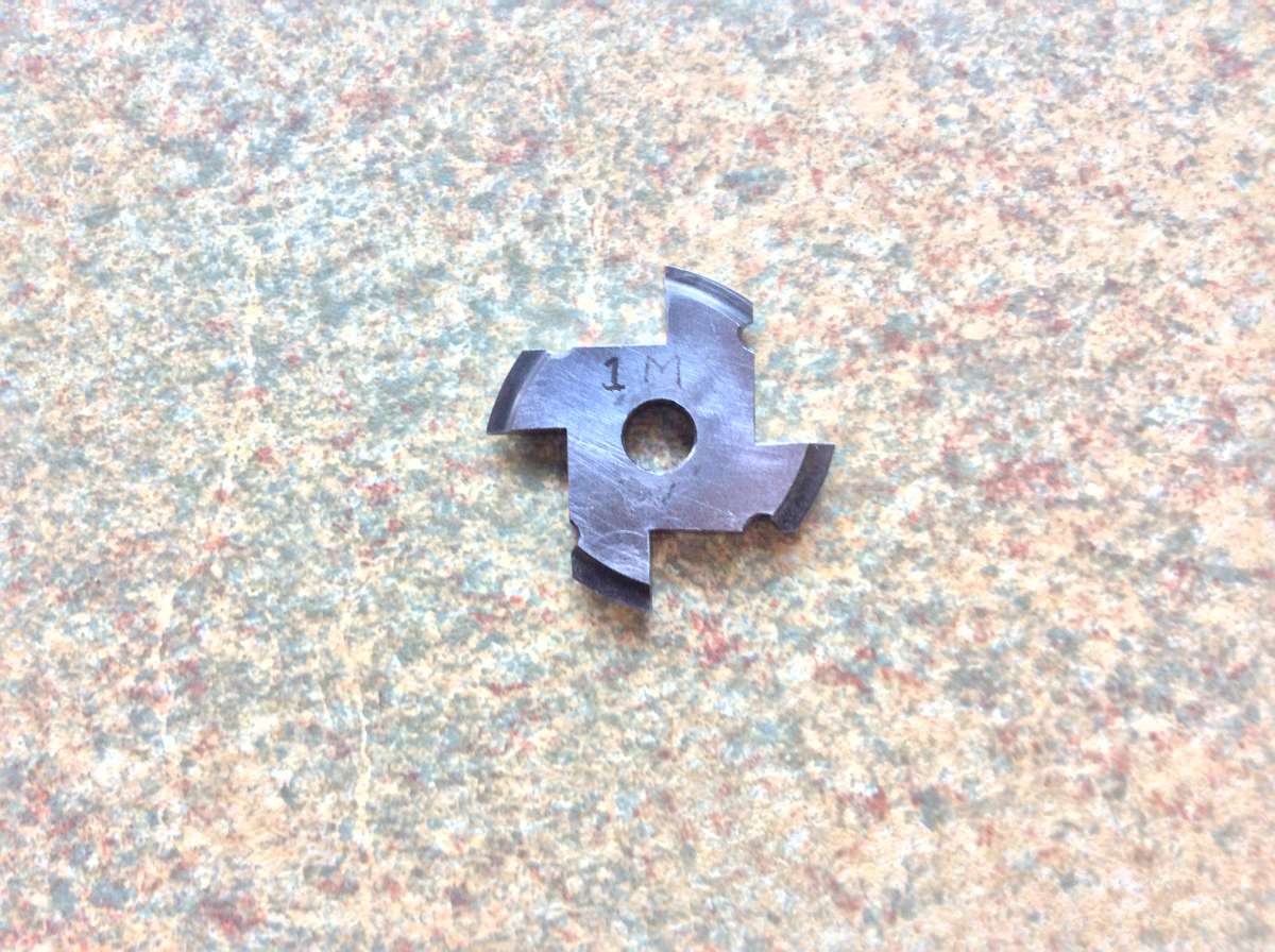

          Thanks for the reply. I was hoping to be able to convert the 3D render in the pdf to generate a set of drawings but it looks like I’m going to have to try and suss out how to proceed from the pdf file and the videos.
          One thing I’m unsure about is the gear form. I have a set of m1.0 involute gear cutters but Zeamon bought a clockmakers m1.0 cycloidal gear cutter to minimise the friction between the large number of gears in the train. These are expensive from Thorntons and I’m wondering if it will make that much difference if I use my involute cutters.
          Regards,
          Alan

          DC31k
            @dc31k
            Please read this and assess which and how strongly each of the three points apply:
            https://en.wikipedia.org/wiki/Cycloid_gear#In_clock_and_watch_making
            Make your choice accordingly.
            Pay particular attention to the depthing requirements of cycloidal meshing pairs vs. the pre-calculated centre-distance approach used by involute gears.
