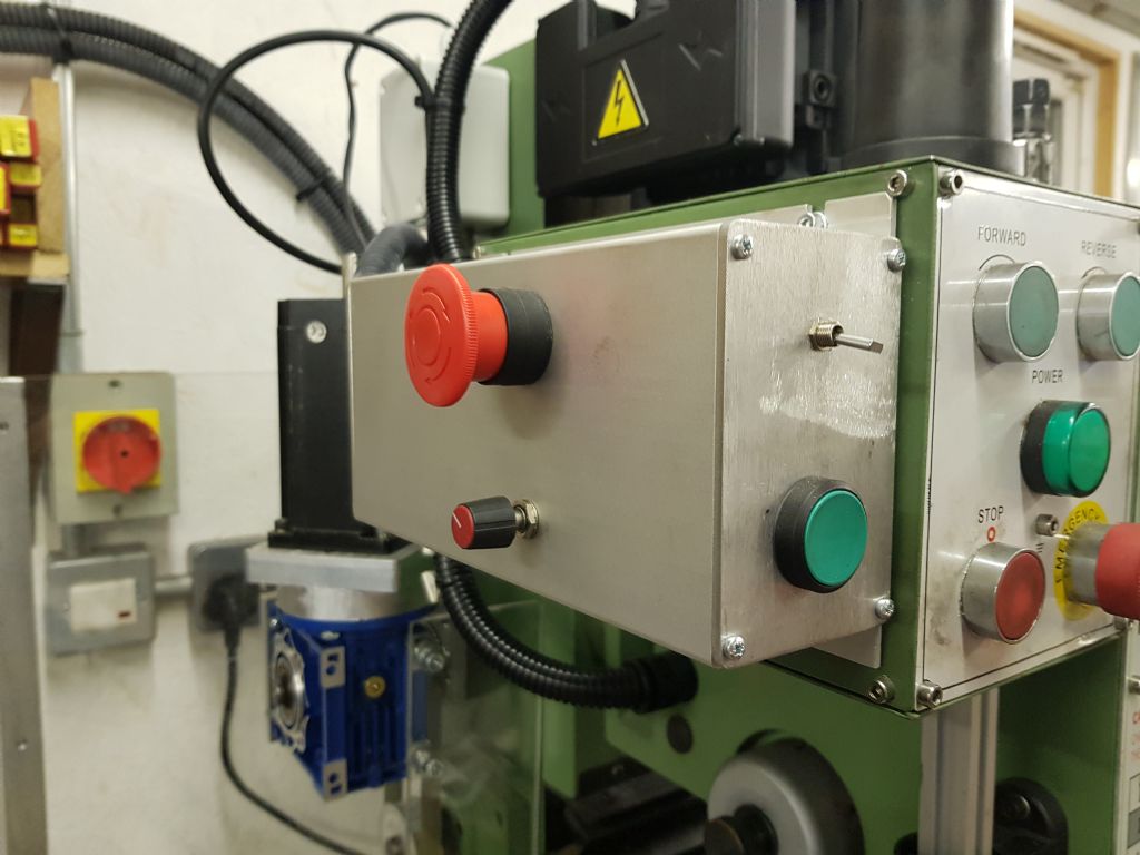

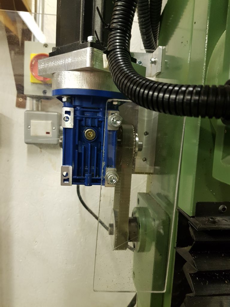

                                Ian McVickers
                                  @ianmcvickers56553
                                  I added a power raise/lower to my GH Universal by using a spare high voltage stepper drive I had left over when I scrapped my cnc build.
                                  I bought a driver control board from eBay which gives me control of the stepper driver. The switch is for raise/lower select and the non-latching push button activates the drive. The pot adds speed control and an estop for safety. The right angle gearbox came from another project and fitted this nicely and I decide on a pulley drive rather than a direct drive just in case I did something stupid.

                                  Jon
                                    @jon
                                    Nice work Ian.
                                    Downside to doing that way is horizontal work the job would have to be raised off the bed spindle to the 2nd bolt on box. Caught me out in the past with standard box, job needs raising off bed 8" + centring.
