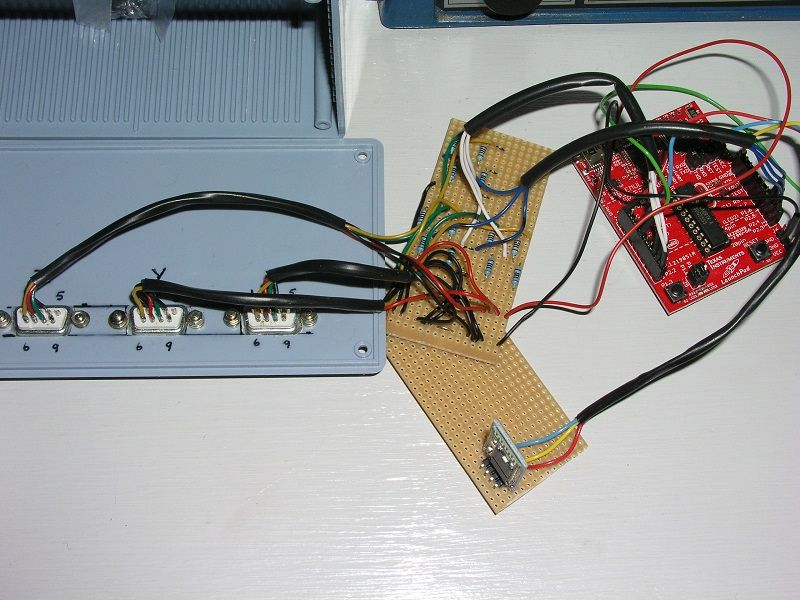

          I have built a couple of these but I am using them with the magnetic scales from Machine-DRO. My connection to the scales is via 9 pin 'D' connectors (computer serial ports).
          Colin

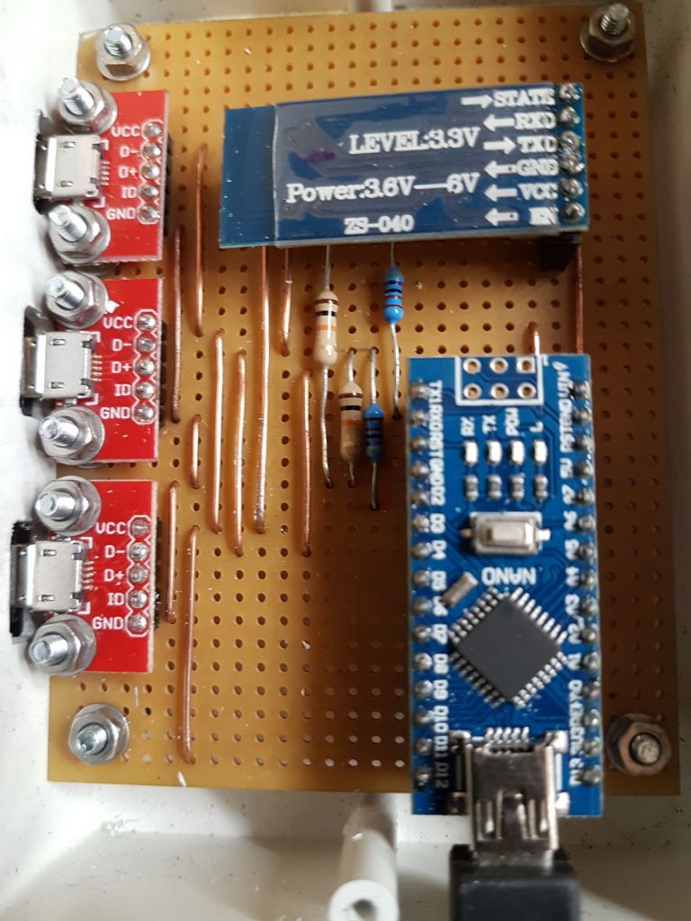

              I have built one recently for my Warco milling machine.
              I used these from ARC :
              **LINK**
              I made the circuit on veroboard using an Arduino nano , an HC05 Bluetooth module and 3 micro usb breakout boards.
              Stuart

                These are the breakout boards I used:
                **LINK**
                this is the Bluetooth module:
                **LINK**
                and this is the Arduino nano:
                **LINK**
                Stuart

                    Apologies all. I got it slightly wrong. The scales I have are the digital readout bars from Arc which are of course, capacitive not magnetic blush. According to Yuriy's site, they are just debadged IGaging scales.
                    USB headers are the female sockets that solder onto a circuit board to accept a male USB plug. Normally called breakout boards. I need Micro-B sockets to suit the plugs on the scales.
                    My question is, the DIY board from Yuriy only has 4 holes to solder on the breakout boards for each of the X,Y,Z axis USB connectors, yet the breakout boards I can find for sale in the UK have 5 connections as shown by the ones used by Stuart S 5 in his link above.
                    So how do I connect the two together? Whilst I'll openly admit to not being an electronic expert, even a spanner monkey like me can see the difference laugh

                        I built mine using perfboard and an ATtiny85 (an 8 pin microcontroller) as seen here, which also shows a much reduced schematic.
                        I used Igaging scales from Taylor Toolworks, a US ebay supplier, that even after shipping, taxes, etc was still cheaper than any UK supplier, and the cheapest Android tablet I could find.
                        The scales, while they use USB cables are not USB compatible, they use a +ve, -ve, clock and data for pins 1-4, the first 3 can be joined together across all axes to common pins, then you just need the data pin from each axis to go to a separate pin on your microcontroller.
                        A real USB connection uses +ve, D+, D-, -ve for pins 1-4, the 5th connection is for the ID which is floating in the case of a B device, or tied to ground for an A device. As mentioned above, the scales do not use true USB and even mess with where +ve and -ve are connected.
                        It is also worth changing the cables for shielded ones as the original ones can cause resets if they see EMI spikes from motors or similar – I had this happen quite often while I was still using the original readouts.
                        Be aware that the scales may also need to be calibrated, and while you can use a feedback calculation based on a reading and distance measures, the correct cpi value for Igaging scales is 2560 – found on the Schumatec OpenDRO website (the default cpi value in TouchDRO is 10,000 which is way too high).

                            The boards I used do have 5 connections. The one labelled ID is not used. Although the scales use a micron usb connector the pins are not used as the usb spec.
                            VCC : power supply to scales (3 volts for mine)
                            D- : Clock signal from micro to scales
                            D+ : Data signal from scales to micro
                            Gnd : Ground connection to micro / power supply
                            If you want to buy a complete board, the touch dro website has them:
                            **LINK**
                            But at $86 + $30 postage they cost too much for me!
                            I think I mine cost me less than £25. Not quite as professional looking but it works ok.

                              the 5th wire is connected to 0V to act like a normal 4wire USB but is left high to act as a host – this is the OTG extension – there is a description in Linux Magazine May 2020 (issue 234 – should still be in shops) but our local Google-Fu zen master might be able to find a better explanation – the Mag article was about its use in the very cheap Raspberry Pi Zero

                                Mine cost under £5.00 half of which was for the bluetooth module, and could have cost £0.87 less if I had used a 5V supply or a couple of extra resistors for a voltage divider from my free 7V wallwart supply instead of a buck converter.

                                    I used the Texas Instruments circuit boards and used a piece of Veroboard to make up t. he voltage divider part of the circuit. I had not touched electronics for over 40 years, but amazingly it all worked. I think the whole box of electronics came out at well under £20. I had some bits like the serial connectors in my IT stock. I drew out the resister layout on paper first, then drew it out on a veroboard layout before attempting to solder to veroboard.
                                    Colin
