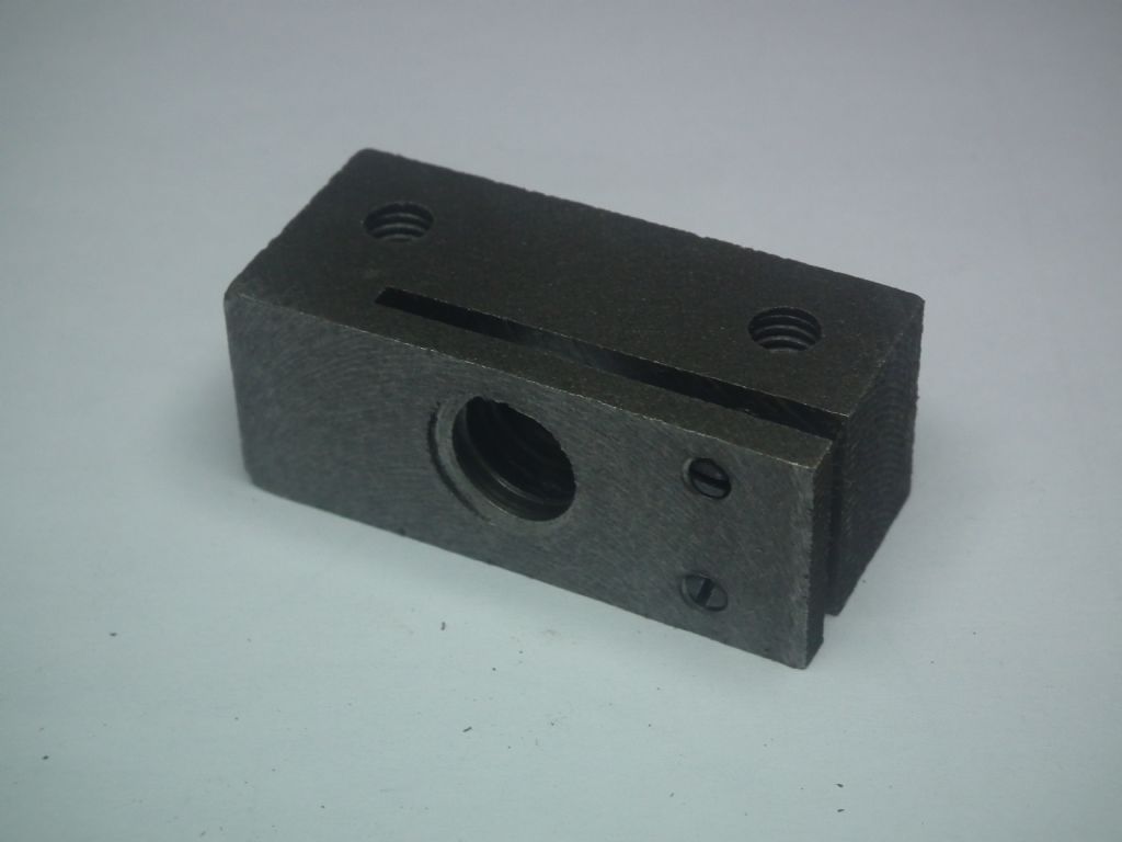

                                              Russell Eberhardt
                                                @russelleberhardt48058
                                                This is one of the leadscrew nuts I removed from my SX2P mill when I fitted Delrin nuts:
                                                It already had the split to take up backlash. Your bronze/brass nuts are a different design but a similar splitting should help. What holds them in place? From your picture it looks as if they are not firmly fixed in the slot.
                                                I wouldn't fit ballscrews to a manual machine as the reduced friction allows the table to drive the leadscrew so it won't stay where it's put under cutting load.
                                                John, I tried that method of making Delrin nuts but ended up with such a mess that I gave up and bought an acme tap and did the job properly.
                                                Fitting DROs doesn't help backlash but it certainly makes life easier. I wouldn't be without them on my manual mill.

                                                  Jim Baxter
                                                    @jimbaxter34386
                                                    Thanks for the pic of the nut – I think I'll try cutting a slot and grub screws to it tonight since it's something I can easily do.
                                                    No, the brass nuts are not properly held solidly in place by any sort of decent method.
                                                    They are basically held in a vague suspended position by virtue of being screwed onto the lead screw. They have grub screws (1 on the Y and 2 on the X) which then push them against the surface behind them, and this sort of pins them in place but it seems like a quick & dirty means of doing so.
                                                    Plus depending on the sag or whatever of the lead screw as you tighten the grub screw, it will affect how the lead screw aligns (since nothing else supports it along its length) and thus will affect the feel of the handle etc. All seems a bit random & shoddy to me, but I'm worse than a rank amateur so take that opinion with a huge spoonfull of ignorance!
                                                    As mentioned, I'm surprised that there's no bracket & bearing at the 'far' end of the x & y lead screws to support them and add to smoothness presumably with the handwheels operation.
                                                    Definitely going to look at getting myself a set of budget DROs now anyway. Thanks for the comments on these, and direction toward pics etc. Very useful ta.
