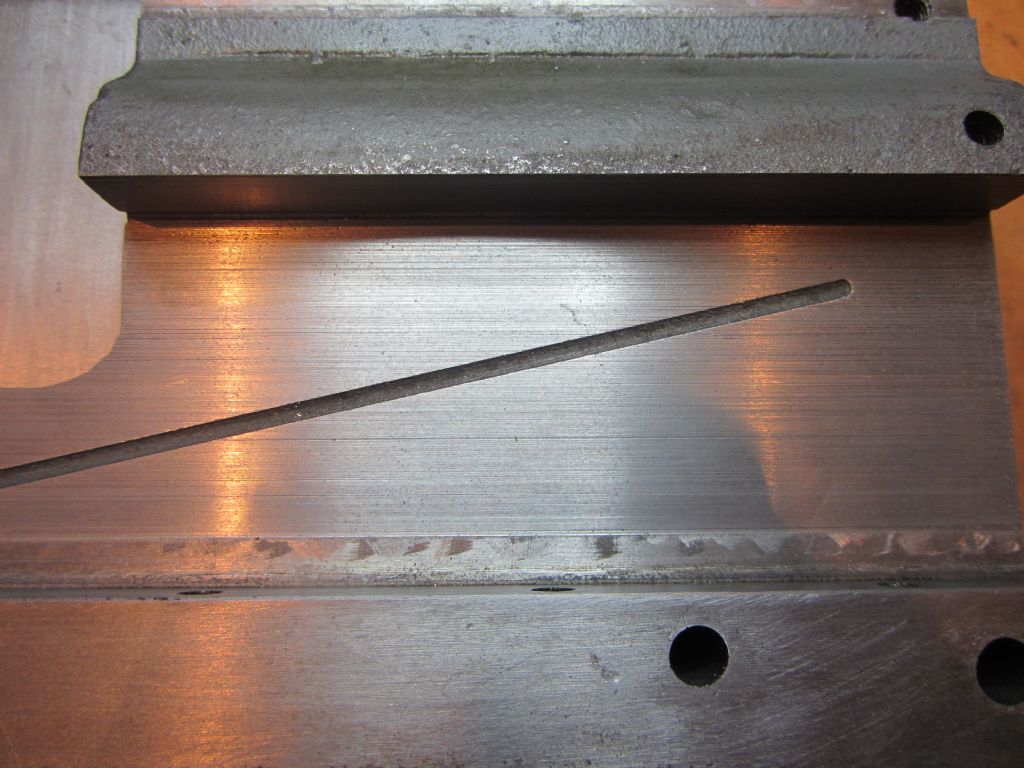

                                                  Attached is a photo of the underside of the saddle.
                                                  I have measured the wear and it does not seems as bad as i first thought but there is a definate step on the shear face.
                                                  Having spoken with Brian Caddy, and understanding my own limitations i think i will ask Brian to clean this up on the grinder, if it only take 3 or 4 thou to clean up the shear then this i think will be ok for me.
                                                  Would have thought it might be worth while shortening the front gib to the same size as the centre, seems pointless have the extra as this just aids the twist..

                                                    The longer gib must provide some support, Myford designed it that way – it just needs careful set up so that it does not skew the saddle. A facing test will confirm the correct setting – and or checking for equal gaps either side of the saddle at the rear.
                                                    Good luck with getting you machine back together again.
