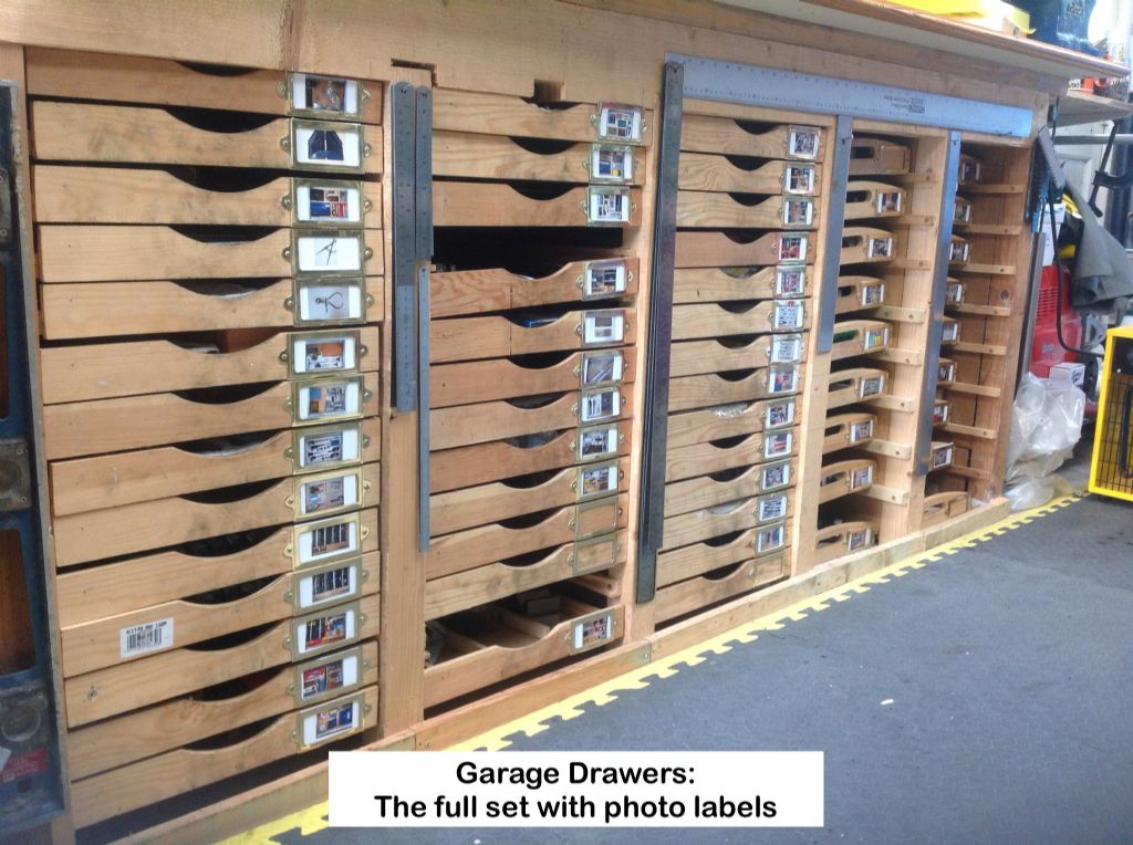

          My solution.
          Garage Drawers
          Garage Drawers
          Geoff – Used to spend half the time searching before.

            OuBallie,
            nice job, ruddy marvellous……..and to think that all that saw dust as a useful by product…….always needed for the leaky old cars…!!!!!!!!!!!!……
            just sold all my Wadkin gear, house is finished and just can't afford the room…….
            what wood machines have u got ?…….any ideas on a small'ish spindle moulder, longish tables, be nice if they were cast iron…..been looking but nothing takes my fancy yet…..I do miss my 1ton Wadkin…..

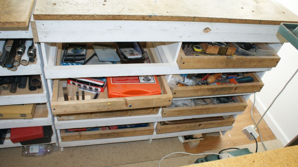

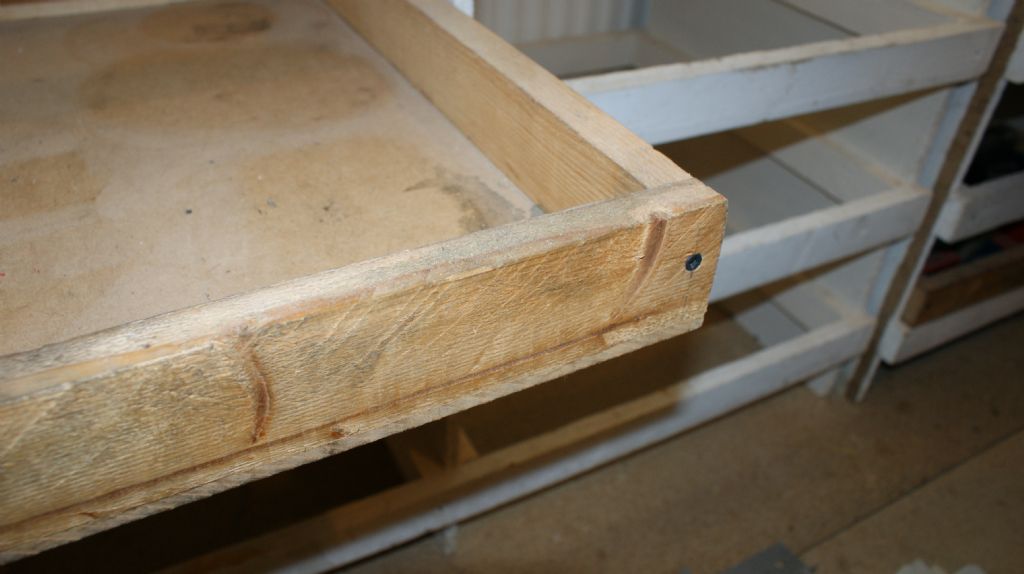

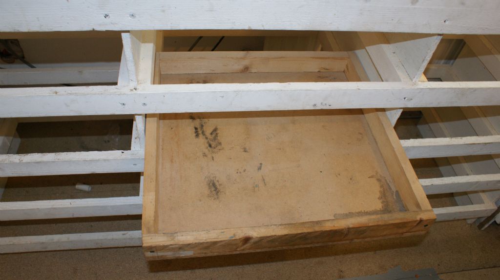

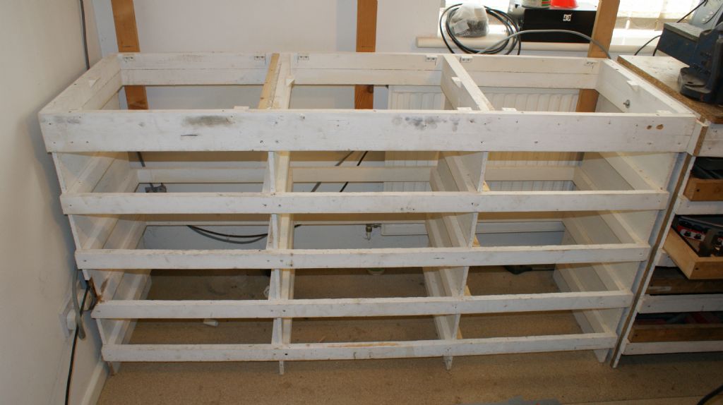

                Here is a solution that worked for me some years ago. It is cheap, and requires minimal carpentry skills (I've moved on a bit since). The drawer bottoms have held up well with minimal sagging. The system provided quick and easy access to the drawer contents.
                Here is the frame. The upright sheets are 15mm chipboard. The frame is made from 2×1 sawn, so no precision there!
                Here are the drawers. The drawers are made from 2×1 sawn, which are joined together by butt joints, a screw, and some glue. The drawers are around 500mm square. The drawer bottoms are 6mm mdf, screwed to the drawer sides. The drawers (trays?) just slide on 2×1 sawn.
                Here it is in use.
                Steve

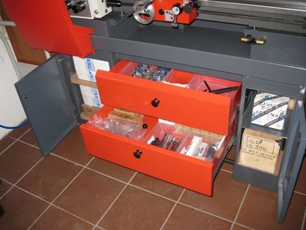

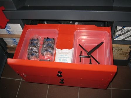

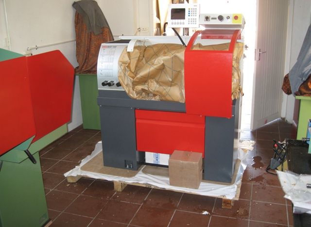

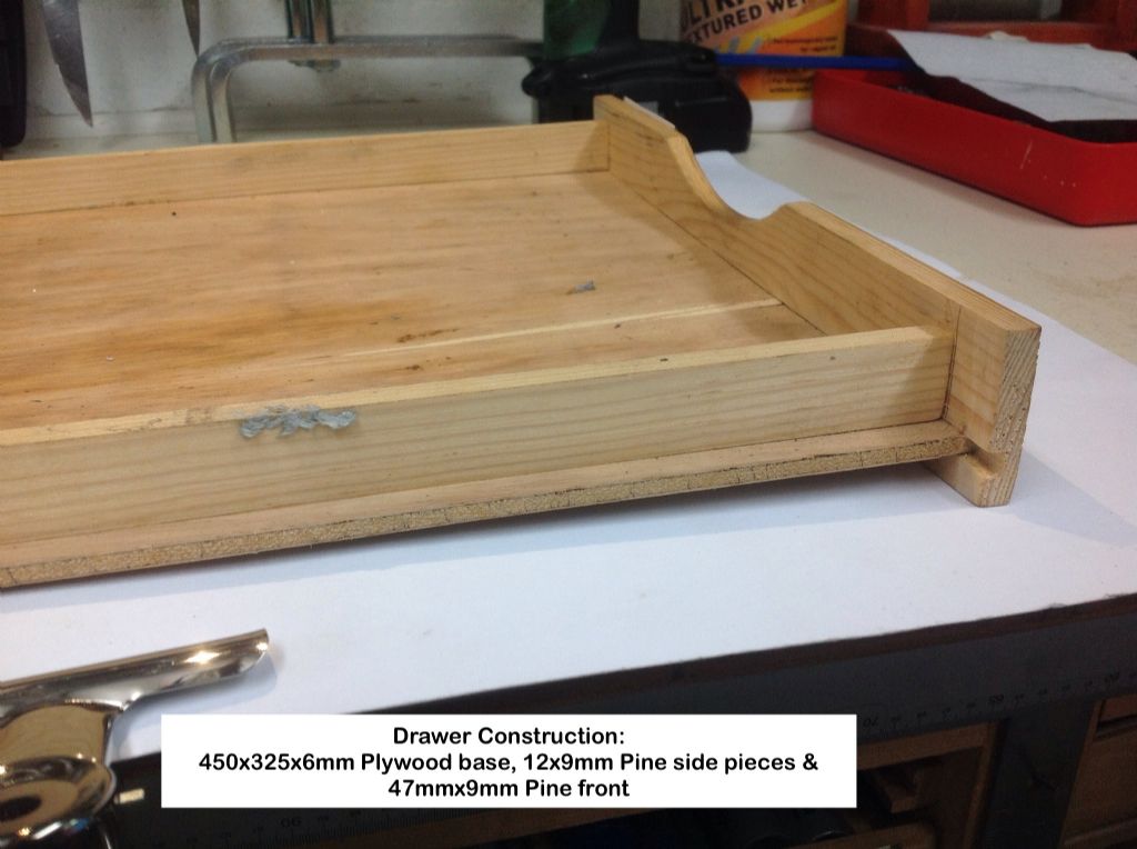

                      Referring to my post on making from 2mm aluminium sheet – I made some drawers for the cabinet of my EMCO 14D lathe – they have lots of unused space/volume in the cabinet, and placing often used tooling close at hand is alway good..
                      It is a neat way of making drawers, easy to size, do not take up structural space, sturdy, etc. And no Brown Dust..
                      The cabinet was also modified on the left and right to create cupboards..
                      Photo of original without drawers etc..
                      Added drawers and cupboard doors – the front panels of the cabinet left and right were cut out with a plasma cutter and shelves added, then the doors.
