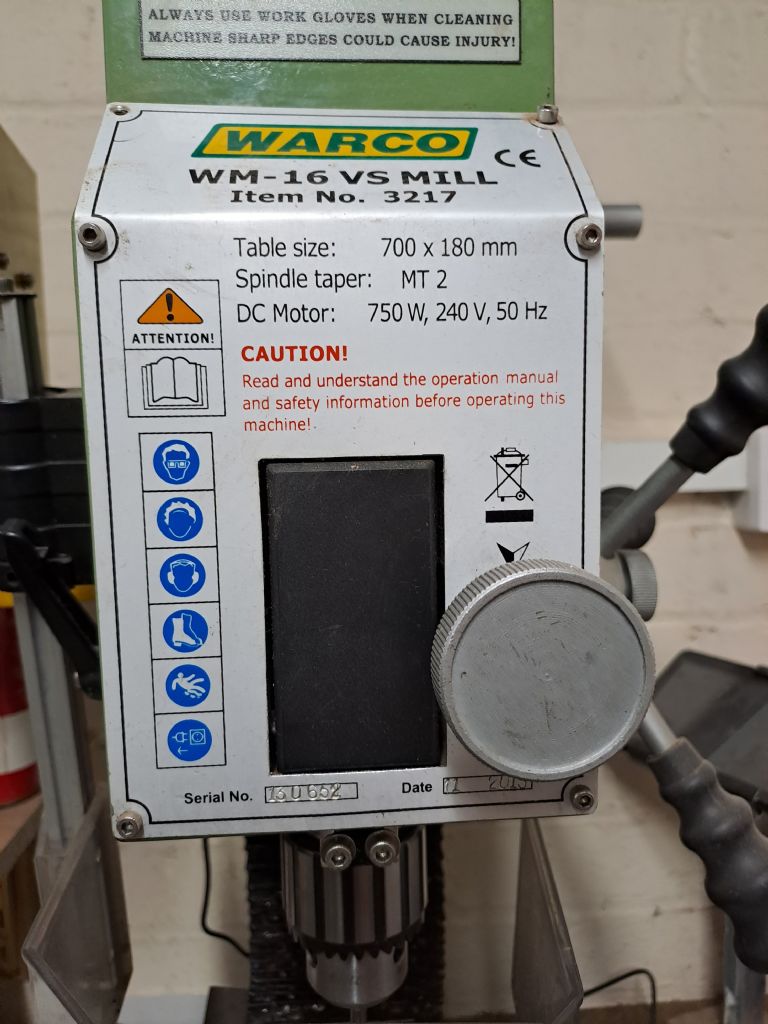

      Replacing the WM-14 Quill DRO
      #645987
      Matt McKenzie
        @mattmckenzie43876
        Has anyone replaced the WM14 Quill DRO with something that can plug into a display? I find the LCD display quite hard to read.
        There is a Youtube video of such a thing with another milling machine and the poster managed to sum the Quill DRO with the Z axis which seems to be an excellent idea.
        So, one needs to find a 100mm encoder and reader that will sort of fit into the space available and produce an output compatible with that from the glass encoders I had fitted on the machine…
        Matt

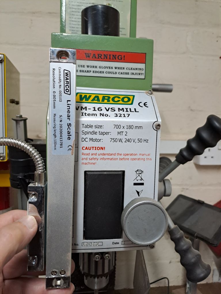

                Stuart Smith 5
                  @stuartsmith5
                  Matt
                  I don't think you will get an optical type scale that will fit in the space available.
                  I have a WM16 and fitted this type from Arceurotrade (I had already fitted them to the X & Y axiis):
                  **LINK**
                  I used the 150mm one and cut it to fit.. The display that comes with them is no better than the one already fitted to the mill, but you can mount it in a better place.
                  I actually replaced the displays with an Android tablet using the TouchDRO app (https://www.touchdro.com/) and a homemade interface circuit.
                  Photos are in my album 'Mill DRO'.
                  If you want an optical scale to match an existing DRO system, I have taken a couple of photos of the smallest one that Warco do (100mm travel). You could make up some brackets to mount it in front of the existing readout.
                  Stuart

                  #646146
                    I would think about a magnetic strip and small read head. The strip could be fitted to a flat bar replacing the existing one that the mill uses and the head fitted to where the existing display fixes.

                      #646150
                      Matt McKenzie
                        @mattmckenzie43876
                        Yes. That looks good. Part of the project is to integrate it with the ' Z axis display. I guess that would work if it didn't flap about being only held at one end.
