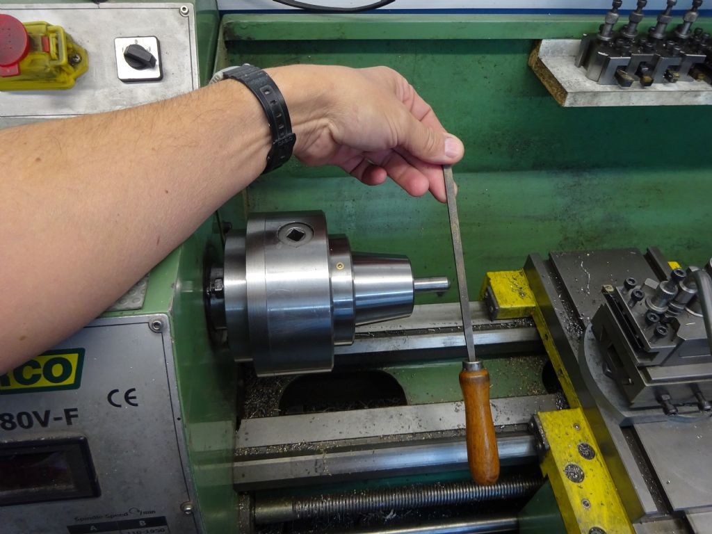

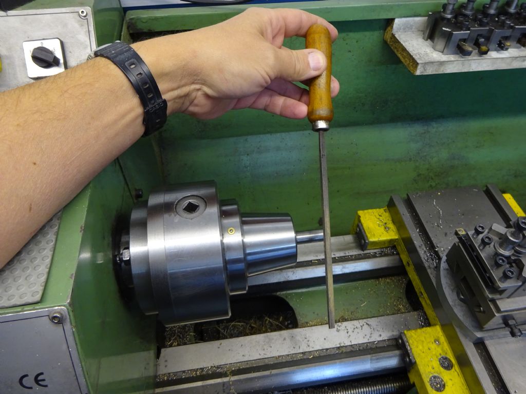

        Left arm on the headstock if you must rest it somewhere.
        I use a pillar file with handle the right way round, saves having to stop lathe and reverse direction.
        Normal lathe rotation, right hand would also be on handle cut can't hold camera as well.
        Reverse lathe roration and reversed file, right hand would be holding tip of file. If anything did catch the file would be thrown away from you.
        Edited By JasonB on 02/09/2015 08:08:35

            I don't rest my arm on anything. I file much the same as I would on a bench with work in a vice but the angling of my left arm does need to be different at times on a lathe. I suspect I file like this because my 1st job at work was this 4in cube of steel that some months later finished up as a 1.6900" perfect cube, all via a a large 2nd cut file. Draw filling not allowed. The files are bent so that they flatten when the pressure is high enough for them to work efficiently. It's a dice. The spots being applied with a drill in vernier scribed boxes to show if they are positioned within 0.001". Character building including the blisters.
            My unpleasant experience was at work cleaning up arc welding on a right angled part. Something that does need care as there is a part of the work which can catch and push the file with some force. Like many accidents down to stupidity really. Should I have been using a needle file – maybe if it had a handle but something with a more substantial handle would be better. The file happened to be in my top pocket so I just used it rather than fetching another. A number of them were done without any problem then ………………

              My lathe is too big for me to hold a file, as shown by JasonB in the second picture, without my shirt touching the collet chuck. thumbs down Anyway, I'm left handed, so when using the file with normal lathe rotation neither of my hands are over rotating bits.
              Andrew
