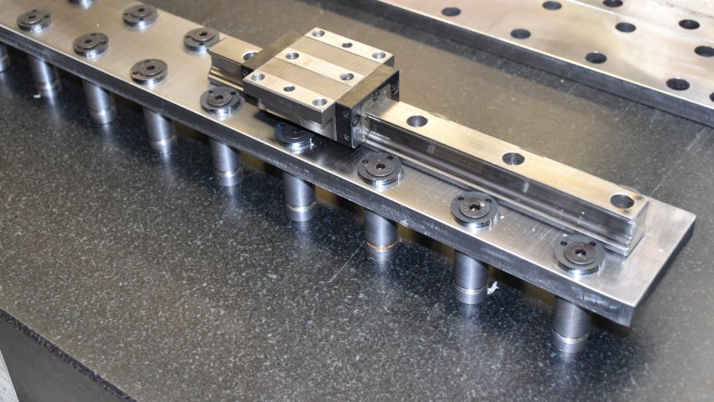

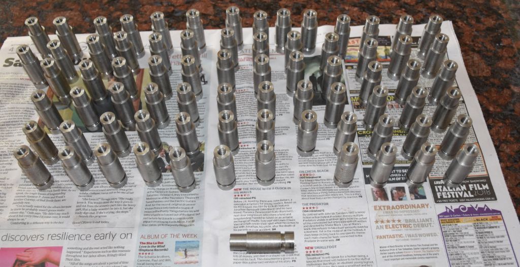

                              I am working on a new CNC Mill made from Mineral castings, (10-12% Epoxy and Graded aggregate).
                              It requires about 250 steel inserts of various types.
                              Many are tapped M6 and M8. I broke an M8 tap today, annoying, I don't break taps very often. The material is the problem it appears to have hard spots. Because of the number I used the lathe to power tap the thread, it has clutch reverse so reversing out is not a problem. Had I not already machined the inserts I would have used leaded steel. It was too late for that. A 30mm thread is required for design reasons not strength so I decided to ream the holes out to 7mm yes this oversize for M8 it should be 6.7mm. The result was no more broken taps and clean threads.
                              I will do a write up of the mill separately
                              Regards
                              Rail mount to be cast in place. Note cams to position rail prior to drilling. They will also be left in position.
                              Edited By John McNamara on 26/09/2018 16:17:09
