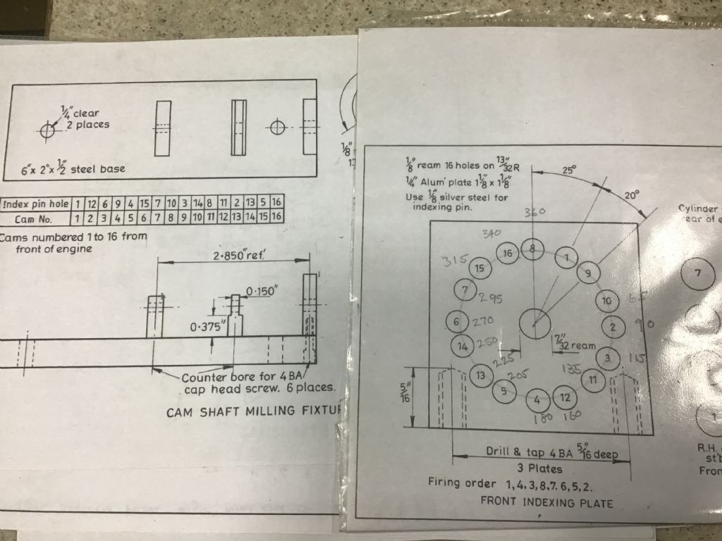

      ce6ce1da-ea52-45b9-8c33-8b3b86819bc0.jpegI’m at the stage of preparing to make the camshaft, but need to make the machining fixture and a travelling steady, Iv had the casting for 20 years…. Here’s the problem
      The photo shows the drawings. Whittle does not fully explain in his notes about the fixture. (Me July 95 #82) The indexing wheel is fixed to the back of the camshaft , his photos of machining it show this at the right on the Miller. However the drawing states only the “ front indexing plate” so is this a view on the END of the fixture OR the view from the Front of the engine/camshaft. I think it’s the former but if I am wrong the engine will run backwards or not at all
      Any guidance from anybody who has actually got the engine running would be much appreciated.

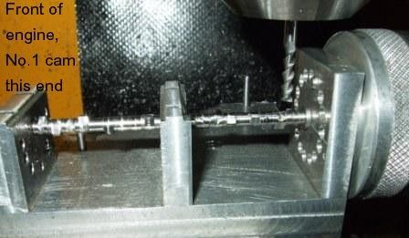

            See note on my picture, cannot confirm this is correct though.
            Edited By Emgee on 23/07/2021 14:19:16

            Zan
              @zan
              Thanks emgee. Your shaft looks good! Indexing on both ends of the jig?
              I joined the group and asked in there as well but still hoping for an answer in here

              Emgee
                @emgee
                Zan
                The 3 plates were clamped as one when drilled and reamed to make sure the bearing bores were aligned, all indexing was done at the front as detailed by Eric in the write-up.

                Zan
                  @zan
                  Emgee
                  So the drawing shows the right end of the jig calling it the front , not the front of the engine which is on the left in your photo with the drawing face outwards on the right, not facing the front of the engine ( actually at the back of the engine!)
                  #555516
                  Emgee
                    @emgee
                    Zan
                    Perhaps someone on the iO group will clarify the details.
                    The reason behind my note on the picture is that the gear driving pin is held in the indexing end and as the gear is at the rear of the engine No.1 cylinder is at the prop end so must be as shown.
                    Emgee
