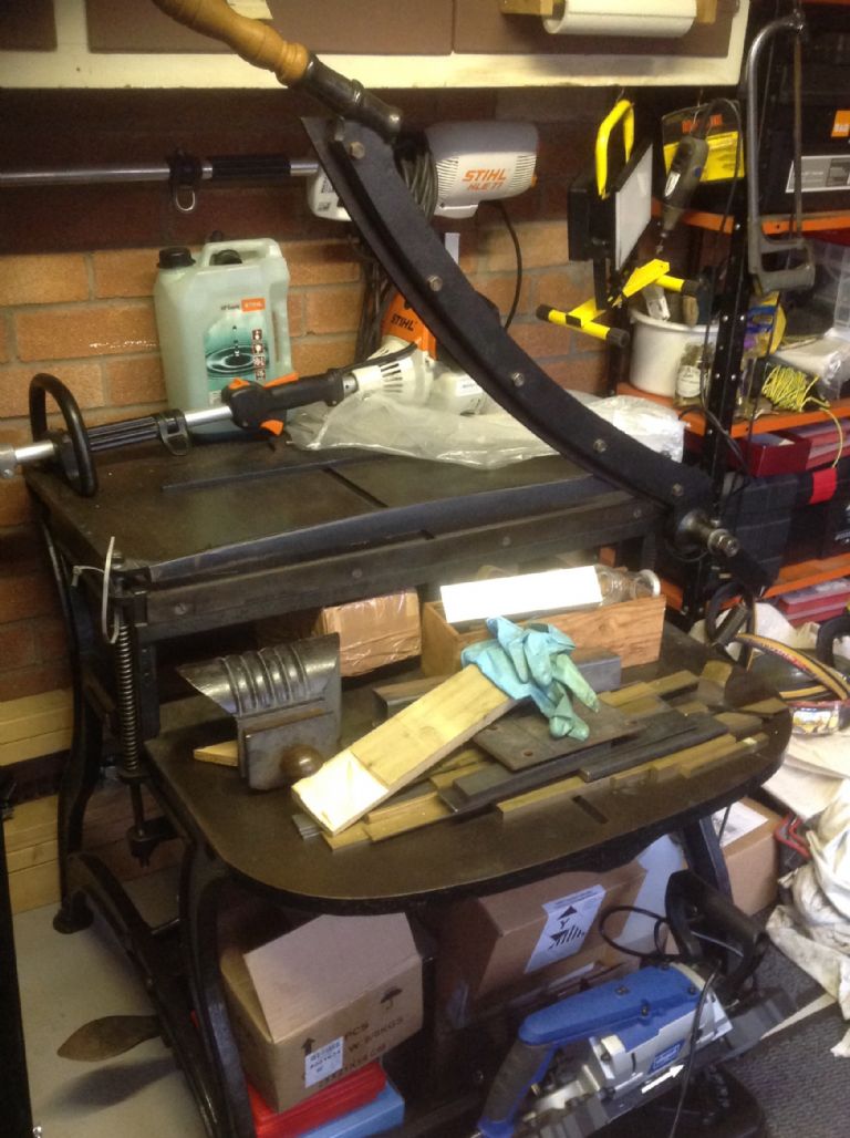

                                      Yes, Swann Morton 10A for card and paper.
                                      I don't use much greyboard these days, but do use the much denser [and archival] millboard.
                                      Since I can't realistically cut either type of board by hand, I use the Victorian boardcutter in the photo for doing so.
                                      Its blade cuts with a shearing action, so thankfully it has a very different profile from the crazily sharp edge a guillotine blade has to have.

                                        John Smith 47
                                          @johnsmith47
                                          @Bill Phinn – out of interest when you cut thin strips of board, does the Victorian Board Cutter (/guillotine?) put a curl into the board that has been cut off to do they recover and lie completely flat after having?
                                          Also where do you get your "mill board" from?

                                            Bill Phinn
                                              @billphinn90025
                                              Posted by John Smith 47 on 27/04/2021 20:23:06:
                                              I don't often need to cut narrow/thin strips, but if I do then yes, I would expect a certain amount of curling of the strip, even if the grain direction of the board is parallel, as it ordinarily should be, with the long edge of the piece being cut; if the grain direction is at 90 degrees to the cut, the curling will be much more pronounced.
                                              The curling can, however, be reversed quite effectively if the strip is very lightly damped and placed under a weight between pressing boards until it's completely dry.
                                              One of the best features of the boardcutter, apart from the fact that it will cut through the full width of a 3mm sheet of millboard in one pass, is the foot operated clamp, which guarantees the board will not move while the considerable cutting force of the blade is doing its work.
                                              I buy my millboard [branded Gemini] from John Purcell Paper.
