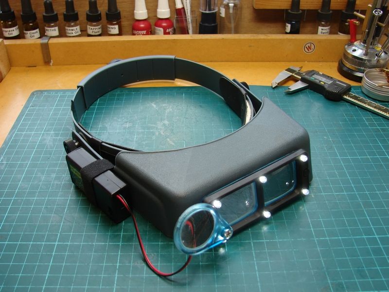

                                    I am a clockmaker and i have a Optivisor with no5 lens for bench close to work and a number no4 lens for working on the lathe or milling machine.
                                    On my close to Optivisor I have the new Quasar LS light fitted which is brilliant
                                        Works well with my varifocal glasses, and the LEDs are too bright to look at so they shed a lot of light
