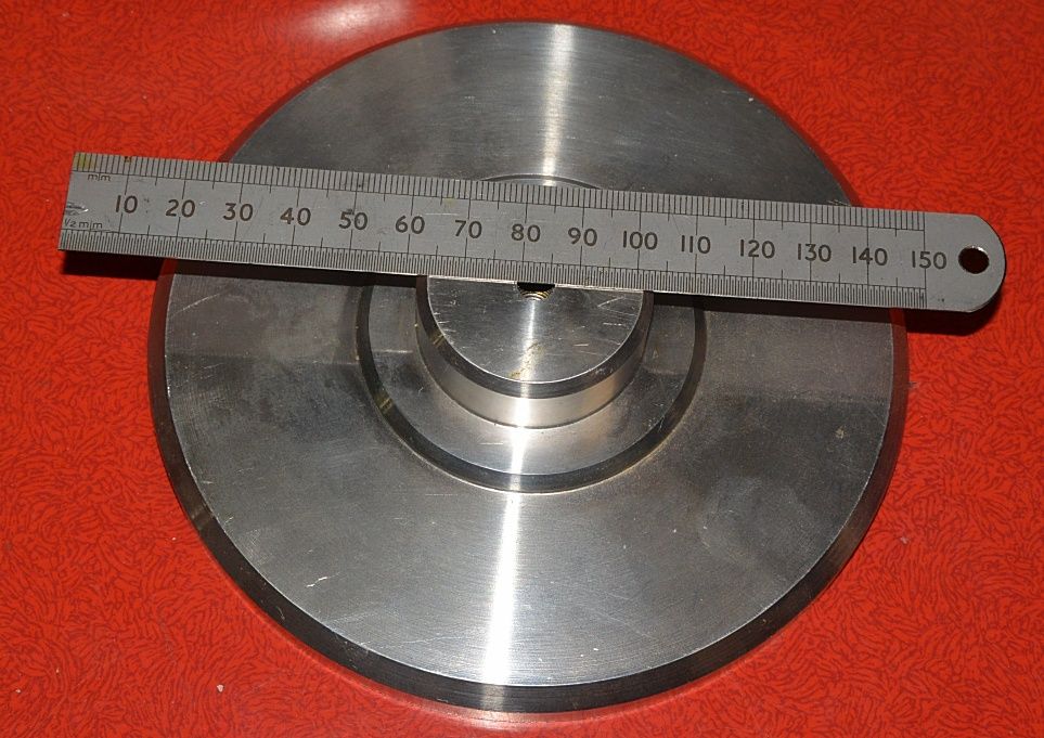

                              Brian, would not worry too much about the face plate, you can at a later date make your own, just as I made a back plate when I bought a smaller 4 jaw chuck for my lathe (orginal chucks 8", new one 6&quot. I got a lump of hot rolled steel, 9" dia x 2" thick, and carved it out of that. The hardest part of the job was carrying the bit of steel home, it was "bl****" heavy, it came from scrap from a profile cutting shop.

                                As said, it's easy enough to make a suitable face plate. A possible source of supply is to modify a face plate intended for a wood turning lathe. These are commonly available at reasonable prices.

                                  You may find the spindle nose is the same as another make of lathe and you can just buy a faceplate for that lathe. They do all seem to be based on each other.
