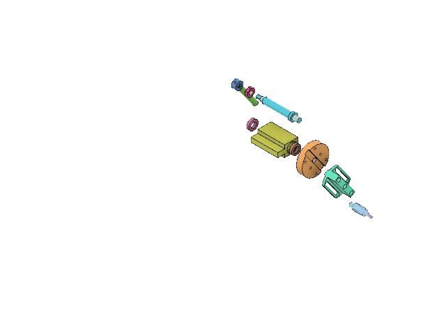

                          I made a Bedair one that works OK, better with the 5C chuck I now have as you don't need so much stock sticking out to avoid hitting a chuck. I just made it to suit the my ctr height
                          Edited By JasonB on 29/10/2020 10:06:44

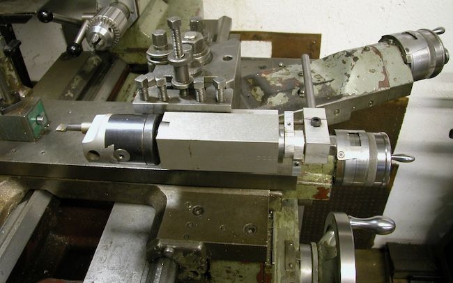

                                  Clive Foster
                                    @clivefoster55965
                                    This is my boring head on R8 shank version set-up in the Dickson T2 tool post on the Smart & Brown 1024 (10" swing) lathe. Made from materials I had in stock.
                                    As you can see anything smaller runs out of room to mount in the tool post or directly on the top slide. If you are going to have to pull the topside off to mount directly on the cross slide its a lot of extra work compared too a Bedair type for little objective return. Especially if you can figure out a calibration system for the Bedair version.
                                    Need to use a T2T type carrier with the deeper slot as that gives enough room to pull the boring head back alongside the slot. Afterthought in my case so the mounting tongue isn't quite the right size and position for simple push into place mounting. I need a thin shim underneath and should use a spacer at the back. One day I'll screw a bit on the back.
                                    Few details are a bit rough but it works.
                                    If making one with its own dedicated plain shaft then a basic block about half the tool carrier length will be fine.
                                    Adjustable stops to control the swing are advisable. But something of a pest to make attractive. I just knocked the ruff edges off and called it good!
                                    I wonder where I hid that Hemingway kit last time I tidied up (sort of) the shop.
                                    Clive
                                    Edited By Clive Foster on 29/10/2020 12:11:14

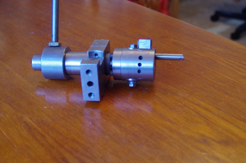

                                    #504084
                                    Nick Wheeler
                                      @nickwheeler
                                      I bought the Hemingway kit just after getting the mill, and made a mess of everything I did.
                                      This repurposed the shaft and shaft holder, plus a couple of other bits including the tool:
                                      The head and slide are from 60mm bar, the slot is 10mm wide. Shaft rotates on cheap bearings, and is screwed and loctited to the head.
                                      It's only ever likely to be used for decorative balls(gear knobs, handles etc) so I saw no need to complicate it with an adjuster mechanism

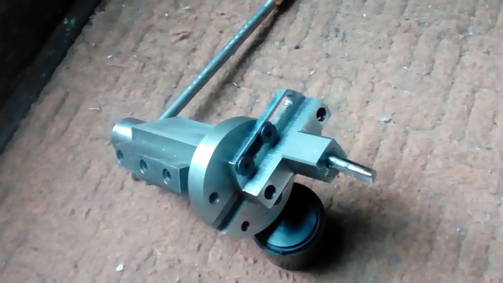

                                              john halfpenny
                                                @johnhalfpenny52803
                                                My scrap material20201029_154137.jpg Bedair variation. Like Jason, made to suit centre height. The screw head sits in a cross slide tee slot.
