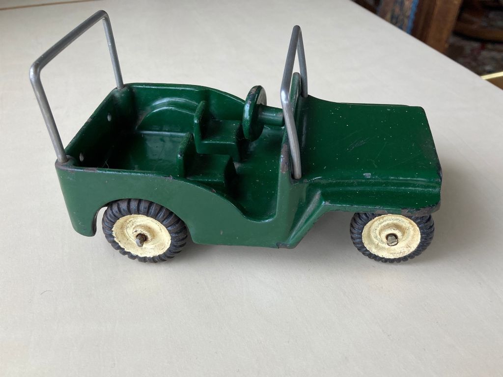

                      Don’t want to hijack the thread but thought this may be of interest? My Dad brought it home after demob at the end of WW2 (1946) it was made/cast by the chap who’s family he was billeted with in Holland at some point. I repainted it for my son about 45 years ago and re-made the “roof” bars the canvas top has since gone missing, wife made that!
                      more pics in my “miscellaneous pics” file if your interested

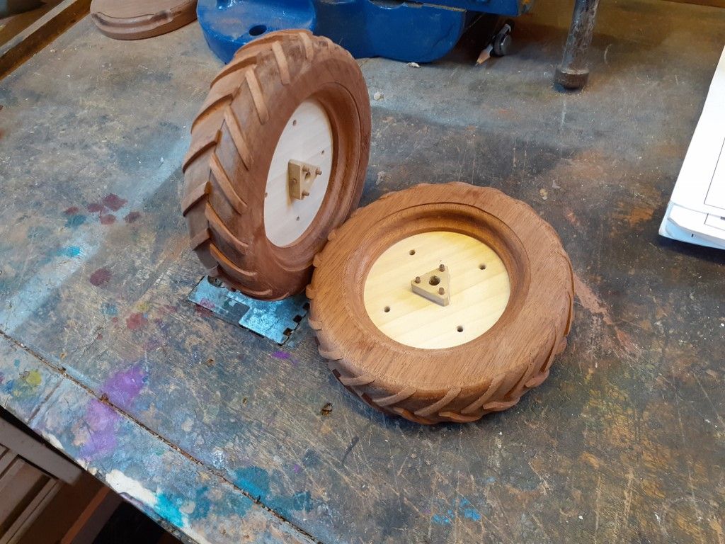

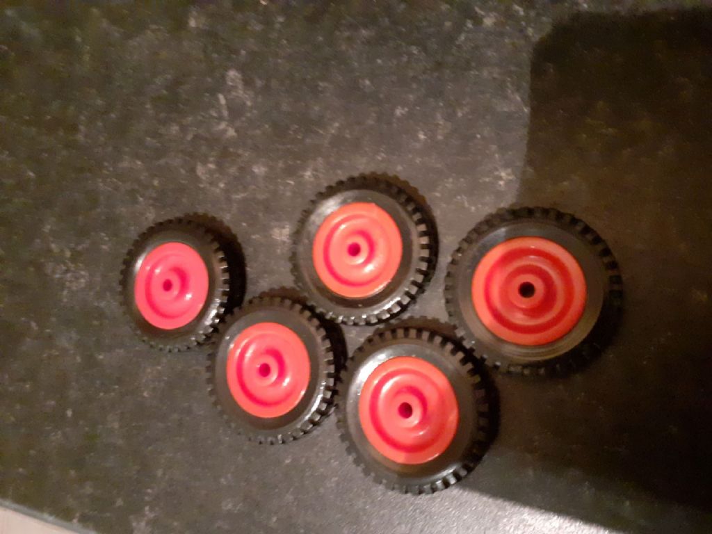

                                  I imagine that something like these are not suitable they are 1 7/8" diameter.
                                  I have also made wheels from wood as these for a tractor(Photo pre fitting as one wheel is the wrong way around which was a simple fix" could also make them for use as a pattern to suit the Jeep
