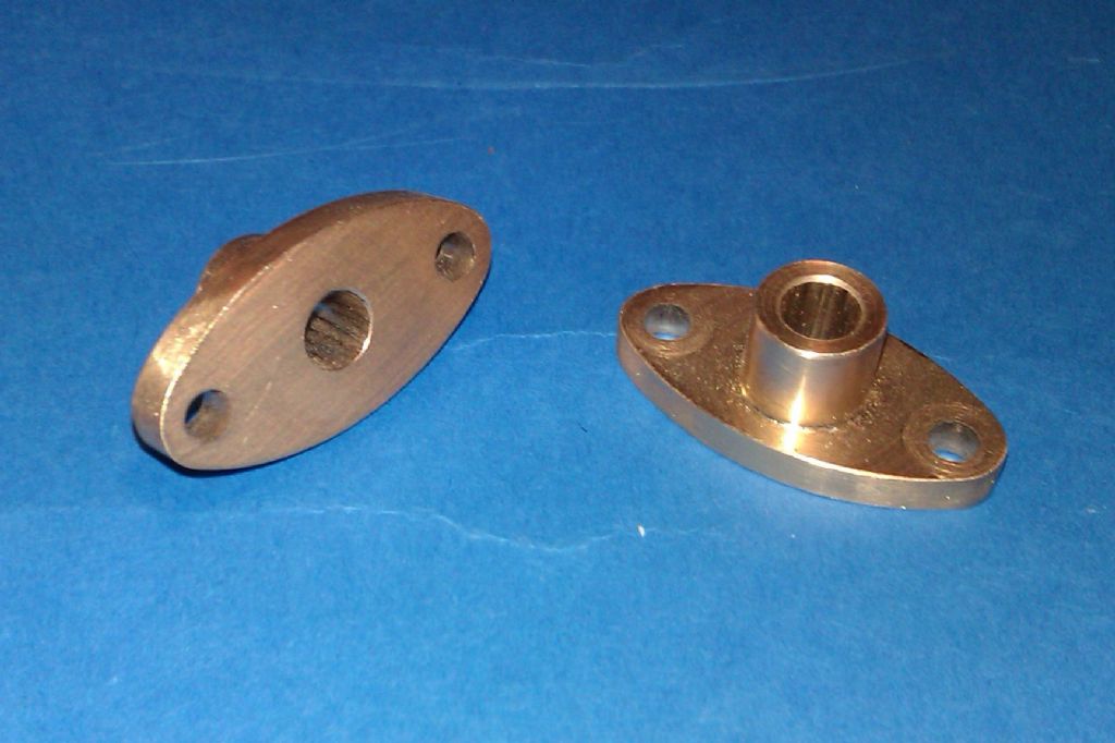

          Well I've only made a pair of glands with mine so thats 1" down and another 35" to go!!

                Very neat piece of work! I take it you made them in one piece, so no soldering will be necessary. How did you get the splendid elliptical shape so neatly, CNC?

                  It maybe just the light, but it looks to me like they have been soldered ????

                    They are one piece, the spigot was turned one the lathe and the hole bored & reamed at the same setting. Part off a little overlength then hold by the spigot to finish the parted face.
                    Then into the mill to drill the holes. The two larger curves of the "elipse" were done with a boring head set to cut with the tool the opposite way round and the ends were just done with good old filing buttons.
                    This is not my photo but should give you an idea of how its done, mine being smaller were just held by the spigot rather than the jig shown. You can also use a similar method by having the gland mounted on the end of a rod in the lathe, either hace teh rod the dia of the curve and use the 3-jaw or a smaller rod offset in the 4-jaw.
